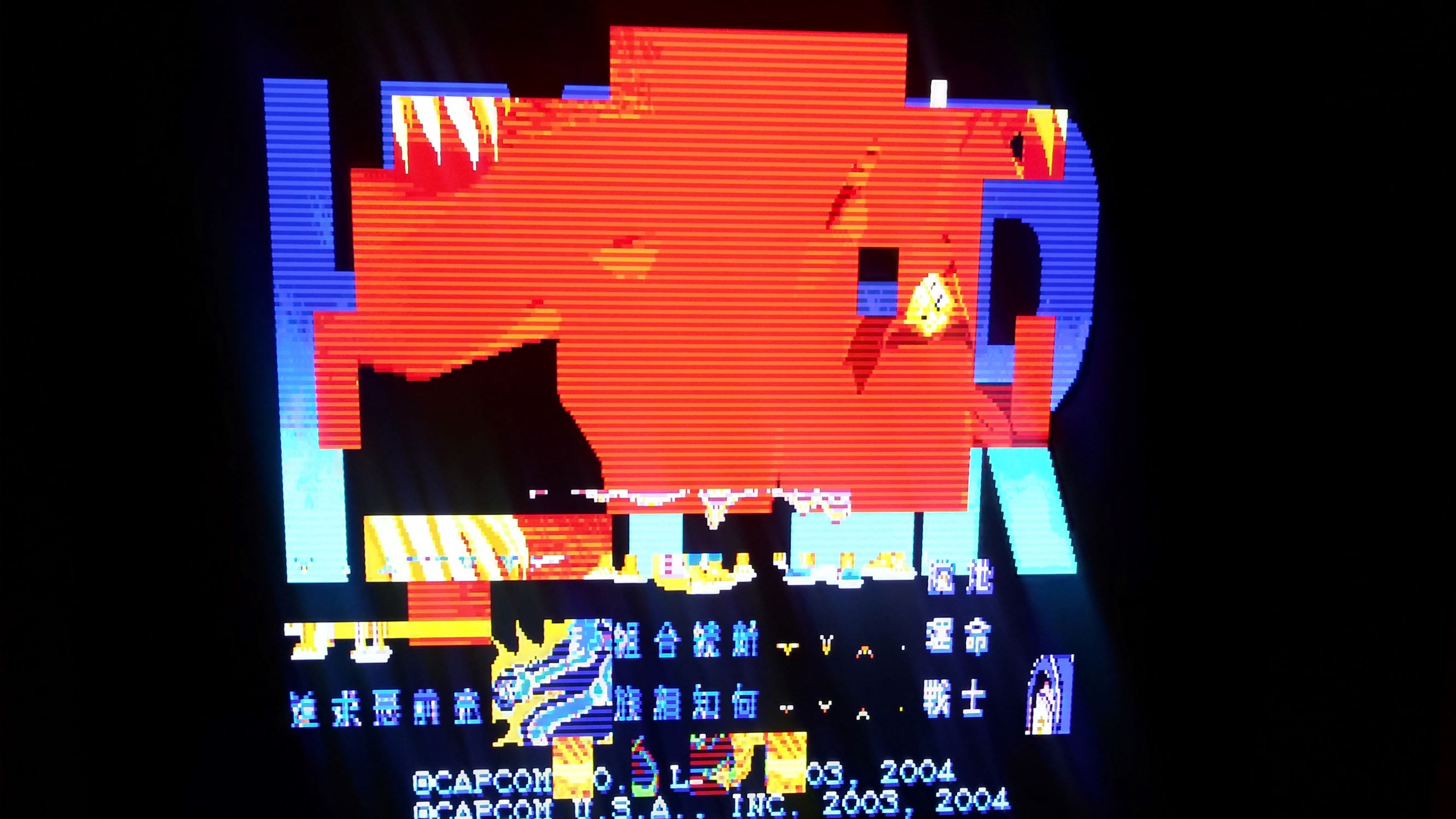

okay, I've got a new CPS2 multi kit, this time for me.
Running on a revision 4 board with a G Pal, patch wire running underneath the board per the setup video Mitsu posted.
No key writing wires have been soldered yet.
However, I'm getting garbled graphics and sound regardless of what game I try to run, encrypted or not.
Pictured is the opening of MVC Unlocked.
I've also run the test roms with no issue, aside from the screen afterwards just being blocks
I've tested on 2 different A boards with no change and reseated everything 3X.
Any clues what the issue could be?
