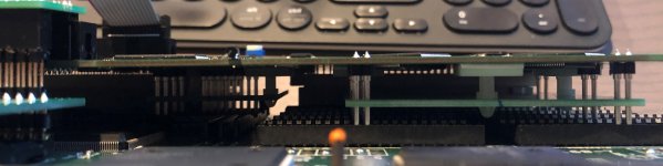

Update: You guys were all correct! However it was the pin and darksoft board connection C32 pin that was bent.
for future reference, check pins above the board as well.

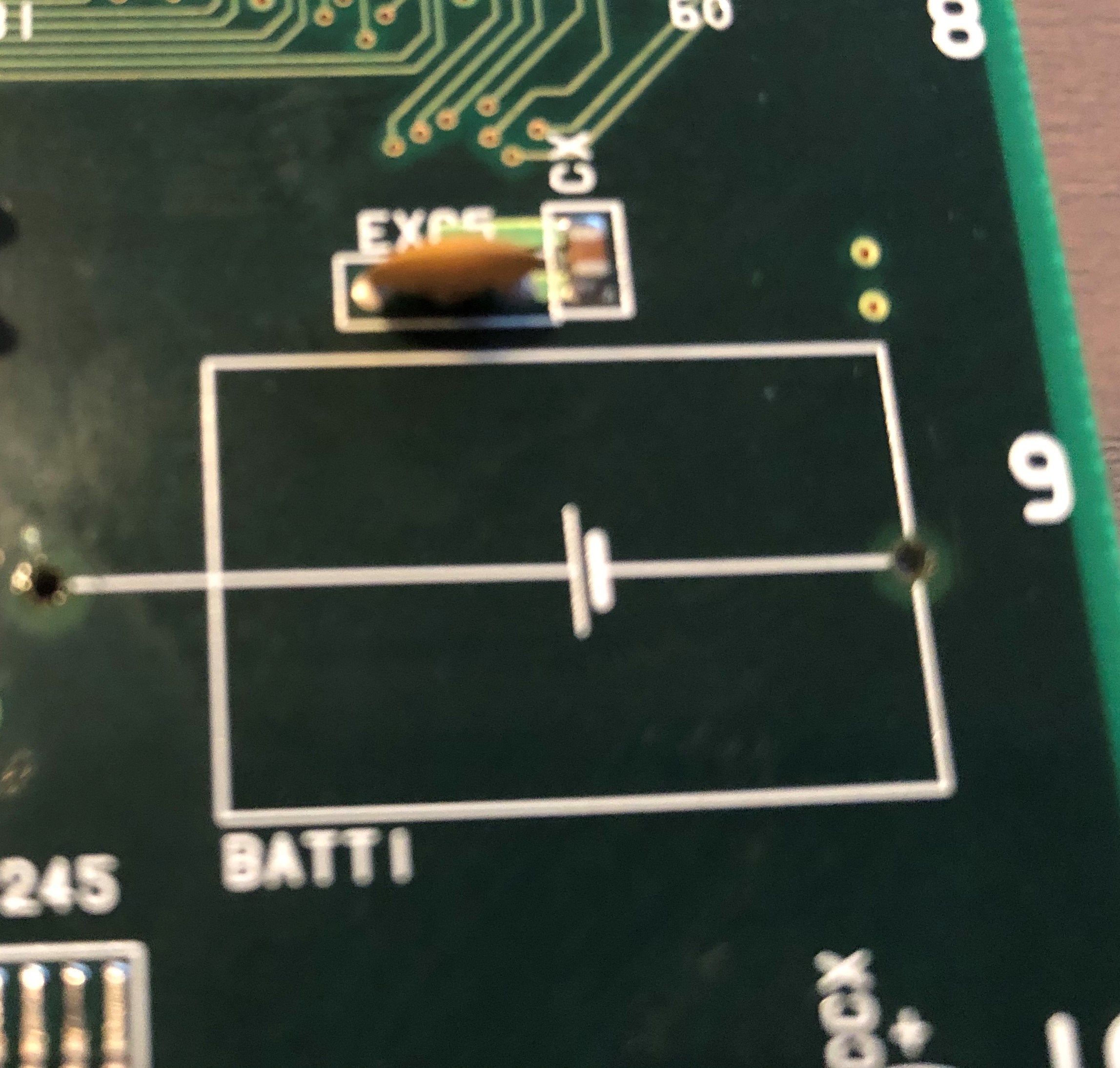

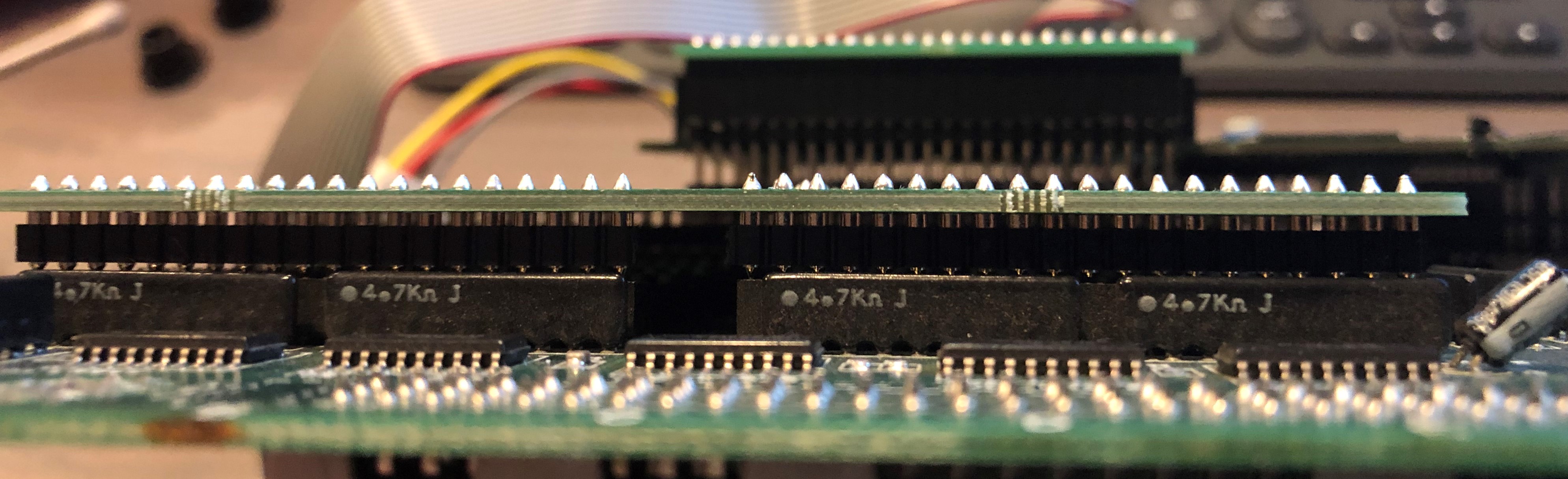

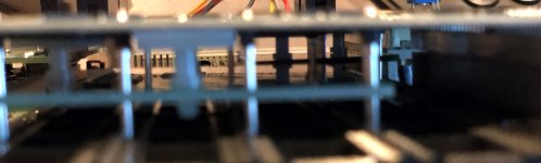

Hey Guys,
Just got my CPS2 Multi, and installed and I'm stuck on a black screen. Boots up green, load a game, goes to black then nothing. I started with working A and B boards and I removed the battery and all of the socketed chips. The B board is a MSH vs SF revision 7 and had a PAL G installed on it.
  • Discharged EXC5 as well as CCI.
  • Installed key writing wires and used the encrypted rom set from arcade projects roll up pack.
  • Checked multiple times that key writing wires installed correctly.
  • Removed the key writing wires (pads look good and intact), tried decrypted rom set.
  • Checked all pins on kit, none bent, all making solid contact with board below.
  • Checked multiple times to make sure interconnect board installed correctly. (RU symbol toward the left or JAMMA connection).
  • Removed and reseated the kit several times.
  • Tried 3 different SD cards formatted FAT32 and copying all files in one action using Windows 10 machine.
  • Re-installed firmware on kit.
Attached are some pics, any help would be greatly appreciated.

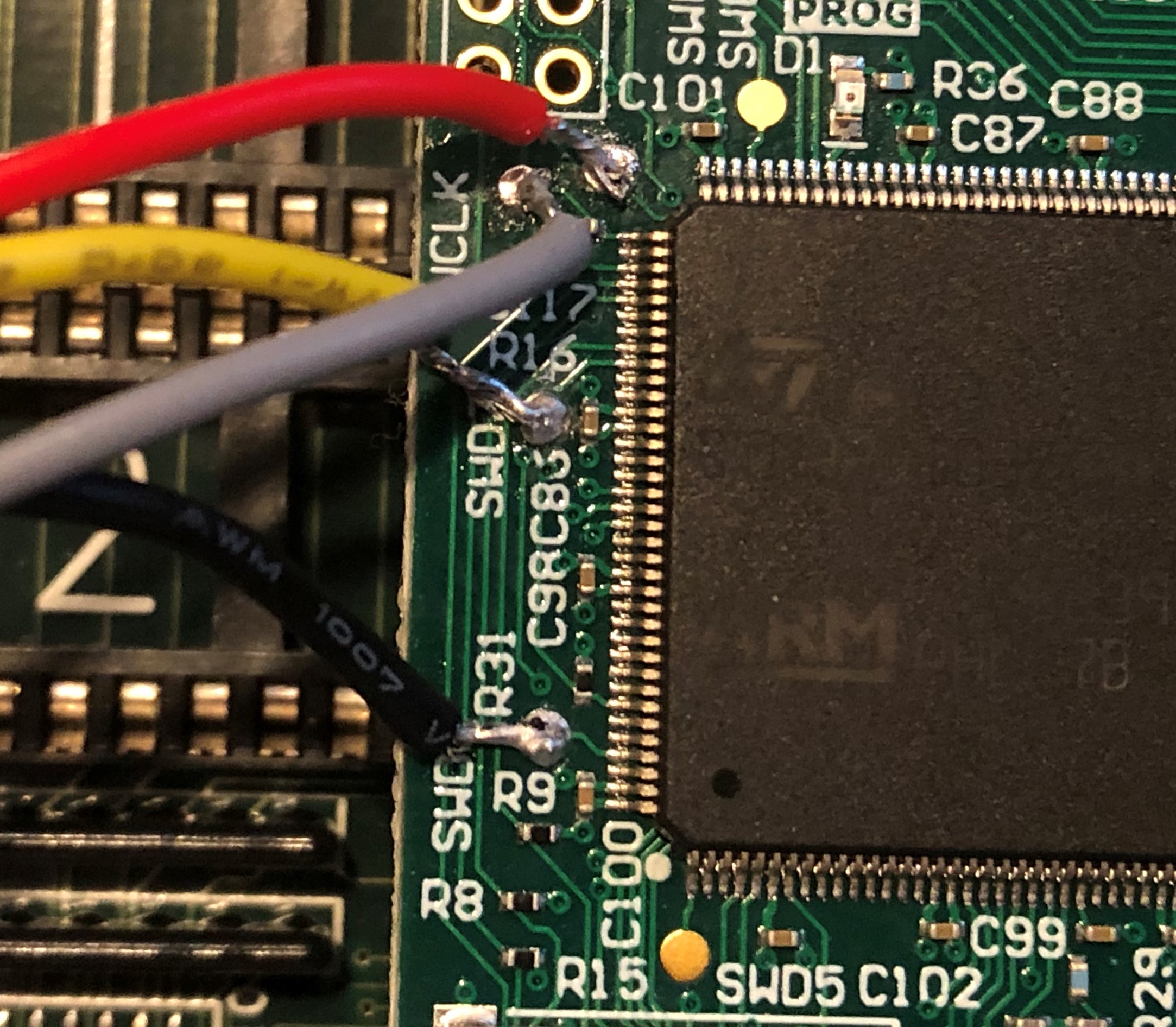

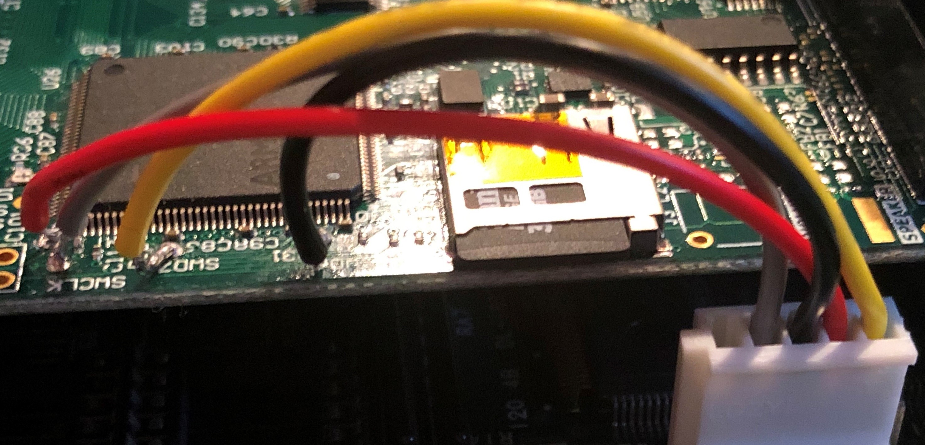

Hi Anthony,
those wires don't look very neat in my opinion. There may be some undesired solder contact there.
First of all, please unplug the 4 wires that go to the b Board and try loading a game that works without battery. There are many of them. Just to be sure, the KEY file in the directory of the game must be full of 0xFFFFFFF
If that doesnt work, then make sure that the join between both boards of the kit is properly sitting and in the right direction. Test with a meter.
If none of this works, I'd suggest that you sent to @Mitsurugi-w so he can have a look.

Hey @Darksoft
The wires were worse the first time, didn't have any solid wire, only stranded. Tried to come down onto the pads as to not hit any of the resisters surrounding the pads.
If I just unplug from C9 is that enough to test decrypted roms or do I need to remove the wires as well?
As for the key file with all 0XFFFFFF, I'm assuming that's the same as the NoBattery.key on the site.
I ran the test roms 10101010 and 01010101 and its seemed to work fine. Not sure what I am to expect with what's displayed on the monitor but the LCD said its all good. Sometimes the monitor is all black sometimes it goes to green.
Also, where should I put the probes from my multimeter to check connections between the boards? Am I just looking for continuity.
Sorry for all the NOOB questions but I'm a bit new at all this. Just finished navigating and getting through a Naomi CF setup/memory card compatibility etc the last month. I thought this was going to be a cakewalk compared to what I was dealing with on that. lol
That should be enough, if still doesnt work, then remove the cables, they may be doing a short. Also inspect for solder blobs that may have follen during the installation process.
Yes, but has to be named "key" and be 20 bytes in size.
Exactly that.
No worries. We've all been learners.
@Darksoft
We have success!
Troubleshooting Steps:
  • Tested continuity across the board with a Multimeter
    • Every Pin was connecting between the Multi and my B-Board properly.
  • Unplugged the C9 cable, tested with decrypted ROMs and ensured the key files were correct
    • Green Screen
  • Removed the key wiring and retested with decrypted ROMs
    • Green Screen
Now I'm thinking I damaged my A board when I replaced the fan
  • Tested on another good A board
    • Green Screen
So then I move to the B-Board, this was working fine before I ripped the battery out.
  • Put all the original ROMs back on, installed an Infinikey
    • When I first booted it I saw a few garbled sprites but then to a green screen
  • In frustration I put pressure on the interconnects between the A & B board while turning it on
    • Successful Boot
Tested a few more times and if there was no pressure it wouldn't boot consistently.
  • So then I put on the retention clips
    • Successful Boot
So back to the Multi...
  • Removed my original ROMs again, removed the Infinikey, reinstalled the Multi with a decrypted rom set (put on the retention clips)
    • Successful Boot but upon switching games It wouldn't reset automatically. I needed to shut it down manually and reboot to change games.
  • Then I put it back on the bench, soldered the key writing wires, changed the ROMs on my SD
    • Successful Boot and changes games seamlessly.
  • Removed the required post on B Board cover, reinstalled cover
    • Successful Boot but garbled audio
  • Removed the black clip on top of the LCD Connector, reinstalled cover
    • Successful Booting constantly
So the moral of this long winded story, even if everything seems fully connected but its still not working. Put the cover on your B board, the screws and posts pressure the connectors to fully extrude through the casing more than you just pushing down firmly. And then put those retention clips on the A & B board to make sure they are connected together as tight as possible.
