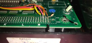

Do these key writing wires look good enough? Not the cleanest, but they don't move or anything.
Not the tidiest solder job. But I don't see any shorts. Never the less, you should check for shorts with an Ohmmeter before firing it up.

I think I will try to re-solder the key writing wires. Any advice? 200-250 C on the iron, tin the wires first, add fresh solder to the contacts, then tin the iron too? I'll try to keep the exposed leads short and attach them so the wires all go up like they do in the picture in the instructions.
I edited my post above about the resistor. Remove one side of it to make sure the key can be erased.
As for your key wires just add Flux and touch them up a bit. Flux is the stuff of Gods.

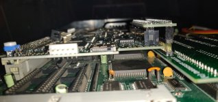

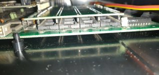

Broken pins on multi kit
I don't see any. The big board appears to be pushed down as far as it can go, and I think I got the smaller board in far enough. Pictures of both attached.
Interconnect board not installed the correct way
Up arrow is facing up, and I pushed the big board in from the bottom, appears to be a snug connection. See pictures.
Key writing wires are not installed correctly
I re-did the red wire, it doesn't look great but I think it's okay. Tested continuity between each pin and the surrounding pins and didn't find anything, continuity between the pins and the harness ends all checked out. Nothing appears to be touching. The order should be correct (see pictures). I initially tried with the resistor connected, then disconnected it when the first attempts didn't work. Solid green each time.

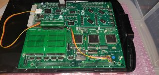

I cleaned up the keywires and soldering (thanks to @ekorz and @dos for the soldering and wire stripping advice). I shorted EXC5 again and adjusted the LCD cable. The first game I tried loading just booted to a bright green screen, but the second booted to this green-looking Work RAM OK screen. I tried pushing all the boards in a bit more and turned up the contrast pot again, then Eco Fighters booted right away when I plugged it back in. Seemed to play and sound fine, the colors are just off. I went up a few to find a Darkstalkers and VSAV2 plays fine as well. All 6 buttons work, no graphical glitches besides color. There were no color issues with this board with the ROMs that were on it before.

I don't see how the multi kit could cause the color artifacts. Unfortunately I think you might have fried one of the custom chips on your CPS2 A board. But that is only a guess.
Hmm, uh oh. I'll try a different B board first.
