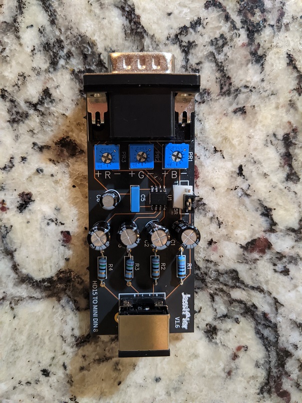

I haven't had a chance to look at my first one but I put together the third one and it works. I only need one so if anyone wants it just message me and you can have for cost + shipping. I am by no means a pro at soldering but the board looks well enough, lost one of the pin headers so I had to improvise on this last one.

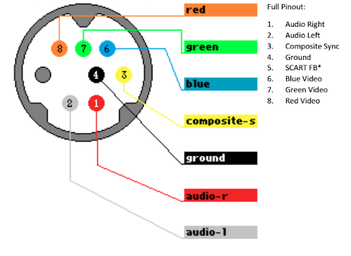

1. I'm not 100% sure, I took a VGA cord to Homedepot and found the correct size by matching it.
2. Nope, its a 8 pin mini din wired with the "retro standard" pinout.
I recommend one of these from etim, it works great with the OSSC.
