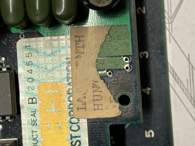

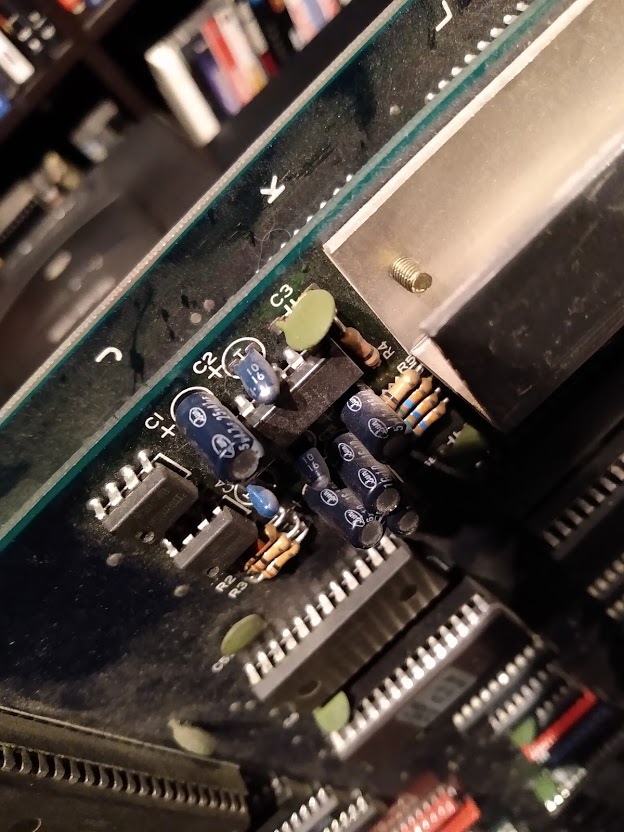

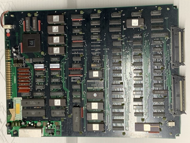

I picked up an broken unidentified Data East board which I believe is The Real Ghostbusters. There is garbled video and no sound. Looking over the board it looks C3 was knocked off or cut out. Can someone confirm the capacitor value for C3? This is likely not the cause of the issues, but I'm going to recap the board and this is the only capacitor I cannot identify.
Here’s some pics. The label is worn, but it looks like it might say Labyrinth Hunter G which I guess is what they remade to be The Real Ghostbusters. So maybe this isn’t Ghostbusters. There’s also a missing rom when comparing to TRG pics I’ve seen.

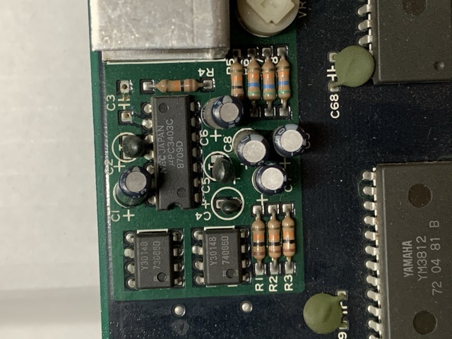

From pics online it looks like one of those green ceramic (decoupling?) caps. Probably the same value as all the other ones, maybe .1uf?
@ekorz Yeah, you're right it looks like it might match some nearby caps based on some pics.
