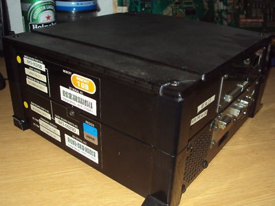

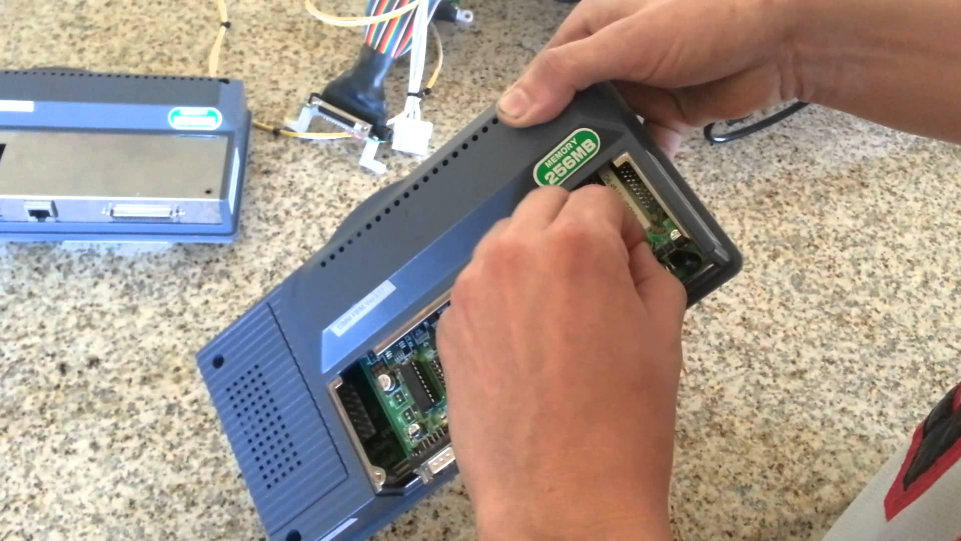

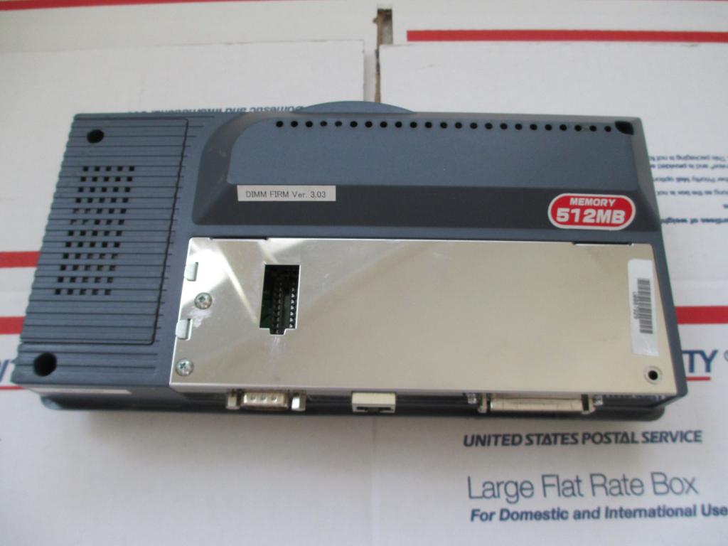

slightly off topic anyone want to create 256mb 512mb 1gig stickers for the dims
This is a fantastic idea. I don't have stickers on any of my DIMM boards but I found some decent images of the 3 sticker types that someone could use for reference...
The 1GB image is kind of crappy but it's good enough to pull the color and confirm that it's written as "1GB"
