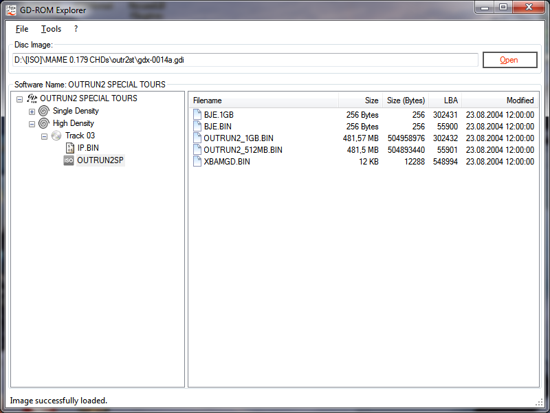

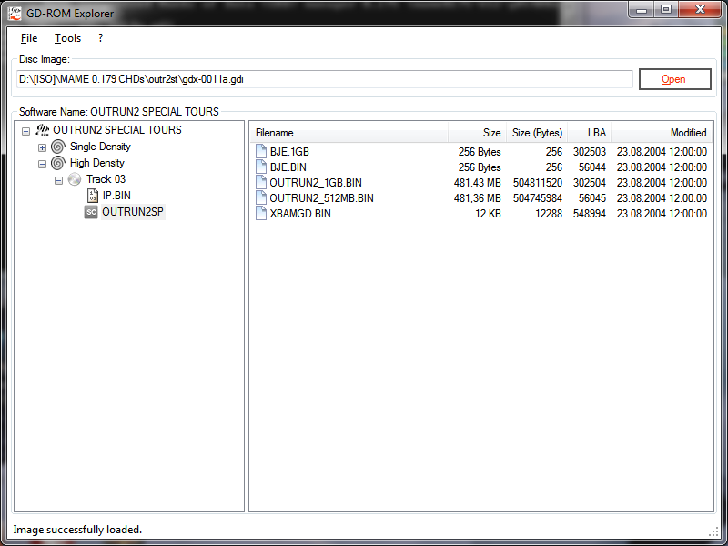

Aren't OR2 Special Tours and OR2 SP the same game ?
Outrun 2 SP is the Japanese version of Outrun 2 Special tours.Outrun 2 SP only have 1GB version, Outrun 2 Special tours have both 512MB & 1GB version
wrong.
both Japan (GDX-0011) and Export (GDX-0014) versions of Outrun 2 Special Tours have both 512MB and 1GB game binaries.
didn't get the question. each game disk have 512MB and 1GB binary (as you can see on screenshots), one of them will be used depending on user DIMM size.
both Japan and Export Outrun2SP game GD-ROMs is dumped.
