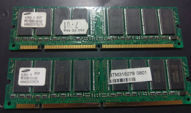

When you say "either one inserted" do you mean you are only putting one in at a time?Nice thread however none of these 2 matching Samsung M366S3323CT0-C7A worked with my NetDIMM.
Getting black screen with either one inserted![]()
