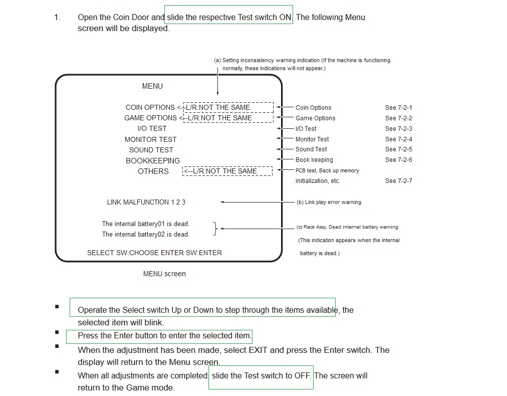

tried but no gun reaction. except when i put the gun in direction of solo mode. When i try to enter in test mode i got the screen 1s but if i release the button it don't stay in test mode it returns back to the game...tried a 837-13551 io. and 837-13551-92 IO and 837_14505 with no effect.
Some ideas ? i use confidential mission io gun board and gun
That's because it's a slider on the game: you have to keep it pressed and then use a up and down switch + an ENTER button to navigate
The Namco FCA board also works, probably the Sega I/O needs to use different pinouts? The TC4 manual is online in PDF form so you can check the pinouts @mr_magooz
the manual deals with najvs io, difficult to imagine/map with sega io... i don't have a pedal also...
not having the both switch up and down...where to find mapping with sega io ?
