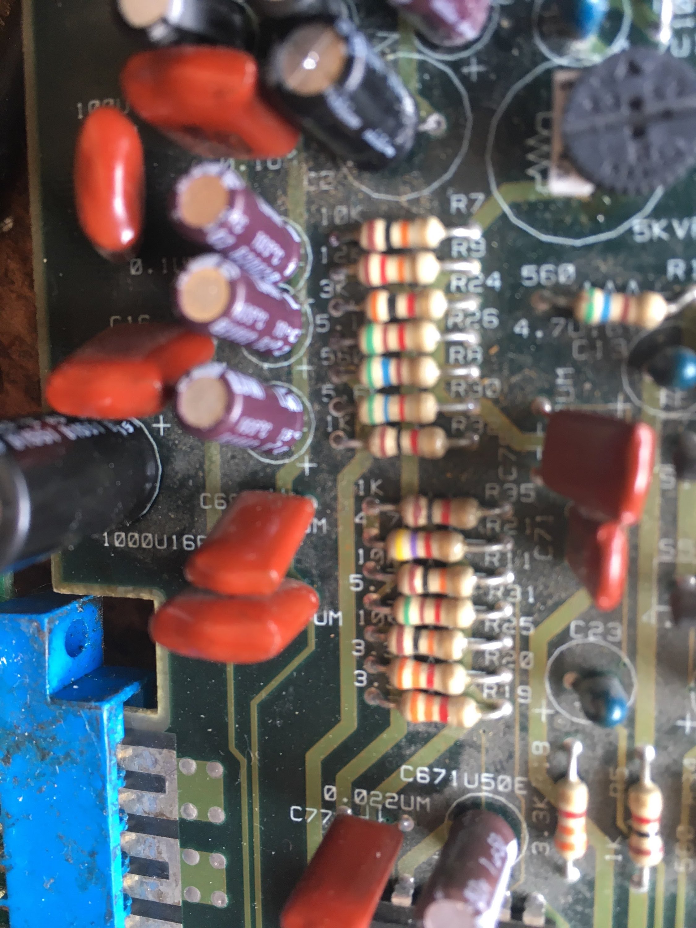

I was wondering if anyone can help me with the issue that my TMNT PCB is having.
When the game boots the sound seems fine (although loud) however when playing the game, while samples are played they're distorted, fuzzy and scratchy *AND* at the same time the samples play the music simultaneously becomes scratchy and fuzzy, the music will sometimes return to to normal if no other sample is triggered.
As the game goes on through the levels this gets worse and worse until you reach the final level and it's one big scratchy loud distorted mess (samples and music).
The lowest end setting of the volume pot it is quite loud, it almost sounds like when you run a Stereo signal through Mono.
I've tried and tested it extensively on multiple cabs, the supergun, and adjusted the voltage accordingly with no luck.
I've read a lot of similar reports on various forums and know this isn't an isolated incident, but there's many fixes that work for some and not for others and I'm hopeful someone here has better insight on a fix. Thanks in advance.

Start with the tantalum caps in the sound section (link).
Repair log was written by @yavuzg
The ultimate solution for my board's sound problem was to replace the 4.7uF tantalum capacitors (C6 and C74).
That is where I got to. There are still sound problems on my board, but this sorted out the intermittent sound issue.
Mine still sounds mostly good, but I've noticed the metal sounds (like cutting a parking meter or jump attacking a foot helicopter) sounds a little scratchy.
Will report back after I change the caps and let ya'll know...

On my TMNT board, i had the same problem, glitchy and scratchy music and sound. The capacitors seems ok externally, but can't count. One i replaced them with top Panasonic/Nichicon ones, and turn on back the game, guess what ?
ALL PRETTY MUSIC & SOUND FX !!! no more Glitchy and Scratchy play nuts :D :D !

At 5 volts, the issue would show up around 20/30 minutes. If I lowered the voltage to 4.5 volts, it would take much longer for the scratchiness to start, and even longer for the sound to cut out completely. To solve the problem, the three tantalums next to the sound amp heatsink were replaced (C6, C74, C73) and *poof*, my sound effects and music are perfect. Didn't see a mention of tantalums in this thread, hope it helps someone. Good luck!
