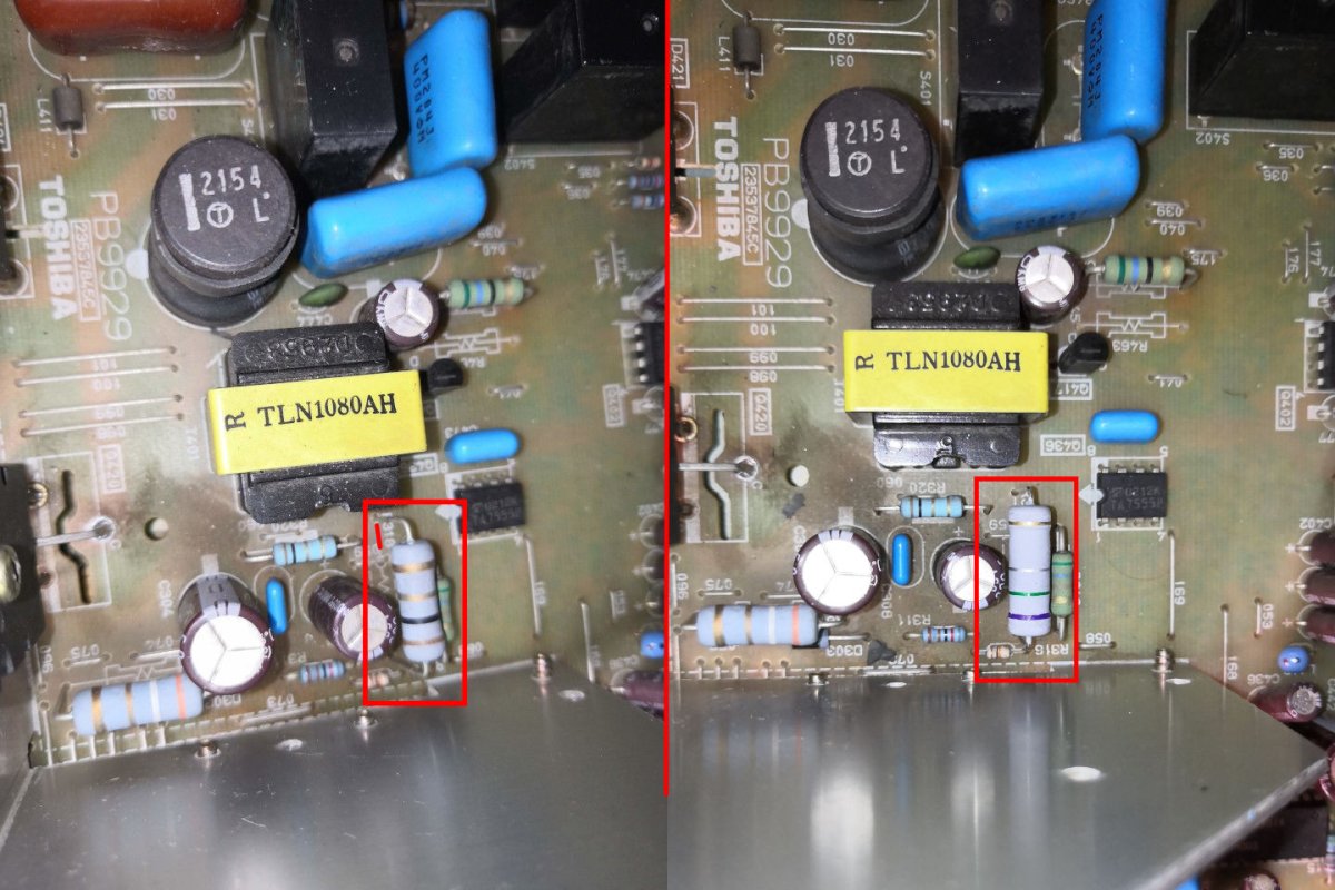

1. Vertical Deflection
If using a vertical deflection yoke with a lower impedance (~ 8mH), you might notice that you can not get the picture to stretch to fill the screen vertically. This is likely due to the current limiting resistor (R323). You can slightly lower the resistance of R323 and get more vertical picture size when using a lower impedance yoke (or a yoke that just needs a larger A.p.p)
I have found that using a 0.750 ohm resistor in place of the 1.0 ohm at R323 - I can successfully fill the vertical screen when using a lower impedance yoke around ~7-8mH
R323 shown below (Already changed to a 0.750 Ohm)
Follow up question - I believe the above picture is of the PD1843. For the PB9929, where is this resistor located? R318 on the PB9929 measures 1.0 ohm, but I just want to confirm as I am not technical on CRTs.

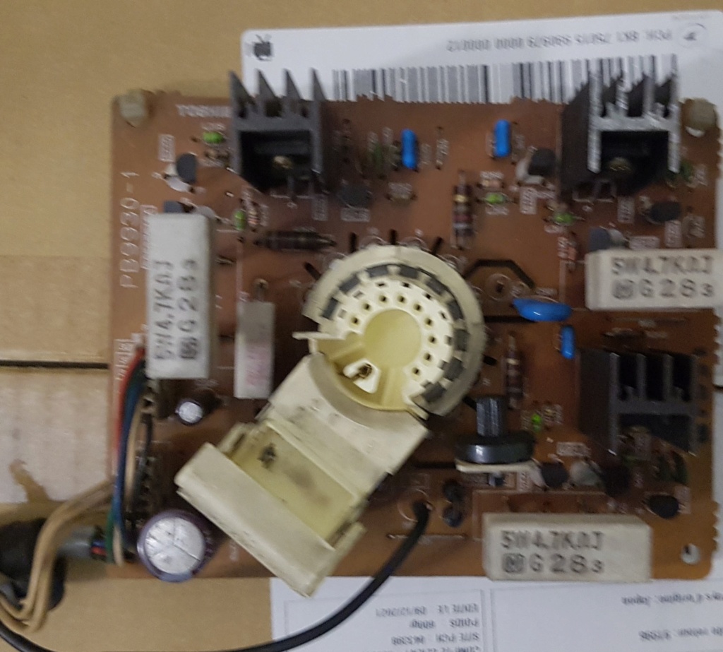

Does anyone know the connector type for the neckboard ground wire used on the Toshiba PF? It is the white locking connector that connectors the tube wire ground to the neckboard. I believe if is a JST HXH type, but would be great if someone could confirm.

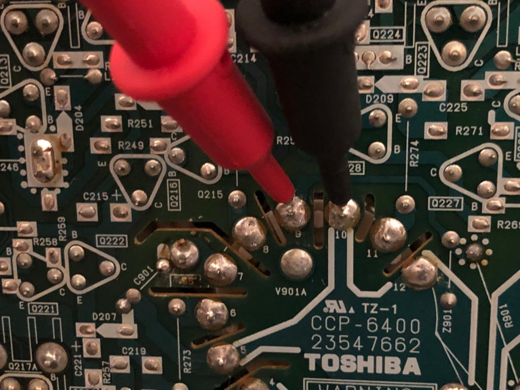

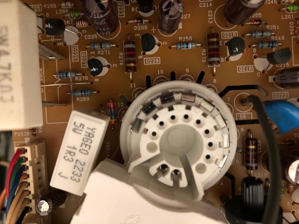

Some of you may have seen my wei-ya troubleshooting thread and have seen that I swapped to the modded PF chassis to get it working while I set the wei-ya aside for troubleshooting.
Anyway, I get a clear picture but the image is very dark.

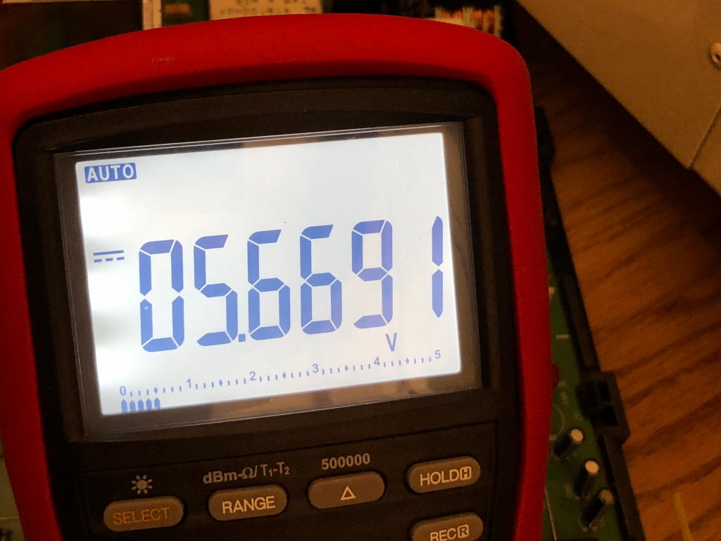

I measured heater voltage and it fluctuates slightly around 5.67V before stabilizing around 5.7V, which is quite a bit lower than the 6.3V spec, and I was under the impression that both high and low heater voltage are bad for the tube.This is with the 1.3ohm heater resistor.
Rather than just adjusting screen to try to compensate, I'd rather get everything set up correctly.
I read somewhere that measuring heater voltage accurately is difficult, but hearing what others are getting would help to tell me if something is wrong with my setup.
Can anybody else that has done the mods measure their heater voltage and report back?
Edit: Also, can I run the PF chassis off of 120VAC? I've been using a stepdown but it would be nice to be able to not have to.
