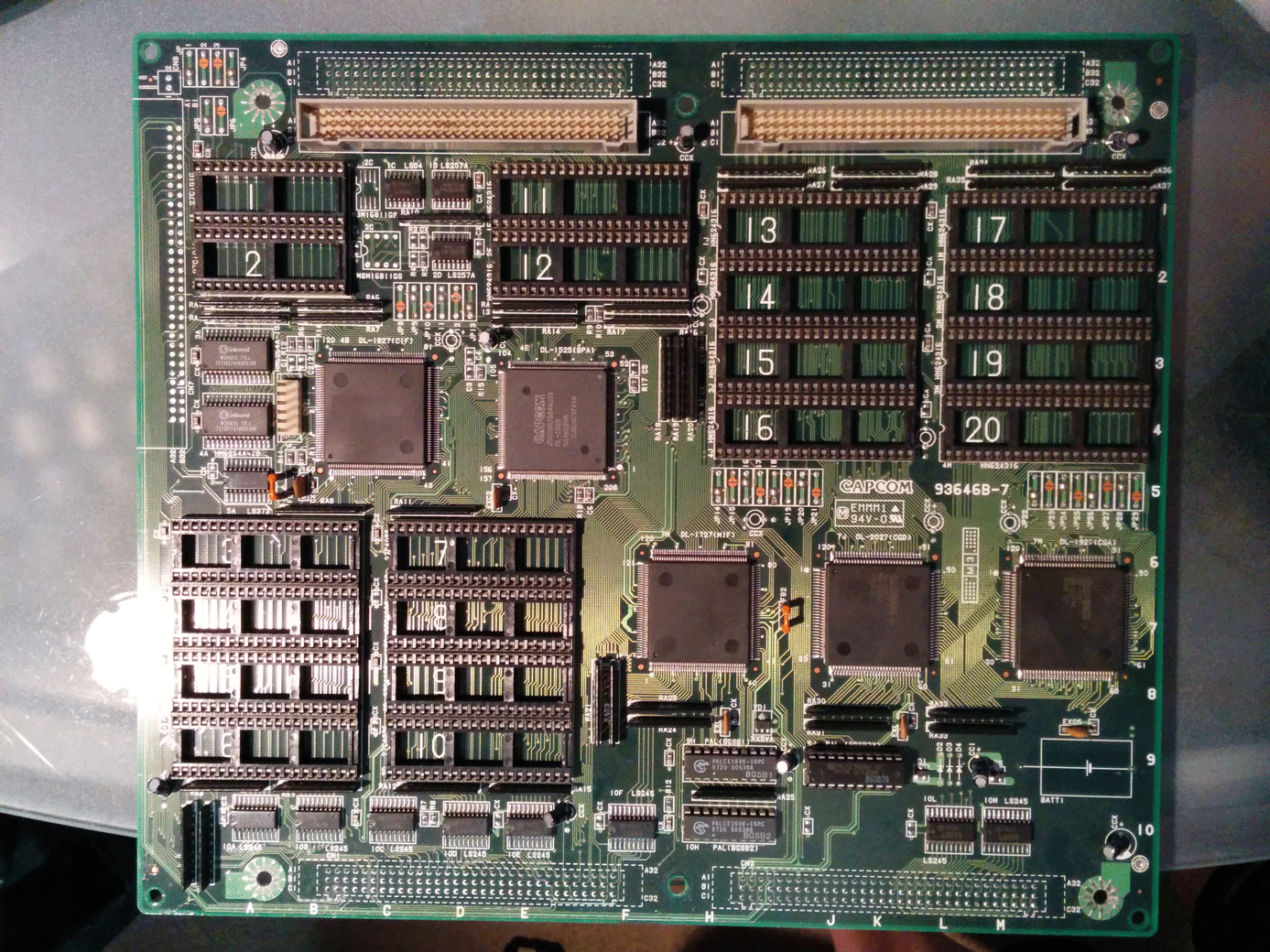

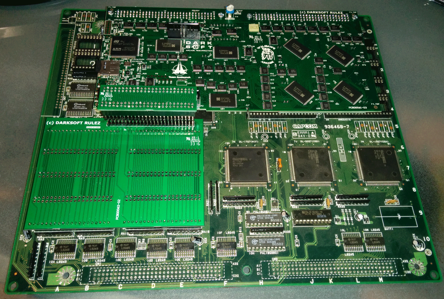

Hi, I installed a Darksoft CPS2 and I'm getting a solid green screen when booting it up.
Donor Board: Formerly Marvel vs Capcom (as I was told)
PCB Revision: 93646B-7
-All the jumpers look correct.
-I understand MvC comes with a PAL-G chip.
-I have not yet wired up the auto-reset.
When I turn it on, it detects the Micro SD Card and will say "Now Playing...", but regardless I'm greeted with a solid green screen. I do not have any other cards on hand to test since all my other Micro SD cards were not detected in the first place.
The Micro SD card I'm using now is a generic unlabeled 4GB card. I've formated it to fat32 and tried re-writing to it multiple times.
I've attempted to "short exc5" which I understand is just holding a piece of metal to the 3 pins on the bottom side of the PCB while the system is off for several seconds (correct me if I misunderstood), and that doesn't seem to help the problem.

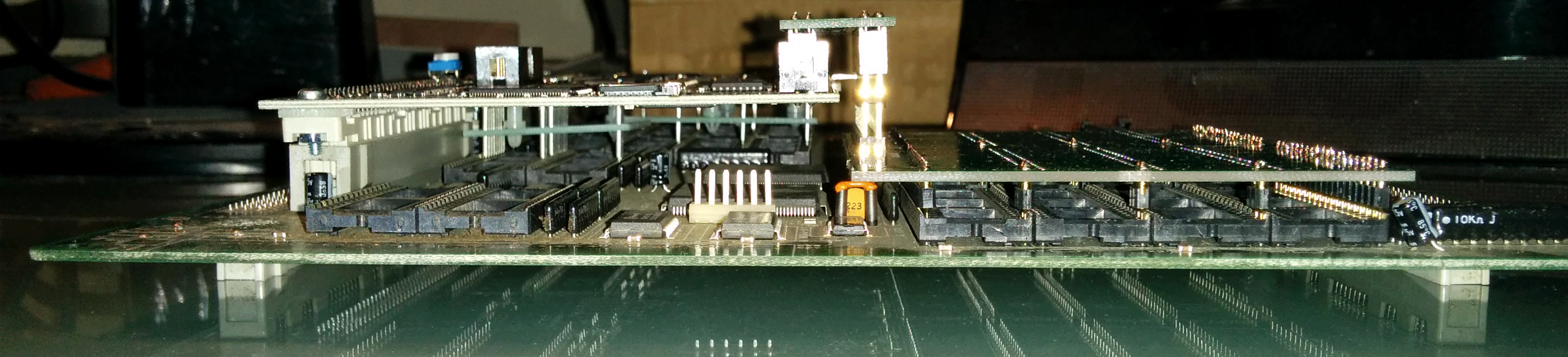

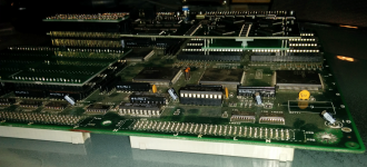

I know in the picture it looks like the interconnect is a bit lopsided, but I've since then tried pushing down both PCBs and the interconnect but everything seems about as snug as it's going to get.
Thanks for any help!

the tiny board that interconnects the other two pcbs of the keit seems not to be sitting properly. Check that and make sure that you shortcut exc5 to delete any possible keys ( with the power off!)

Damn it, it really was something just not making proper contact, lol. I reseated the interconnect and made some more effort to push down the PCBs and the system is working now. Thanks @Darksoft @Mitsurugi-w
