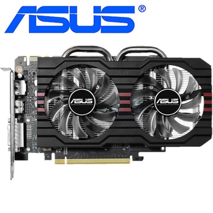

there is other 1 fan cards :
the other 2 fans candidate are :

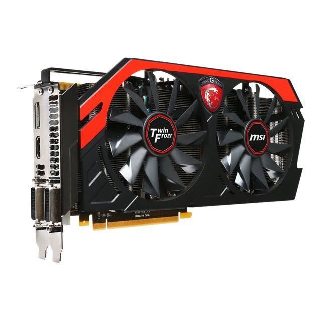

If I can't figure it out I will put a GTX 660 twin frozer III which I know works great :
It's the very first card on top, with the fan all the way to the right side. A friend of mine has a X3 model 407 (Figurehead) which has the 760 GTX video card on it. I will try to borrow it and extract the firmware from it and flash mine to see if it will make mine work or not. Will keep everyone posted.

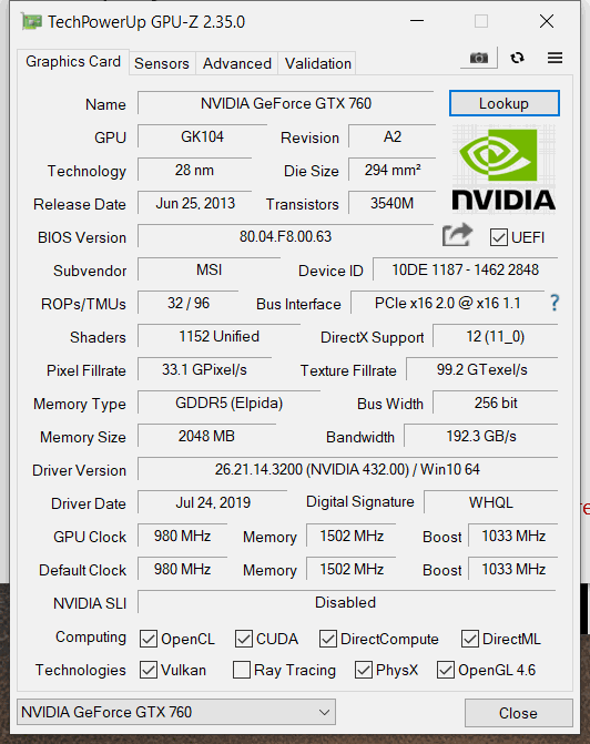

One step closer. Managed to flash my card to the GTX760 BIOS provided by @300wins.
I picked up a single fan MSI GTX760 card, same as stock - it just has a MIS sticker on the fan.
I had to use the patched version of NVFlash and also the -6 flag to bypass the PCI subsystem ID mismatch:
nvflash64_patched_5.590.0 -6 GTX760-model407.rom
Flashing process ran smoothly after that.

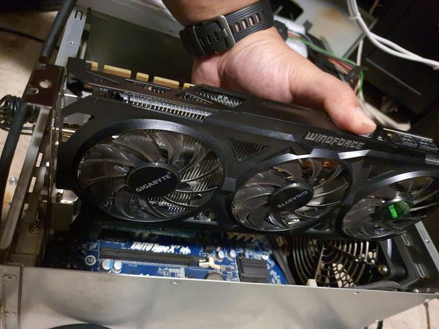

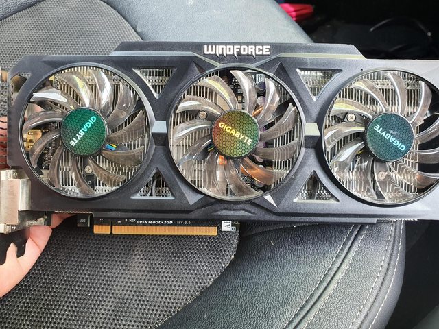

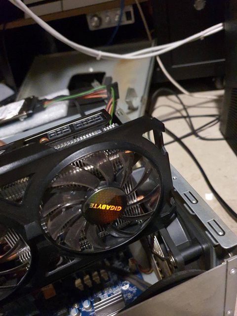

Found a 760 locally for about 60 AUD, so I thought I'd give it a try...
I can confirm the 3 fan versions of the 760 just physically won't fit without taking out the fan and having it outside.
Not only that, I didn't realise (stupid me didn't check) that the power is only dual 6 pcie not a 6 and an 8 connector, so I purchased a 6 to 8 adapter on ebay.
I tried fitting the card in this aftenoon and umm... lol. Yeah no chance of it fitting! :D :D
I might look into the 2 fan versions and see if I can find those for cheap too.
