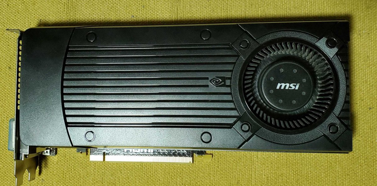

Please note that the firmware in the official X3 firmware thread are for the cards pictured. I've never tried to flash any different card than the ones pictured.

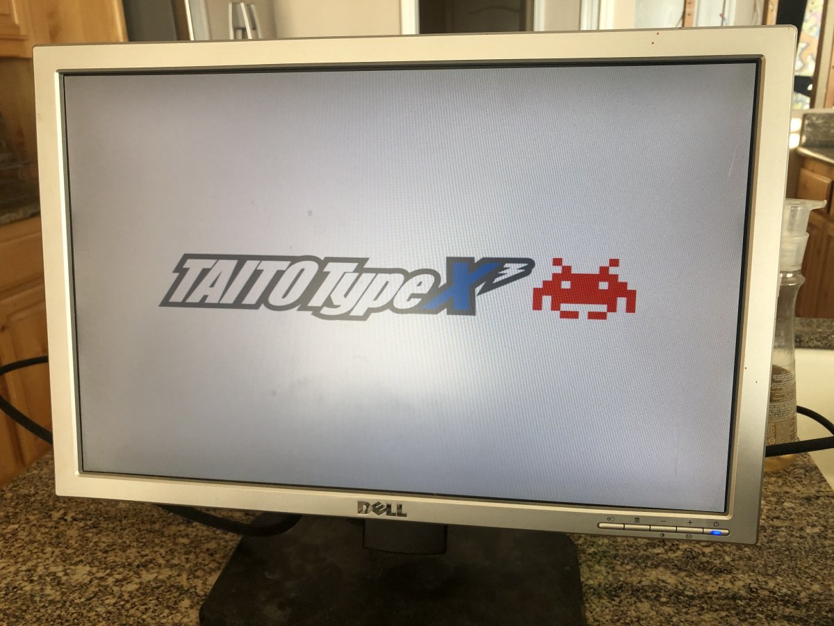

But when I start the TTX3 with the 760 GTX plugged in It stays on the taito type X3 logo with a biip sound every 2 minutes...
I put back the original 660 GTX it's stays only 2s on the TTX3 logo screen and boots fine.

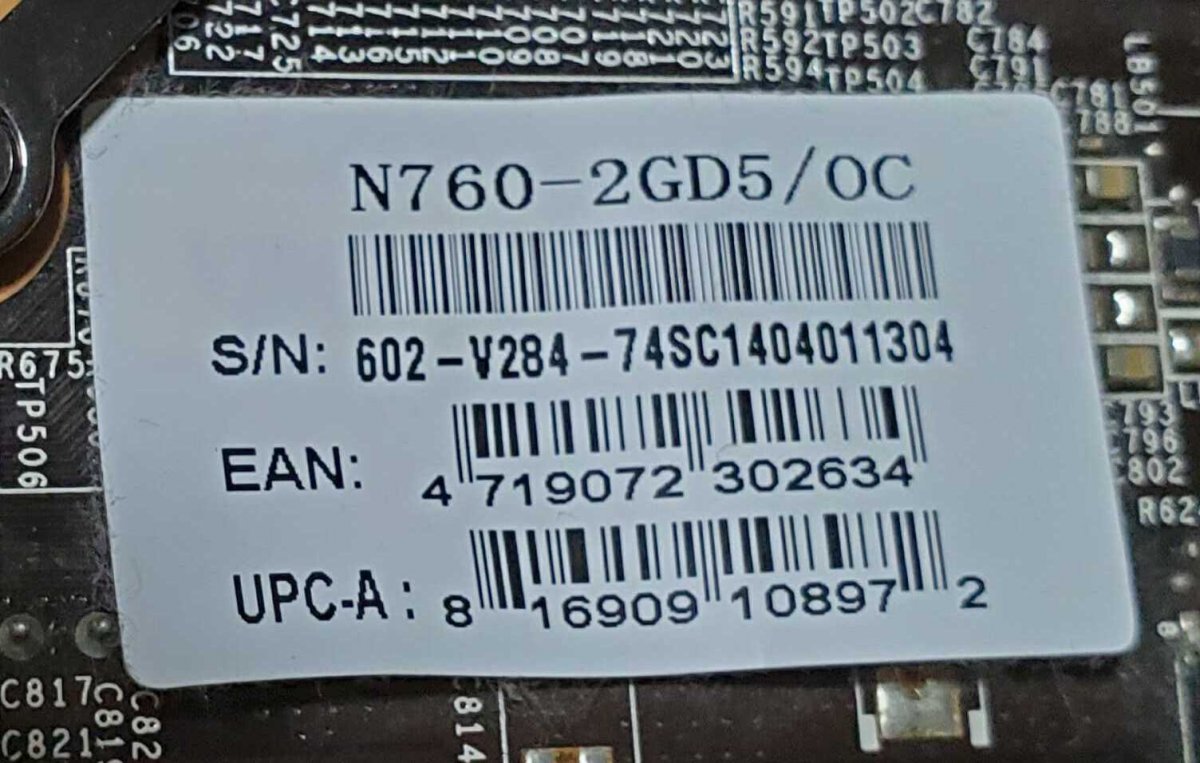

it seems there's 2 version of this card (N760-2GD5/OC) :
without UEFI and 99k bios https://www.techpowerup.com/vgabios/145232/msi-gtx760-2048-130603
with UEFI and 166k bios https://www.techpowerup.com/vgabios/162810/msi-gtx760-2048-140306

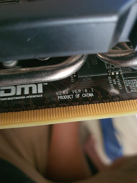

I had pics of the card since the ebay link in my previous post will eventually die

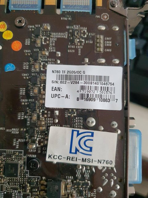

Looking at my model number, I actually can't find it on the site
Here's the sticker information on my one.

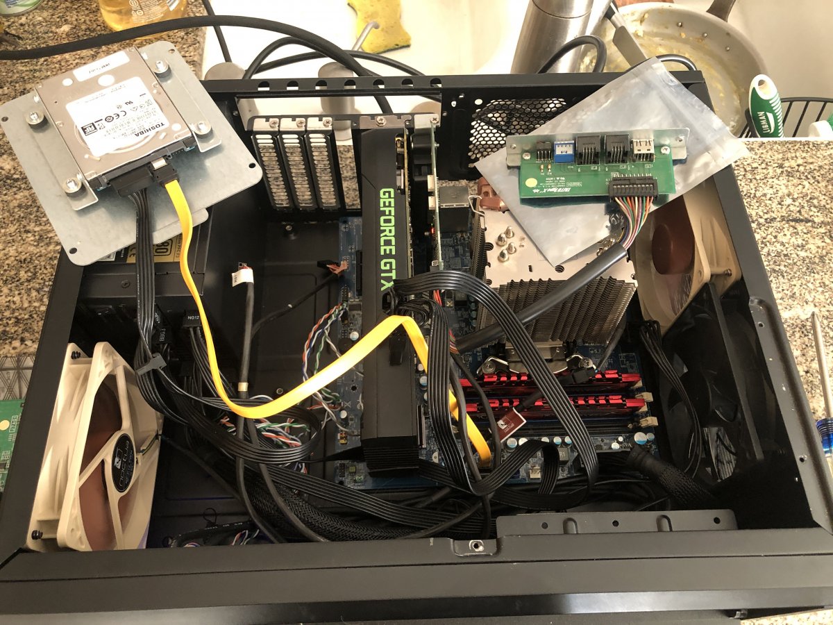

Last winter I acquired a super cheap junk Taito x3 motherboard, I put an I5-2500k, 8gb 1600mhz, fast io internal with a gunslinger stratos and key in with a commercial 660ti factory bios. The great news is at least it booted. I have an evga 760 and a 780 classified also with my founders 660ti....I’ll start flashing bios now and report the results. My question is do I need to power my cabinet I/o and nesica card reader to boot?
