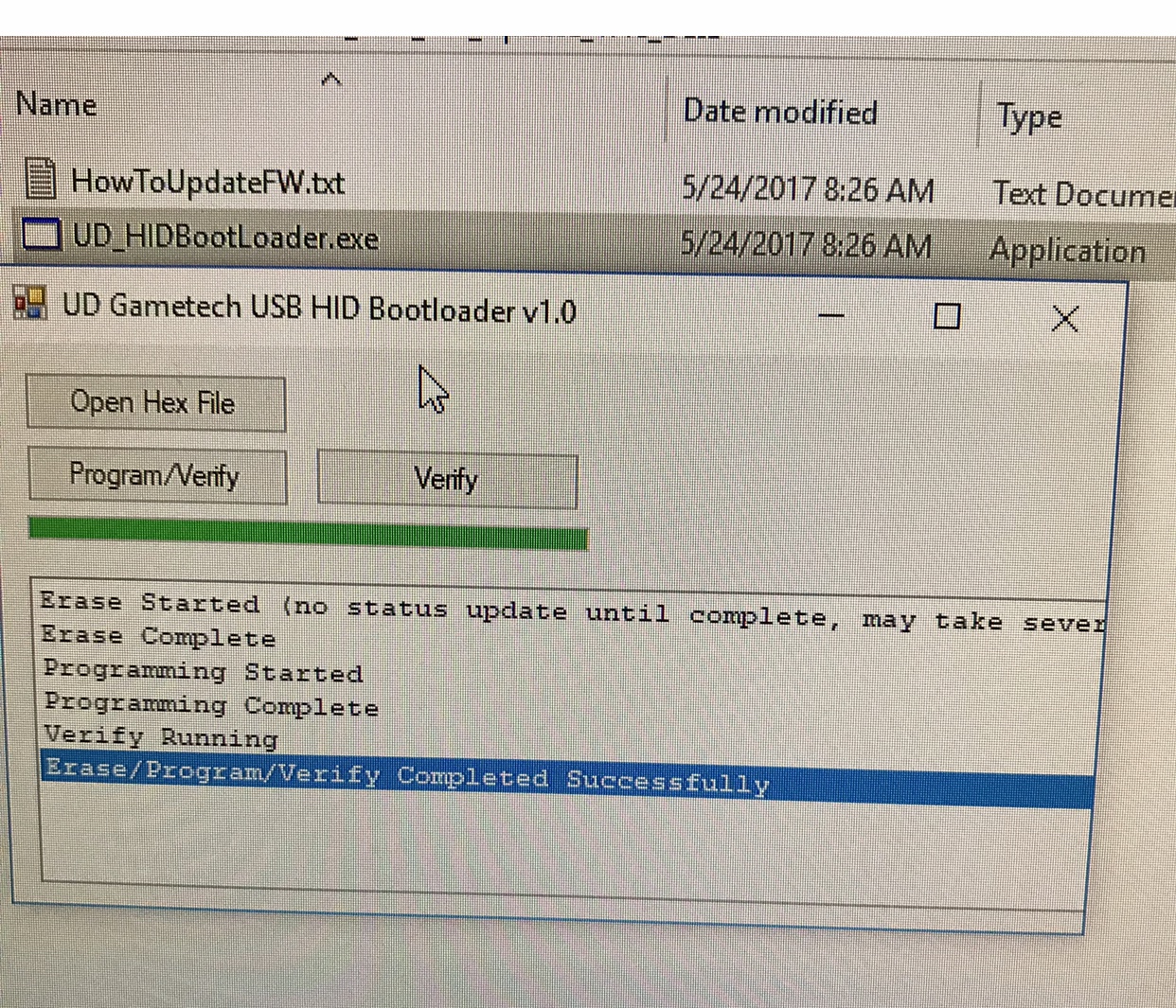

Sorry for the noob question but my 2 USB decoders won't work unless I hold onto 3P when turning it on... would updating the firmware fix this problem? I thought I updated it but I'll try it again. I am connecting my Brooks ps4+ fighting board into them. Thanks
I think I may be updating the firmware incorrectly because even after using the bootloader, I still have to hold on to 3P. I'm trying to update it to 1.4c beta. Any suggestions? Thanks.
