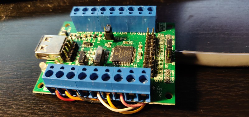

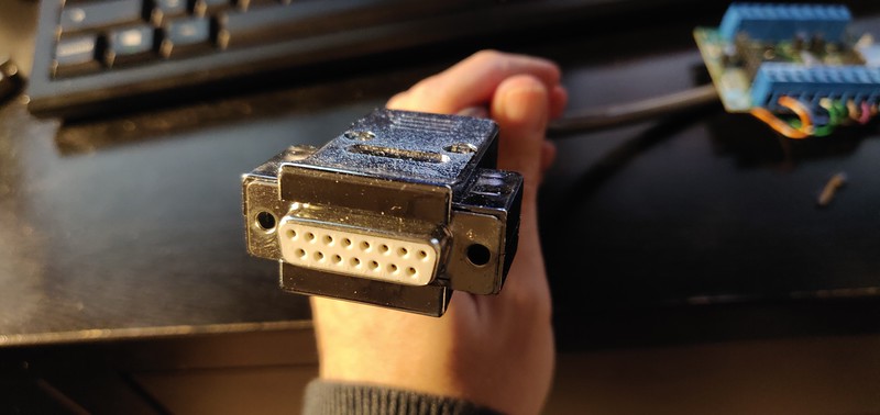

Maybe not the best solution for many of you, but I bought the screw terminal version, a DB-15 connector, wiring and made my own to use with a supergun.
Not the most elegant, but it works for me.
That's what I did. Works very well and is a great alternative if you don't care about the wire mess.
Could either of you provide links for the DB-15 connector that you used and a wiring diagram?
I picked up a couple of DB-15 connectors and housing local here for a few dollars.
As for the pinout, I used the pinout shown in the UD-USB (15 Pin D-Sub Version) manual found here.
Attached are two pics showing what mine looks like.

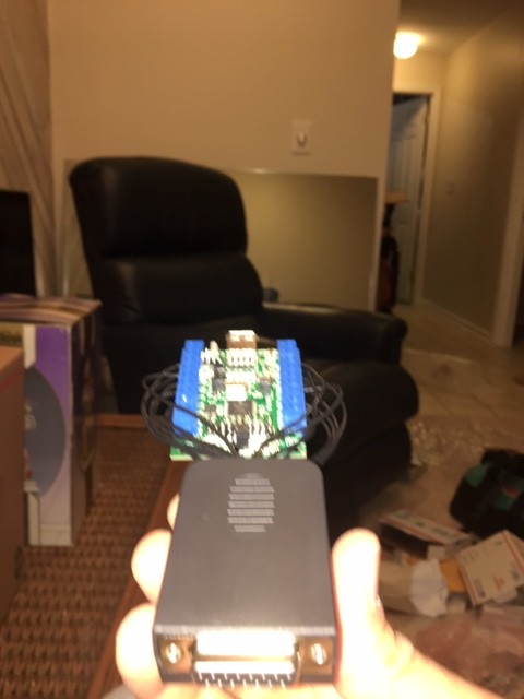

Had great success using the undamned* screw terminal USB decoder and this https://www.ebay.com/itm/331950758687 for my ATP-300 windy gaming supergun,
i bought 22 guage (AWG) solid core wire and a wire stripper and it was easy.
I wanted to clarify the firmware update procedure, I will take a wire and connect (on the actual undamned decoder) the Ground terminal to the Test terminal, (Like a little jumper) power it on with the supergun, and connect it to the PC?
The DB15 thing i bought also has a Ground terminal, which is why I want to clarify
yep, that's what i did to update the decoders
Wraith
Jan 24, 2019
252
88
Maryland
Thanks a lot. I'll try it tonight
