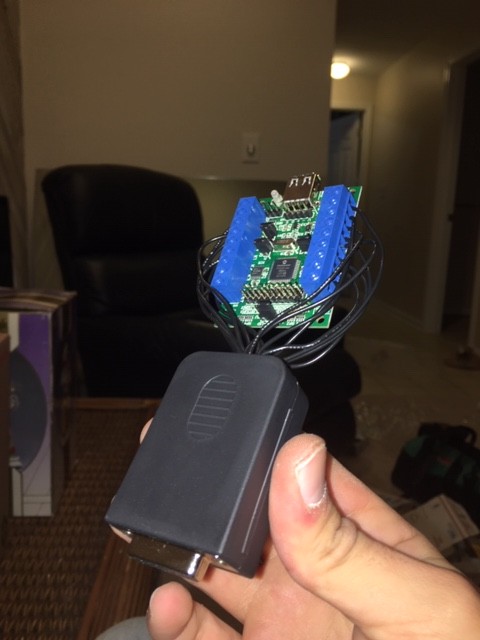

You don’t need to do anything with the GND terminal on the DB15 thing. Just run pin 1 to GND on the UD decoder
I did mine the same way before I got the normal undamned decoders
Just tested it out and it worked with zero hitches. :^)
