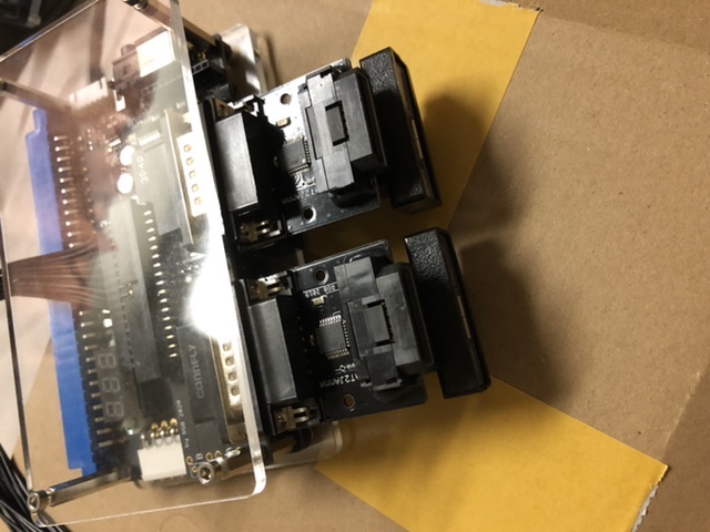

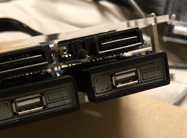

Great tag team or greatest tag team? Undamned’s USB decoders x RGB’s SAT2JAMMA adapters.
