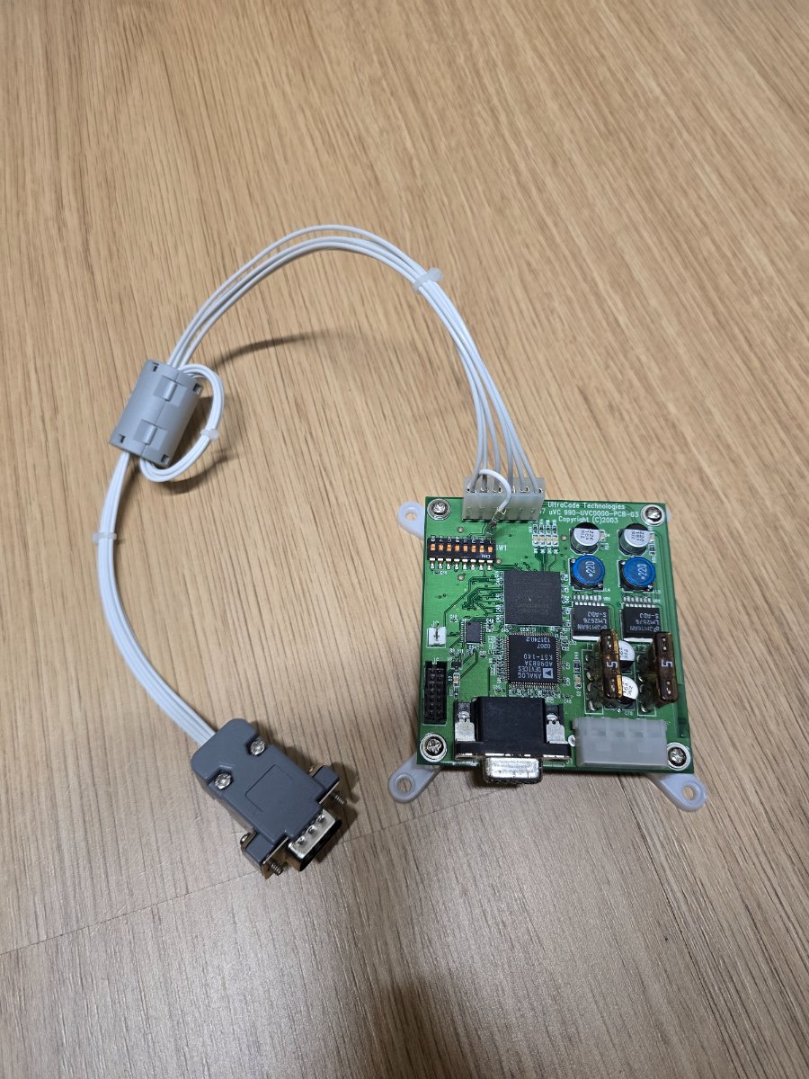

I really don't think the UVC is faulty as it syncs fine via the jamma JVS IO, I think it's something I'm doing wrong. I got up this morning and it occurred to me what the problem might be, 99% sure. I have a molex cable wired from my NVS4000 PSU for power, and a VGA cable in parallel on the 15 pin AMP UP, so I don't have to mess about with a jamma passthrough adapter. BUT, seeing as VGA allows for several ground connections via several pins, and I made that parallel cable quite some time ago, I'm pretty sure I used a different pin for ground. The reason being it wouldn't have mattered if I was going the @opt2not route via the jamma JVS IO, but now I want to go a different route, obviously I forgot about that. Hoping that's the case here as it's an easy fix, even though it'd make me quite the idiot lol.
Okay, it works now! It was indeed a simple ground issue (d'oh!).
Need to properly redo the cable with a female VGA connector and without the csync loop wire (as I have h and v sync wired separately now), but it works! The standard interface of the Xbox 360 still looks a bit bright due to it being mostly white, but it's doable. The games however look very, very nice. I'm happy :)

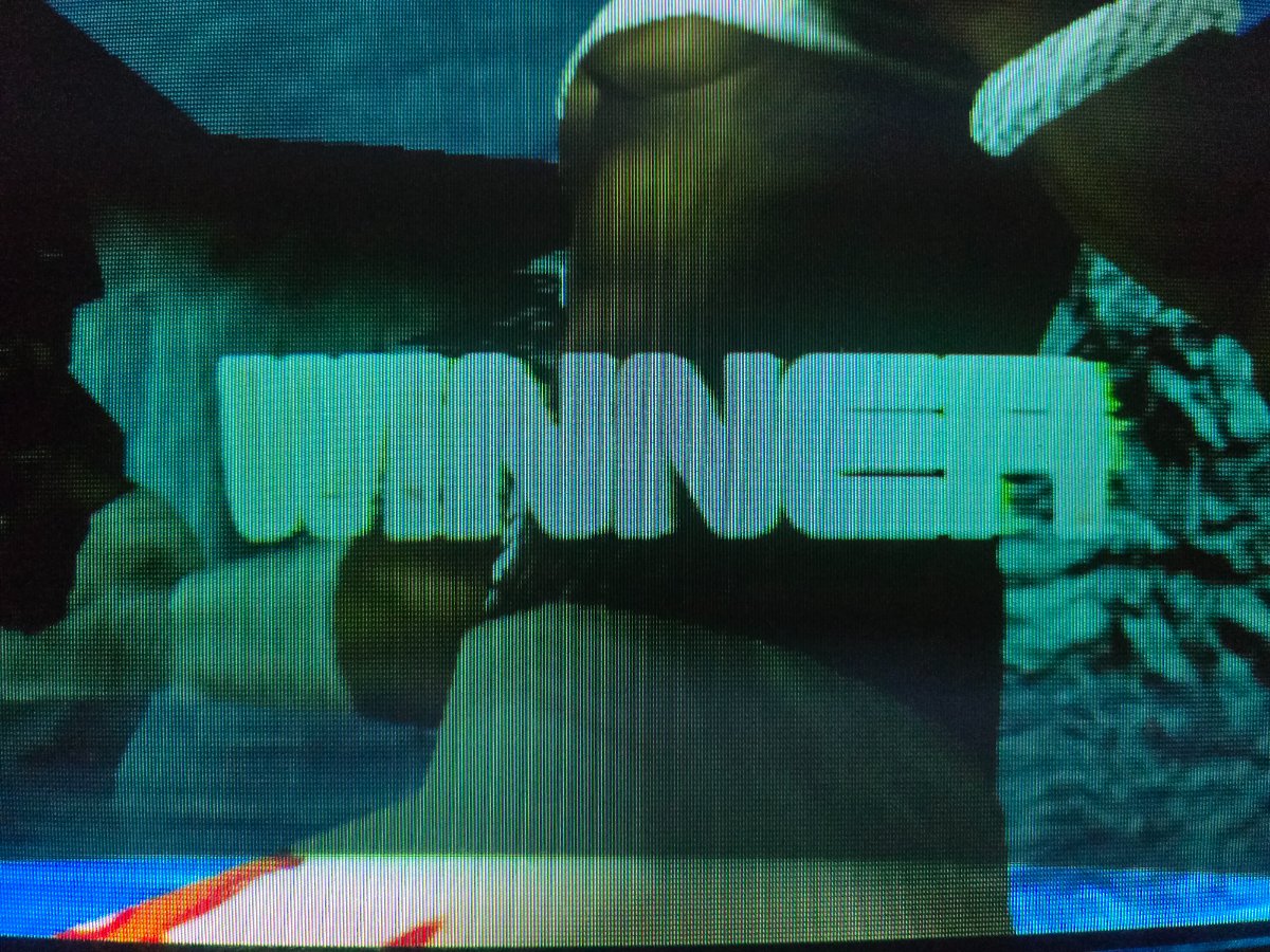

I have been messing around with the UVC for a little bit, mainly playing DOA2 on Naomi. While it looks great, it catches my eye that on both 15khz and 24khz (worse on 24khz, but it is definitely also present on 15khz) there is a substantial amount of bleed/smearing in the brighter colors. Anyone noticed this? Capturing it on a picture is definitely hard, but please see attachment to get an idea (terrible picture I know, but check the letter "R" on the right). In DOA2 you mainly see it in the text in the overlay (WINNER/K.O., etc.). I think this is what the guys maybe meant over on the shmups forum, about the Extron talk and the vertical shift? Btw, I tried every jumper setting combination I could, including hvsync and csync, but it makes no difference.

When was the last time you calibrated your monitor? Looks like the color pots could use some adjusting.
Actually very recently, got a new chassis, recapped it and then calibrated the colors... it doesn't show with anything else than the UVC. So can I assume you don't have it on yours?
No, doesn't happen on mine.
But I always do a quick re-calibrate on my monitors when I swap boards. So my monitor setup is tuned to use my UVC through my IO. Also I have replaced the caps on my IO's, but you're not using the IO as a passthrough now, so that shouldn't matter to you.
Okay, let me try that then. Can you let me know your calibration procedure and which input screen you're using and I'll try to replicate it.
I can't think of a system that doesn't have one.
Since you noticed the bleeding in DOA2, use the Naomi one. It's in the system service menu.
You were spot on @opt2not, I recalled I calibrated this monitor, but it was actually the previous chassis, d'oh... needless to say it looks a lot better now!
