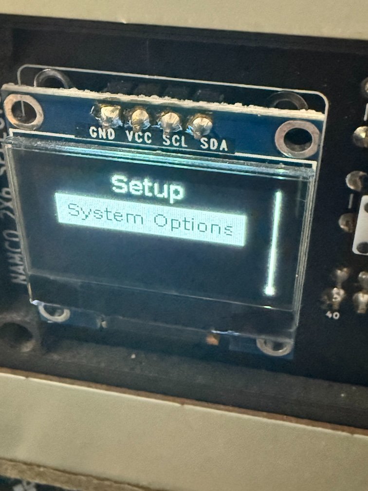

Lots of fun work this weekend. I have built a huge new version of the Namco Multi config that works on both the 246 and the 256. You *do* need an ODE from @electric_monk (v1/2 or v3 (fw version .508 )) and you DO need either a SYS2X6 security dongle from @brizzo (this would have to be found used) or a SD2PSX this is the one I got and tested with: https://www.amazon.com/dp/B0F1V55SRM?ref=ppx_yo2ov_dt_b_fed_asin_title). The important part is that the SD2PSX card has a usb serial connection on the front (this one does). The SD2PSX is likely the preferred method going forward because it's faster (dongle files are on the sd card - very quick), its available, and its fairly inexpensive.
What are the new features of V2.0?
  • AUTODETECTS if you have a V3 ODE, or a V1/V2 ode (will need more folks to test this) - and what USB/SD port the images are loaded on!
  • AUTODETECTS what security dongle you are using!
  • Go to the Options sections on the webUI to see what was autoselected, and that is also where you can change hardware models
  • Options sections - there is a download button for logs - if you are having issues - please download the logs and send them over to me - so I can try and figure out what is going on. Obviously I only have my hardware here that I can test on, and hopefully I covered most of the bases
  • V1/V2 ODE auto filters out the hard drive based games
  • Now monitors the ODE via serial after commands are entered, as well as the progress of the SYS2x6 dongle load to give feedback on both interfaces (LCD/Web) if one of those loads errors out you will see an error message and it will keep the system in hold mode.
  • Visual progress on the dongle load on both interfaces (lcd/web)
  • Reduced load time as much as possible so that it holds the system at reset now about 6-8 seconds into boot
  • Reduced time across the board (aside from sys2x6 dongle load) to load new games
  • Some games weren't showing in the web interface, now ALL games are showing in the web interface
  • Added graphics for all games in the webUI - sorry, this isn't my area - some of them are ps2 game covers - if anyone wants to really go through that and curate a better list, send em over, and I will get them on it - but at least for now, everything has a graphic (web UI)
  • WebUI is more streamlined - when you pick a game like Soul Calibur - you can see that it has 7 versions, and when you select it, you then pick which version
  • Lots of little changes to make it more robust

UPDATE: V2.5-V2.8.
  • Common design patterns on the OLED - a quick tap on up or down goes up or done once. a long hold (1s) on up takes you all the way to the top of the current menu, and a long hold on the down button takes you to the bottom. if you are in a submenu - BACK is always at the top, and is denoted by a bar on the left side of the OLED. SETUP is located at the bottom of the top level menu (more on these options further down). On the right side is a scrollbar that shows the current menu and your position in it.
  • OLED panel now has games grouped by name - you hit the select button to navigate into the submenu (noted by a left bar on the oled) - and you can select the variant from there.
  • to get out of a submenu - go to the top of the current menu and select "Back"
  • the game list will be very specific to what ISO/HDD images you have on your usb stick, it won't list any game where the ISO/HDD isn't there
  • In the webui, under filters, you can select/deselect controls - so for example, if you wanted to hide all games that need touchscreen hardware you can just deselect that option. It defaults initially to all selected
  • After first boot is complete, it will hold system in reset with a message that says "Choose game"
  • When game is loading, the up/down/select buttons are disabled
  • The Gundam games are in their own collection now
  • SETUP menu at the very bottom of the top level menu - this shows you what version you are on, ability to change back to hotspot mode (if you are in home wifi mode), if in home wifi mode, you can see the ip address, reboot, shutdown options, and the ability now to change the 246/256 setting. For this reason - there is just one image now - and it defaults to 246. If you are deploying this to a 256, go to the setup menu (or the webui) and change the system type to 256.
  • For anything in the setup menu, when you select, as an example, to reboot - the first screen will be "cancel" in case you accidentally hit that - select will then take you back a level. If you do want to actually perform a reboot, just hit the down button, and select "yeah, i really want to do this".
  • This image will be the last image (I think) that you will need to pull your SD card out and reimage. From this point forward all updates will happen OTA - to enable this, you will need to join your Namco246/256 to an SSID that has internet access. Once its up and running on a SSID that has internet access, go to the webui and go to Options -> Software Update, and it will check to see if a newer version exists - if it does, you can just ugprade from that menu and reboot the system. I would HIGHLY RECOMMEND you don't keep this system connected to the internet, after this upgrade I would recommend flipping it back to hotspot mode.

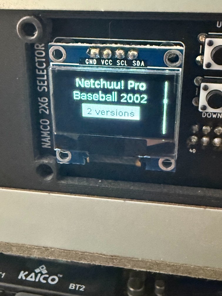

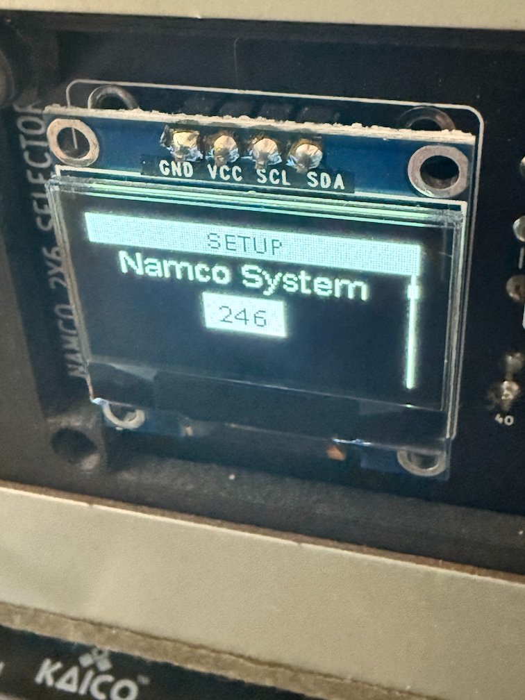

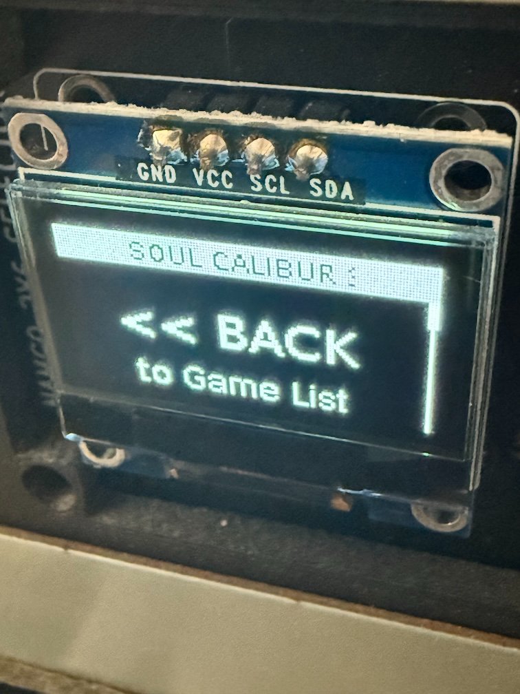

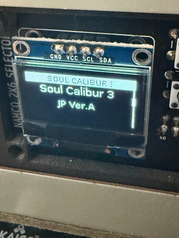

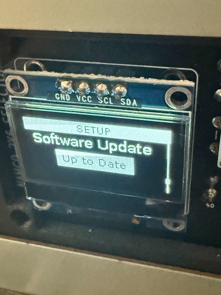

Attached are some pictures of the new interface look and some of the setup options on the OLED screen.

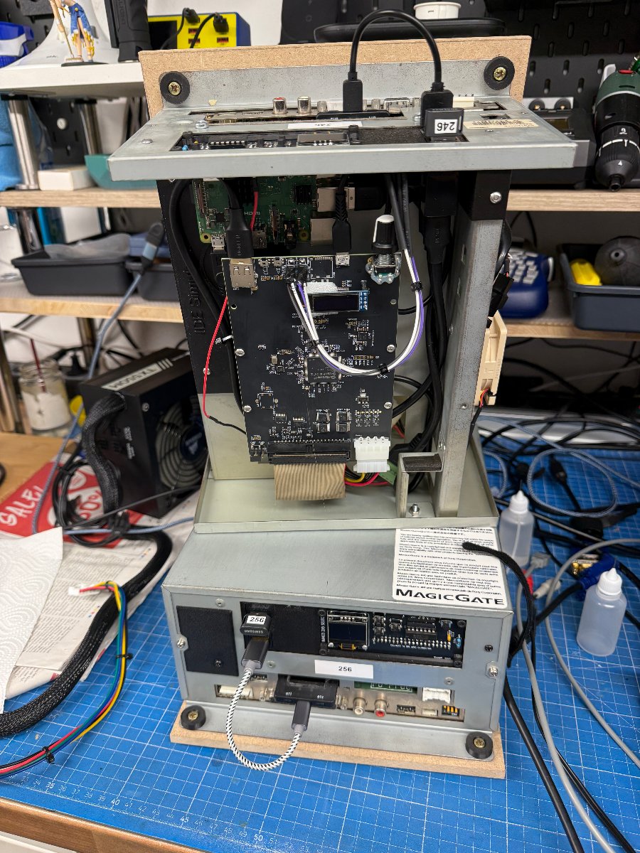

I started my 2x6 journey somewhen 2 years ago where i bought all the fancy stuff (ODE, 2SPX, Frontpanel...) but had to wait for the current solution. In the last couple of days i upgraded/put everything together and somewhen started testing. Have still to figure some stuff out since i am not familiar what it should or shouldn't do (thats why i haven't posted anything to this topic yet, but i am really really grateful that you, @El_isra and others put time and knowledge into this!)
Right now i own a 246 and 256, Both run with ODE3 (Firmware 509), and SD2PX (latest firmware), with latest image on the pi (with Dongle and Games from the mentioned packages on the first post).
Currently i run 31khz output through a ossc to see if i get an output.
- Automatically - selecting the Dongle on "SD2PX" works
- Loading image works.
After the Screen shows the game title most the time i get either a blank screen (with a resolution showing on the OSSC) or some loading stuff which "hangs". I got some games loaded on the 246 (not all) but 99% games dont load on my 256.
- How long should a game load and what are the indicators for a finished load?
- Is there a way to live debug a game loading (i am familiar with linux and pis ... and guess i can ssh into the pi and check a log?)
- i will test more and not sure what my current problems is (can be even hardware fault)
... anyhow just wanted to say 1000 thanks to you and all who worked on that stuff and didn't want to wait any longer, even if i am not there yet with my setup to fully test everything
thanks!

Thanks for the write up!
First thing to to do is hook up a monitor which handels 15/31khz native to elimate a possible issue with the OSSC
I can and will follow the single iso/security dongle route, (small) but: I got an oled display on the ODE3 and watched the display on the SD2PSX - both are selected correctly. - I guess that will not change anything, but i will test it.
Regarding the jumper an the 256. - Maybe i did something wrong here: The 256 has a jumper on its motherboard for 256/246 itself (or was it a pinheader output.. not sure anymore) where i connected the Jumper pins of the I/O too. Was that a mistake? (have to look at it to check what i have done there)
The 246 just has a reset wire, the 256 has the same reset wire, but also the 3 pin header for 246/256 selection - this is normally a jumper you move back and forth depending on the game you are playing on the 256.
If the ODE has the right image, and the dongle is correct - its likely an issue with the reset wire, or a hardware issue on the 246/256. But - testing w/o the multi in the mix will settle that.
I connected a 3 pin wire between the "mode" Pins of the Multiselector and the "256/246+"-Pins of the 256-Motherboard. Is this not correct? Do i still need to set a jumper?
You will need to solder on a wire to your reset location on your Namco 246 or 256 as well as make a 3 wire jumper to connect to the 246+/256 mode on the Namco to the multi pcb. - Source
That is correct - make sure its oriented correctly (246 side, 256 side).
when you do the test WITHOUT the rpi - you will need to drop a jumper there so you can do the selection manually.
Matt

I ran some more tests today :) - Sorry for the long text:
  • Cable or direct connection to the ODE does not solve my problem. Cables are fine
  • I bought two of the mentioned sandisk usb drives. (but after my testing i guess i wasted money :D - but no worries will use those in another project later on)
  • I tested with my samsung usb and the new sandisk usb drives
  • I only tested on my 256 for now (since that has the most problems, if those are narrowed down i will test the 246)
  • I test with the original SC3 security dongle and only the SC3 image
  • the pi and reset line is diconnected
  • i did not set the jumper on the 256 since it seems to default to 246 anyway :) (otherwise i would get an error that i set it into the wrong mode)
  • all my errors and successes are 100% repeatable and behave always the same. but i havent found the root cause, yet (maybe later tonight, preparing more testing right now)
  • i used an windows 10 laptop with https://tabby.sh/ to connect to the serial over usb to the ODe. And start "monitor" on the connection to see the SCSI reading outputs (wich show some sector reads and stuff i dont know about, but nothing useable for me. So i just use it for pattern recoginition. Havent seen any "error messages" there.
  • i use tabby.sh since i can reconnect to the ode with a press on ENTER after i rebooted the 256
  • in all my cases i only had the soulcalibur ISO on the drive.
  • firmware 509 does not work. Output of "monitor" is very limited. My guess is that it fails right away. (not a freeze, just not really any output)
  • on firmware 508 ALL my usb drives started right away and i see a lot of monitor output). If numbers float by faster than you can read: ODE is working and reading stuff.
  • I flashed firmware 508 and 509 multiple times: 509 never worked, 508 always worked. sometimes the flashing of the firmware hang (i waited 5-10minutes and just rebooted ... to see nothing was updated, not sure what the cause here is) - maybe i should disconnect the IDE cable? :D
  • I reformated all usb drives multiple times with different cluster sizes (always exfat) and copied the same ISO file over. Game started always 100%
  • After about 20 successfull starts and no crashes (let the game run a couple of minutes) i lost my mind somehow, since i had that much trouble starting games (even under 508 yesterday. I repeated some starts to rule out false positives.
  • Only difference : Yesterday i copied and formatted the usb drives under windows 11. The Image/Iso files are the same. Copy method the same. I checked if microsoft changed anything with the exfat formating between windows 10 and 11: no.
  • I still had a card reader with an sdcard in it, which i didnt touch today, which crashed yesterday. - booted the 256 and had a "crash". By crash i mean nothing frooze, the ODE was still responsive, BUT monitor showed that it was in kind of seek loop where the ODE never got out of it. (will post it in an bugreport ticket later). Only difference ALL files were copied under windows 11 yesterday. ALL files... but my successfull runs were with only one file on the drive
  • I removed all images but the soulcalibur one and the error was gone. Game booted fine
  • At this point i am not sure what causes it and will run more tests:
    • Right now i copy all files on that drive again and see if i can reproduce that error again... after that i will delete one file, some files, etc to figure out what causes it.
      • Is it a bad image?
      • Is it the files number on the drive?
      • Is it the sector position of the image on the drive?
      • Is it how i wrote the image to the drive? (using totalcmd and windows 11)
      • Is it the USB3 Port my USB Drive is connected to (different drives cause different issues?)
      • is it a naming of a file?
      • will test with all usb drives i got (to rule out that it a hardware issue with different drives)
      • can hdd and iso images on the same drive, or those that cause trouble f.e. if the ode uses CDROM mode but sees a hdd image?
interesting - great troubleshooting steps. I can say that when I made my usb drive with the 78 image files on it - it was formatted default exfat in windows 11, and then the 78 files were copied over to it. I never tested making that usb-drive with any other version of windows or mac.
HDD and ISO images all should be on the same usb drive. Did you get the images from the links in the first message?
Matt
Yes. Even downloaded those again a couple of days ago. - Will run some tests to hopefully reproduce the problem. Would be really annoying if everything works now :)
Oh boy, i think i figured it out (but will run some tests with fresh formated and copied usb drives again)
I used an USB3 hub which sits on my desk to copy the files. For some reasons copying this way the ODE cant read the files correctly and "crashes". The file does not get corrupted since i can copy it of the drive and copy it back onto on a different direct USB connection or different computer and the game will start.
My wildest guess is that the USB Hub driver send the file stream in a way that the file does gets written in a weird sector order which causes trouble with the ODE. But that is something for smarter people :)
Test run:
- connected the usb reader with the sd card to a direct USB port on my windows 11 pc. Copied all files to the stick.
- Started some games .. all were starting / working.
- Connected the usb reader to the hub, copied only soulcalibur 3
- Alle games started, but SC3 crashed.
This has nothing to do with the FW 509 - That Firmware does not work for me. Complety different error (with similiar behaviour = game does not start)
What helped me debugging this stuff:
- connecting the 2x6 to a Multisync Monitor (i think even 15khz helps) to see the normal boot logic and understanding/ learning it. Toying around with it what happens if i disconnect something (dongle, jvs cable, etc)
- connecting the serial monitor to see if the ODE reads
- the red light on the ODE to see if it loads or loops (=permanent light for a long time)
- understanding and running the simplified setup methew mentioned
I will do some tests (to be sure i really found the issue) and open a support ticket for the ODE3. - Guess i finally can start testing the image itself and post some wishes :D
One wish would be:
Add some improvements to the OLED Display selector, f.e. :
- Fast scroll through the file list if a button is pressed for 0,5sec or so
- Group same games together - maybe select first the game and then the version. I even would group all those gundam games :)
- only show games which are on the SD Card
I was thinking about the grouping games - and how that would work with the selector. like maybe a long hold on the select button would allow you to move "into" a stack, and doing it again would move you OUT of the stack.... that would clean up the root level a little bit and make it easier to navigate. I will play around with this idea.
Only showing games that are on the usb thumb drive - this is a fantastic idea - I just assumed that everyone would want them all, but you are right - they might just want a few, I will implement that feature.
