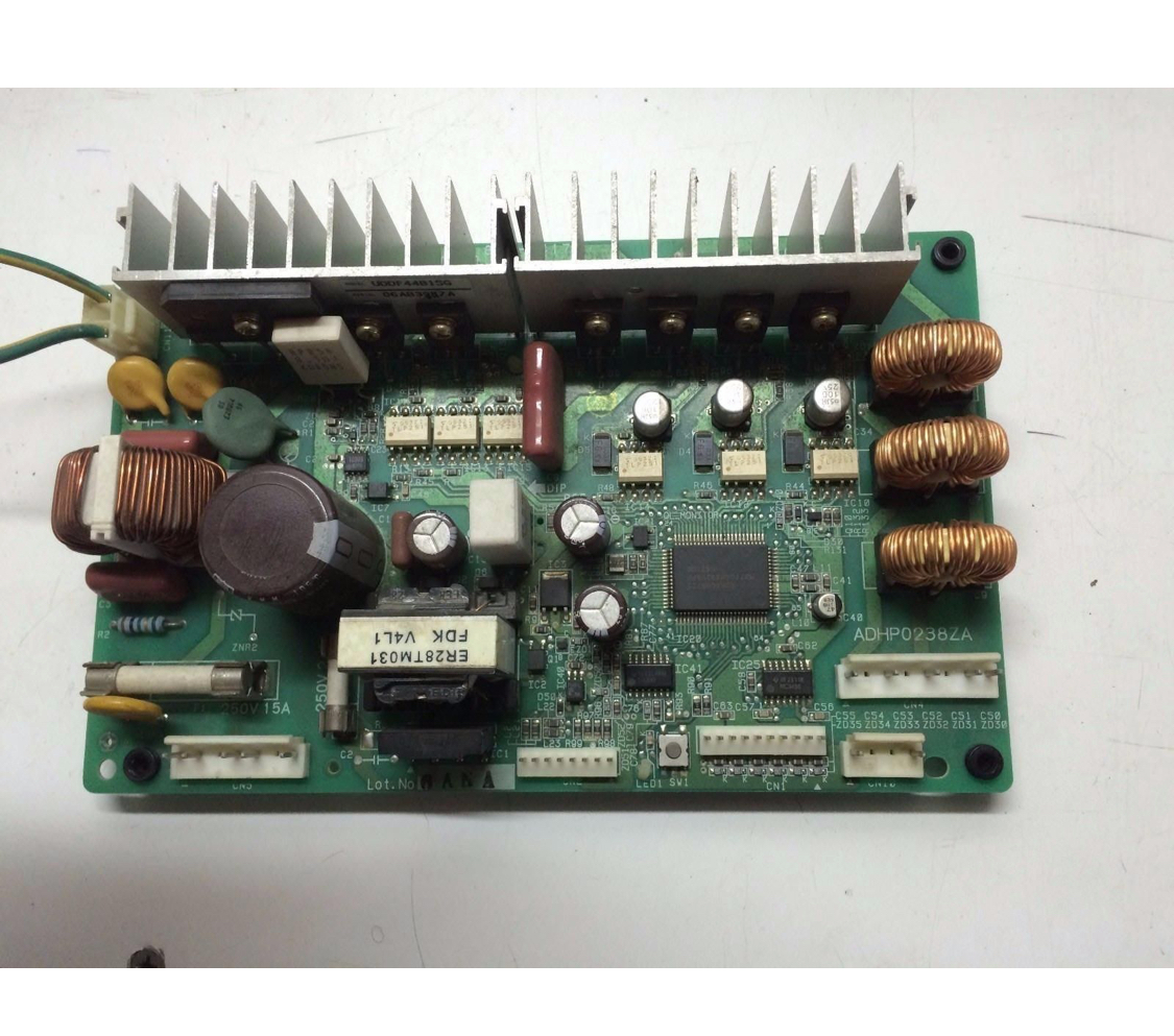

MIDI Which of these cn1 , cn2, cn3, cn4 , cn5 , connect to the universal ffb controller pls 🙏. Thanks
CN2 (you can look Initial D 3 schematic for example).
Universal FFB controler have CN9 7 pins connectors (Naomi 2).
The old version should do the job (FFB controler hack)

it's not just a matter of passing orders from one to the other, that's not compatible
I had to recreate the effects one by one on each game. My board retrieves game requests from the Lindbergh, and manages the midi board with torque orders.
For this to work, you have to plot the position of the steering wheel on my board with a wire to an analog input.
The universal FFB controller is designed to directly replace the system (like the Naomi for example), and as there is a 7 pin connector on this side, that's what I put on the board.
Eh, Sega Serial and Midi board use the exact same protocol, just the transport method that is different - one being RS422/RS232 (depending on jumpers if you got the jumper version), and Midi - apart from that it's identical - I have F-Zero AX (triforce) running perfectly on a Sega Lindbergh FFB board.
I tried the opposite. A Lindbergh on a midi driver board (with baud and hardware adaptations) and it didn't work.
