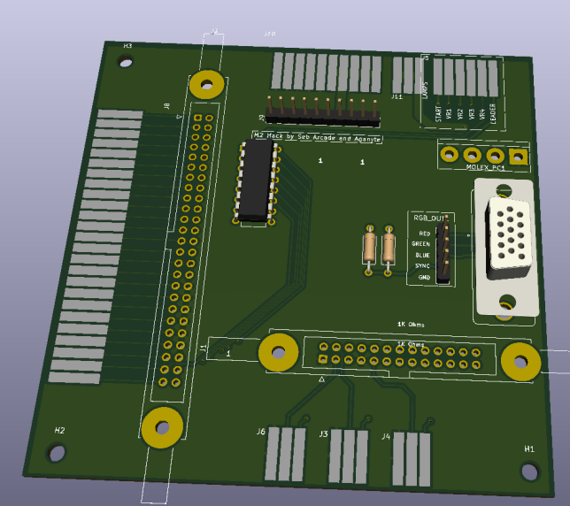

Following up a discussion I had with Aganyte about your setup, he is designing the equivalent of the JVSHACK card but for M2 which is named M2Hack
This card will look like this (here compatible with a Daytona M2 setup), he is also working on the other M2 hardware variations.
Depending on the systems you will run first, you may need additional hardware, but as discussed with Aganyte in private, we'll be able to guide you in the process the get the most out of your racing cabinet.
The three cards mentioned before are definitely mandatory, one does not exist yet (Daytona M2Hack), and will need testing, but Aganyte is really fast at designing cards.
