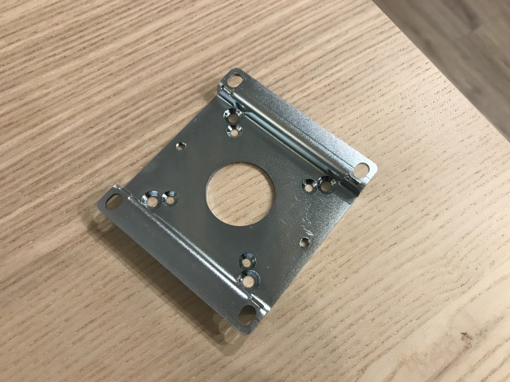

FS Universal joystick mount plate for Vewlix and Chewlix
does exist something like this for NAC/NNC panel for mount seimitsu?
LS-56 is the same footprint as Sanwa JLF, but most prefer the LS-32 which is larger/needs a different mount.
Thx all. Thats the problem i would like the ls32 but impossible with original. Thats better ls56 or sanwa. I prefer vs fight and shmup

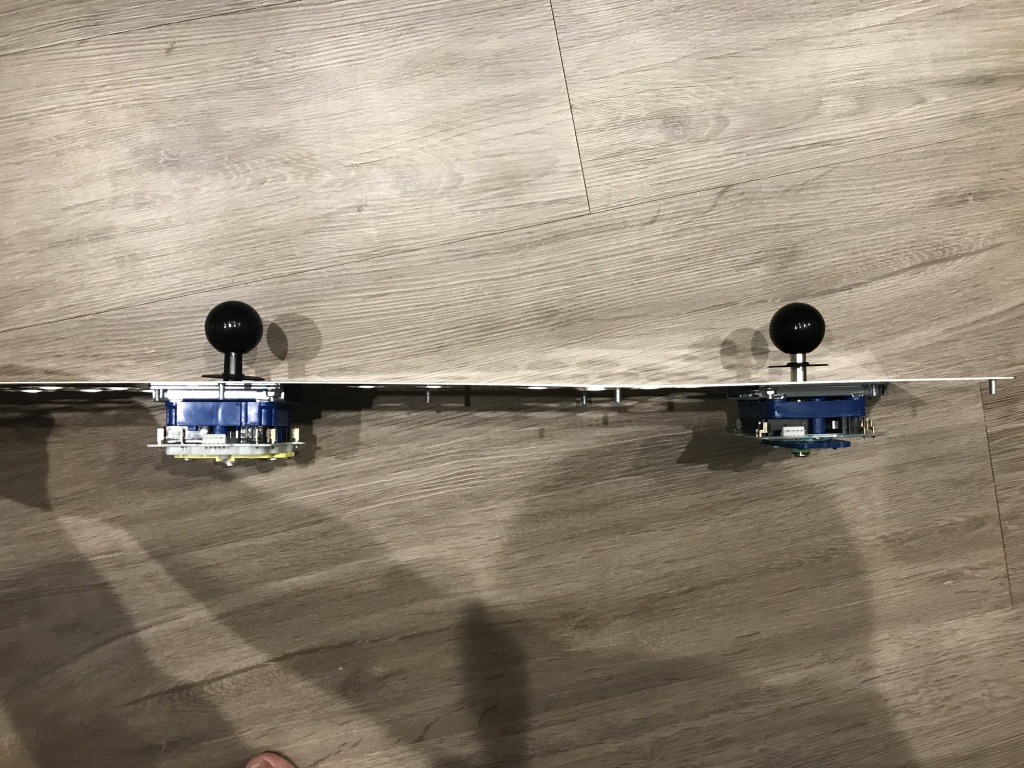

I just got my prototype today. Installed LS-32 and LS40 on an exact replica of Taito 2P control panel. I was able to install without any issue. When I thought of incorporating Crown korean stick, it was already after I've sent out the design to be manufactured. Since it's a minor update, I'm going to skip another prototype run. I'm getting a quote so I should hear back something soon. I plan to order little more than the quantity on the list.
Any info on how much those Taito 2P control panel replicas are going to cost if they ever get produced?
Don't know, really.. There are many factors that determines price. Shouldn't be Taito price for sure though. I'll add to my list. I was thinking about adding R2 button for convenience.
