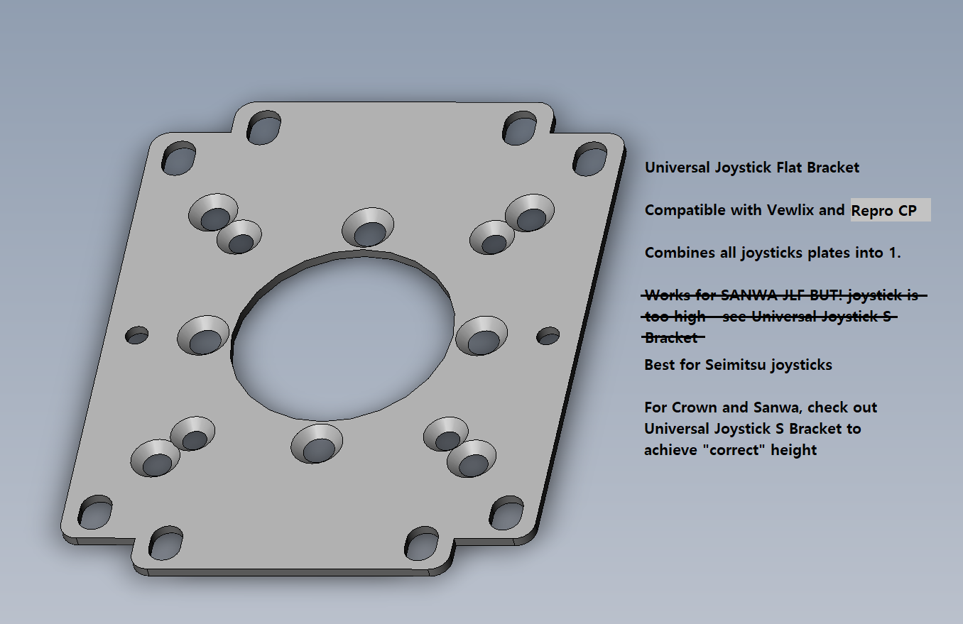

FS Universal joystick mount plate for Vewlix and Chewlix

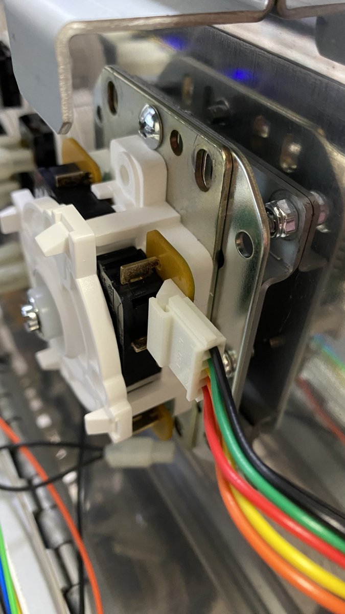

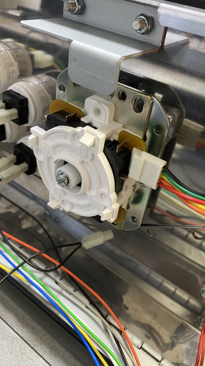

With a flat version prototype, joystick height for Seimitsu is almost close to JLF using Taito bracket.
When will you have the flat version up on your site?

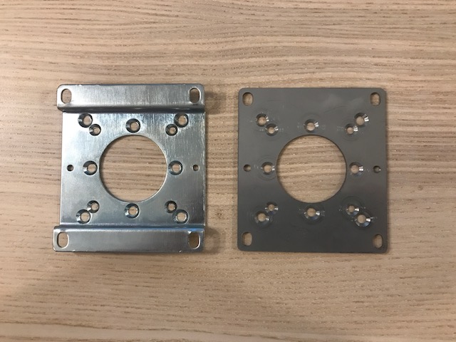

I have a prototype version available that I have to get rid of and will offer a discounted price. Will post tonight once I go home from work. I think I have 18ish
Not as professional as the production version but it is usable. One teeny tiny issue is the M4 flat screws won't fully flush in so it creates a small gap between the CP, like .5mm most. The gap is being mirrored so it looks bigger than what is actually is. It's made with stainless so it's not easy to do re-work with regular tools. This issue will be addressed in the production version.

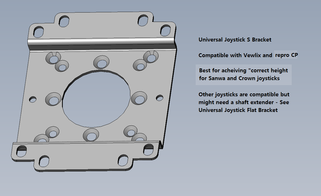

Could someone help me to know where this S Bracket is available to buy right now in Europe? Hadouken doesn't sell worldwide and I´m only able to find mounting plates for Seimitsu and Sanwa , not Crown, not compatible with my Vewlix cabinet.

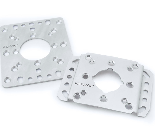

I´ve found out this Kobal flat plate, but I´m not really sure if it will fit well on the original Taito plate for a Crown lever

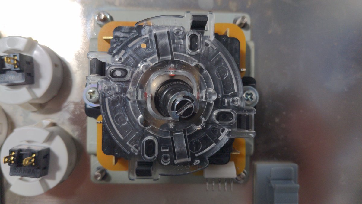

Are you trying to use a Crown short collar stick?
I've tried all of those and they don't work. I also don't believe the Hadouken Arcade S bracket was ever produced.
I made one that you can 3d print.
https://www.arcade-projects.com/threads/mounting-plate-for-korean-joysticks-on-vewlix-panels.25214/
You might actually be able to use that Seimitsu plate mentioned above, combined with the stock Vewlix plate, if your stick has a JLF style mounting plate.
Hey man! You were right!! I bought the plate you mentioned and it totally worked! Thank you so much! I had to McGyver it a little but now I can use the Otto V5 mod on my Vewlix. Virtual bro hug to you!
The stock vewlix plate is designed to work with the JLF housing without any other mounting plate. Just rotate the stick 90 degrees and those unused mounting holes will line up with the screws on either side.
Yes, it is the CWL-303FJ:
In fact, I´ve used it in a Qanba Obdisian fightstick without issues and modifications needed, so the hole in the vewlix panel is not a concern as this fits ok.
I've finally ordered a Kowal flat plate as in the product image both 303 and vewlix names appears, I hope it would be fine...
Thanks anyway, I´ll try with your 3d model in case this doesn't work.
