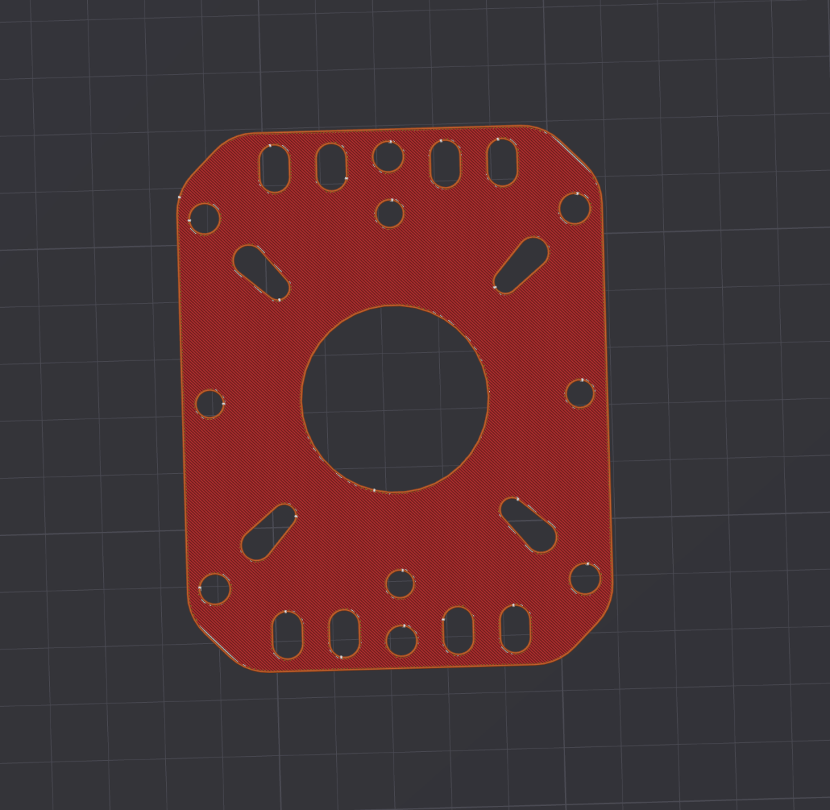

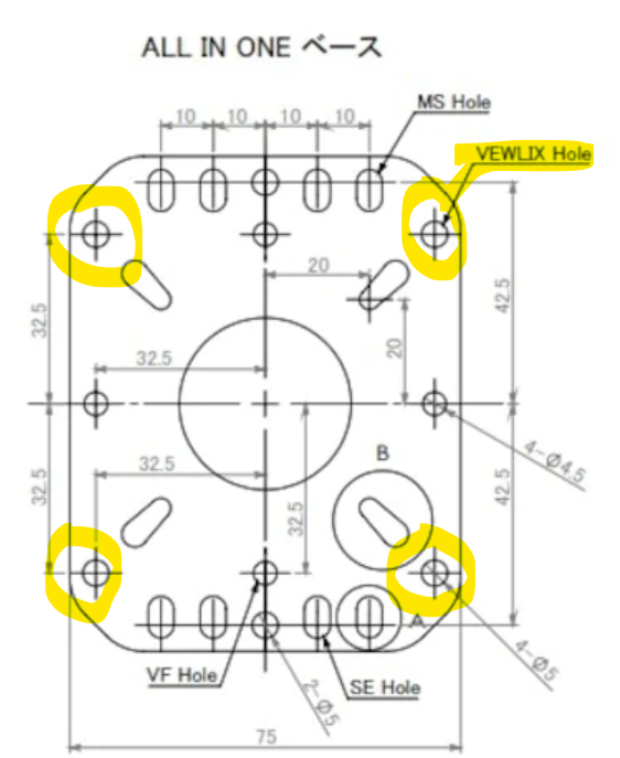

I have a friend who does 3d design for a living converting that diagram provided by seimitsu into a 3d file I can print before I go ordering from the uk. It’s going to cost more for shipping than the 2 brackets so I want to make damn sure they work lol

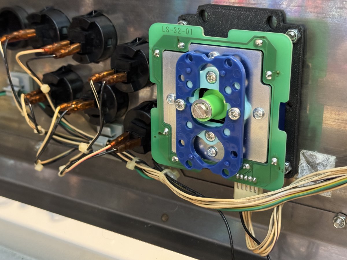

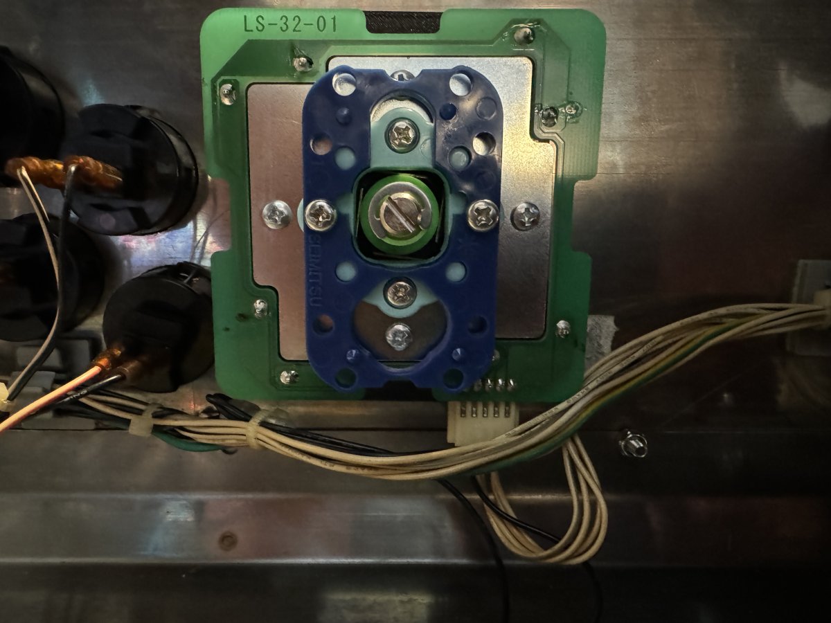

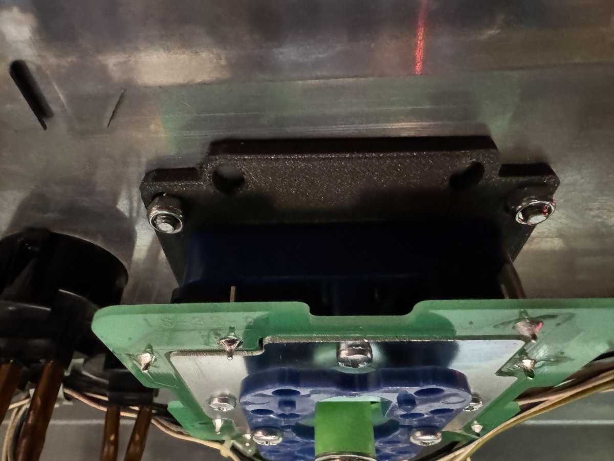

I also had the the bracket modeled for 3d printing. It's currently printing now, so no reason why those of us with 3d printers need to spend more money on adapters. once it's finished, ill upload it to printables. but i'd rather have a metal plate so i'll order them when im ready to order more buttons for my 2player setup.

Do you have pictures of this mounted? I just got the Seimitsu universal plate for my LS-32 but it does not fit the posts of my Diamond black
Thanks for sharing the pics! Is your plate based off of an existing plate? I tried the seimitsu and paradise arcade plates and they don’t work. Is your file shareable to be printed?

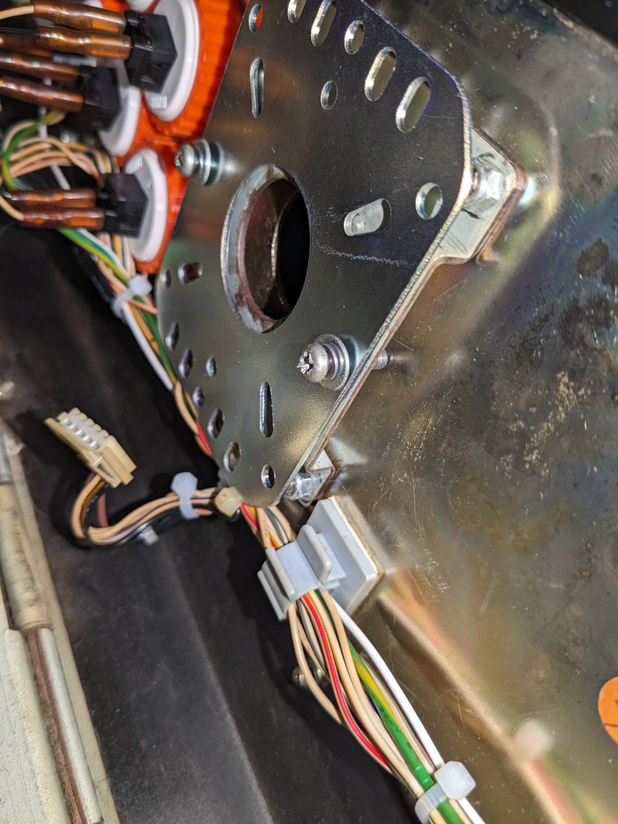

So I'm pretty sure you're supposed to mount it like this to the stock Vewlix plate.
The problem is if you want to use an LS-32 you can't use those holes without filing down the blue plastic body.
It’s based off the seimitsu universal plate but it does t fit the stock vewlix points so it’s been modified for that. I can send u the file to test print if u want. I sent it to another user but he hasn’t gotten back to me yet.
I'm not sure why Seimitsu says these 4 holes are for a Vewlix when they don't fit a Vewlix.
