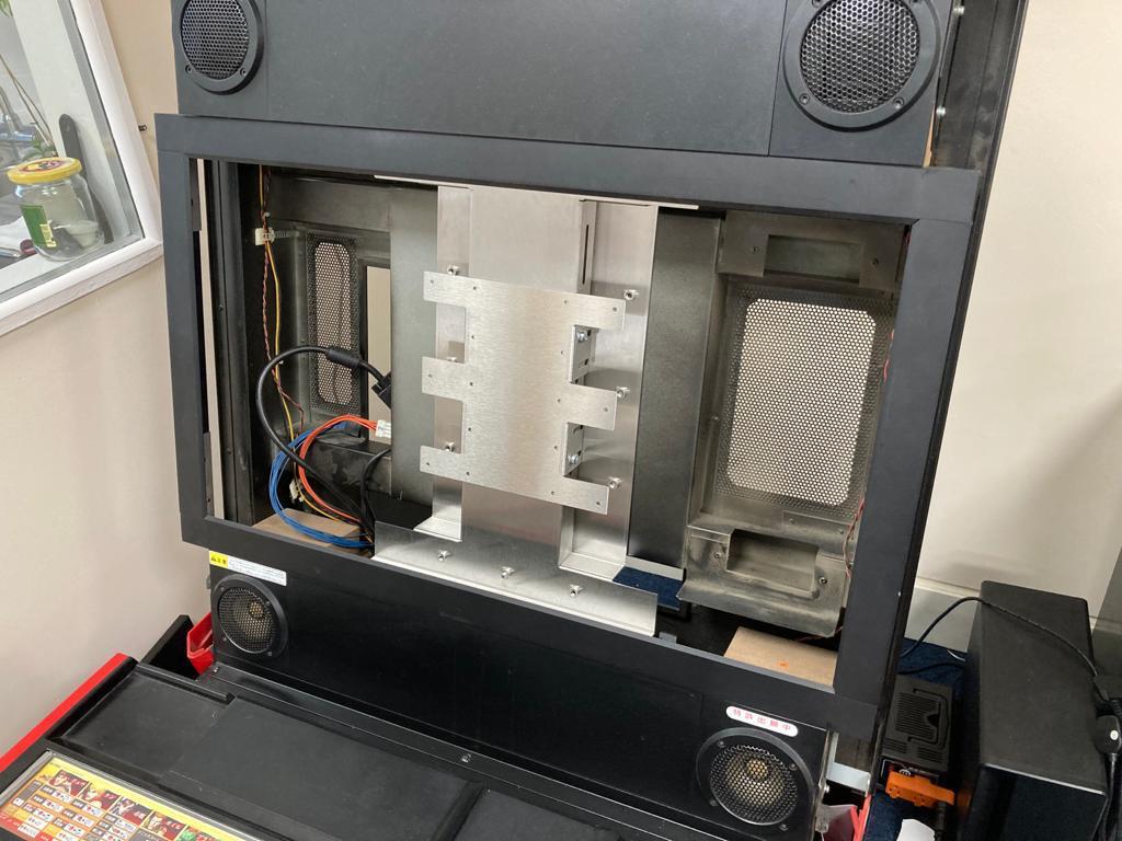

Finally got round to installing mine, nice and easy to do 8)

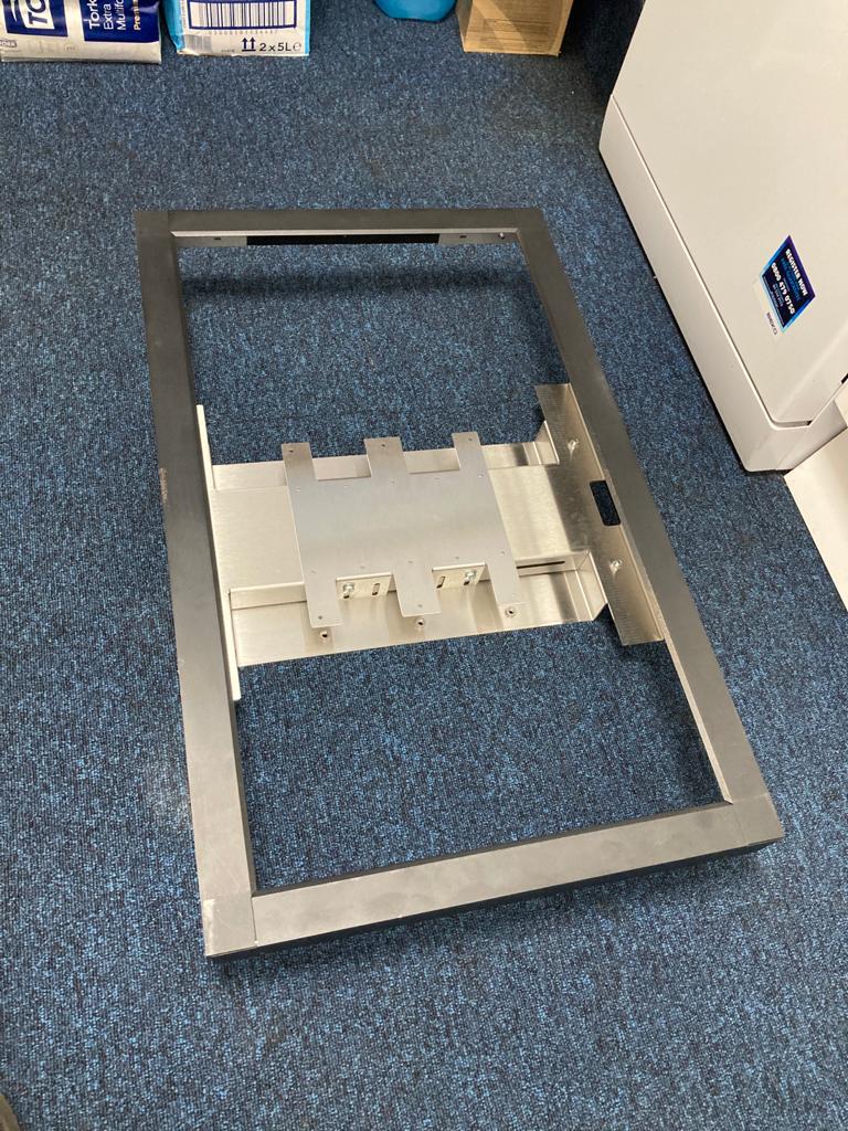

Thanks for this @Hadouken Arcade it great to have a bracket that doesn't require any modifications to the Vewlix, in order to future proof it in the event of a monitor failure. (I didn't mod the monitor frame either, I decided to get some 3mm screws to avoid having to drill out)
A couple of tests fits whilst I was waiting for the monitor to get delivered:

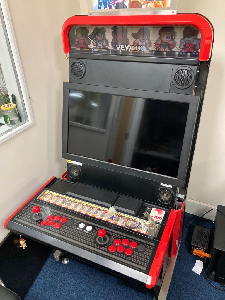

And all done! :thumbsup:
I bought a 32ML600M and 32MP58HQ (there was a 20% off sale on ebay at the time :D )
In a side by side test on my desk, I didn't see a preference, so I put the 32MP58HQ in the Vewlix, and am using the 32ML600M as PC monitor

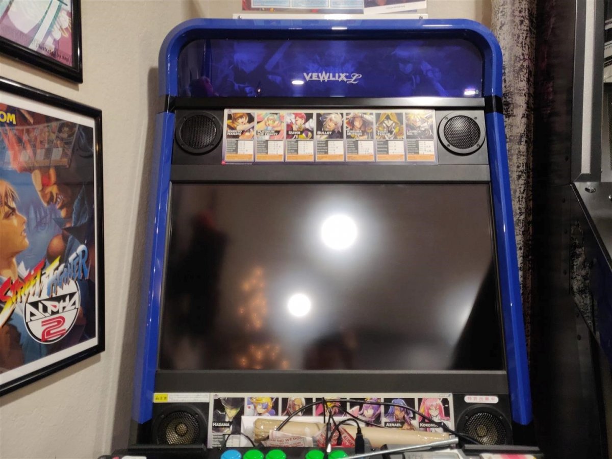

Got the kit and finished it up yesterday for my Vewlix L , worked out very nicely, just like wigsplitta, I just bought a 3mm screw and washer+nut kit and used the original metal casing and it held up perfectly. Didn't need to do any drilling to fit the 4mm screws. I left the glass intact on the metal frame, no issues with slamming hands on screen.
Edit:
This was Rev C of the mount and I used 32ML600M-B monitor
