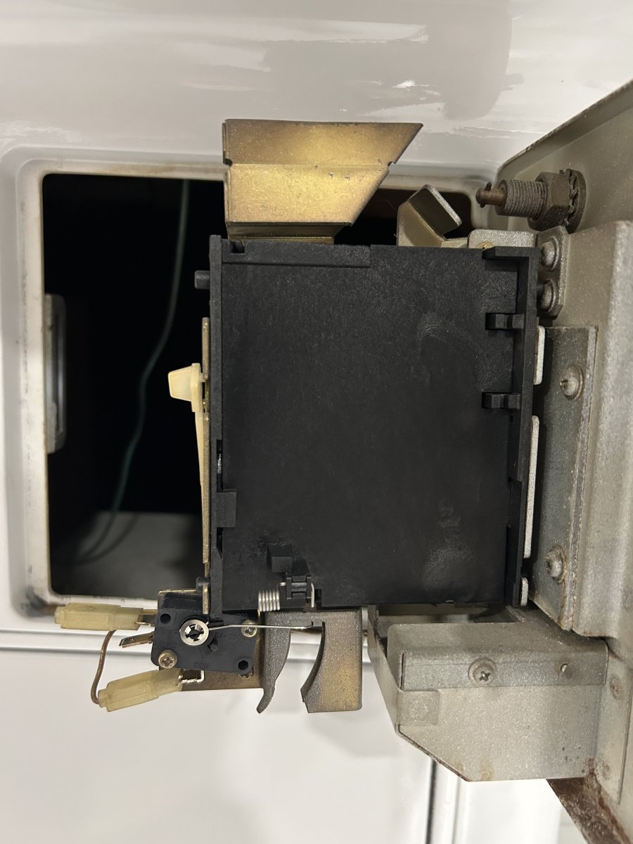

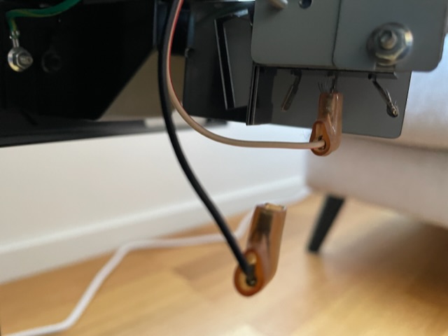

In my case…
AWSD:
2x Astros (non stock microswitches, I replaced recently because coins sometimes got stuck)

@gamezer0 - Thank you too. Your AWSD is the same as the other one I've seen so that's good news. My kits should fit your modded NAC ones too so no problem there.

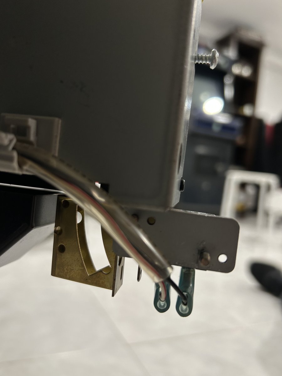

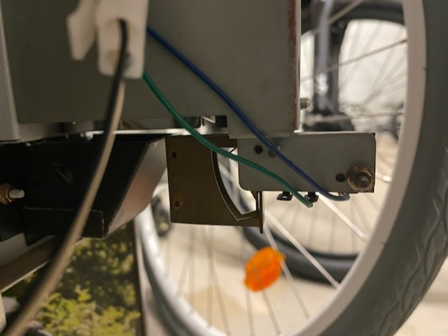

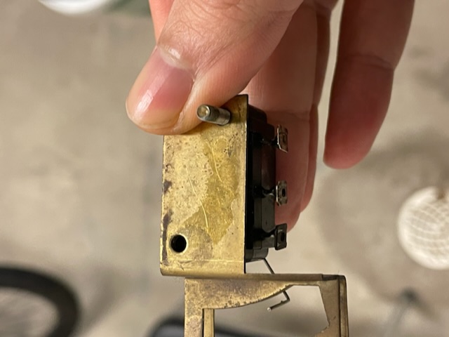

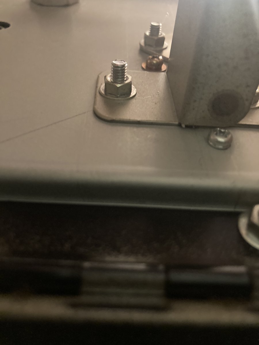

Another E2 pic that's in-line with others:

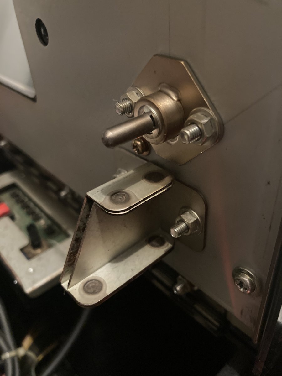

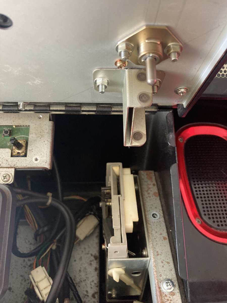

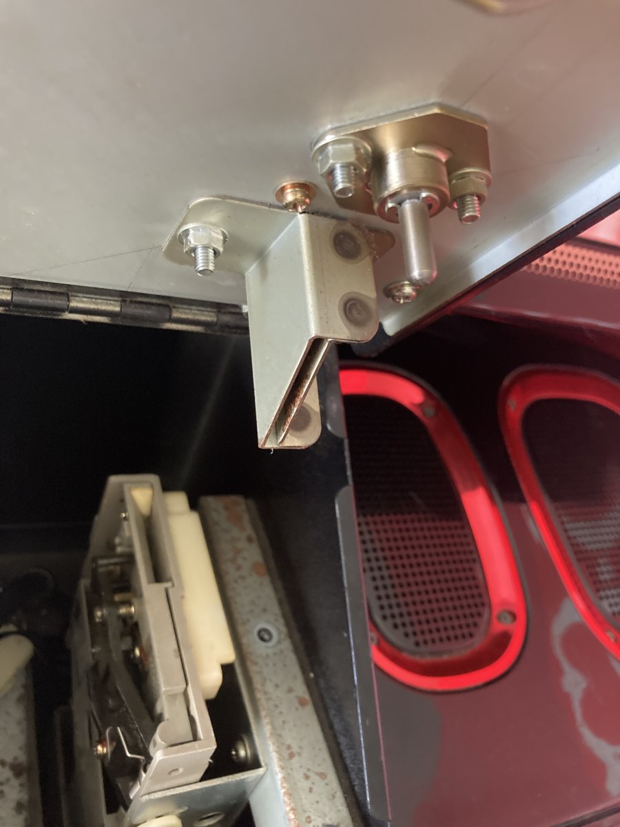

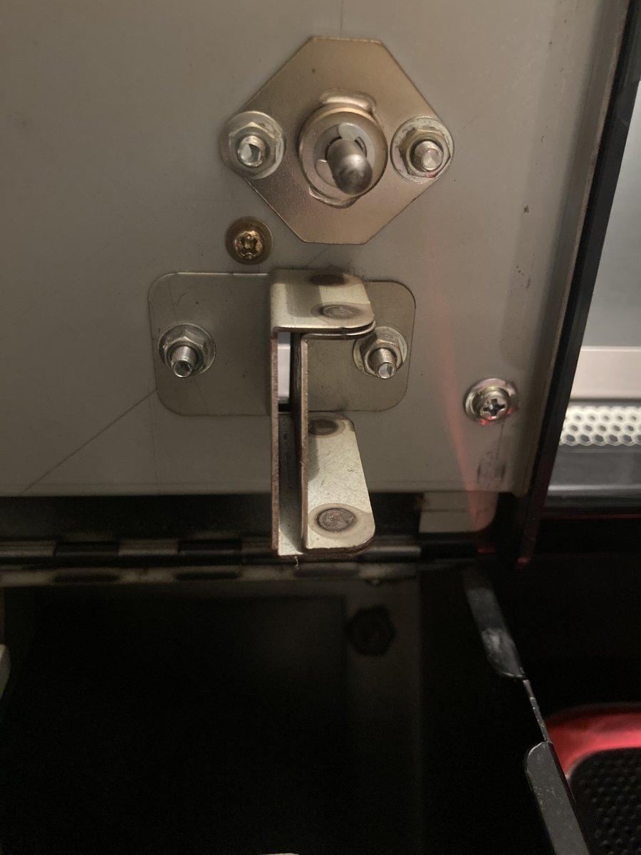

Also, as requested, some more pics of the Noir -- for note, this button is situated on the top console -- the wiring would been to be routed differently to other solutions alongside cable allowances for the panel to open and close:

If you have a digital caliper or something it would be handy to check, should be 4.8x0.5mm, don't worry if you can't though.
@djsheep - Thanks for the e2 pic. I think I'm good for E2 pictures now, they all look to be the same which is great.
In regards to the Noir - if possible, I'm after pictures of the assembly that the button in your picture presses/actuates. If it's hard to get pictures with it in situ, is there a sub assembly that you can take out of the cabinet? I had a look for Noir manuals but the only one I found didn't have much detail.

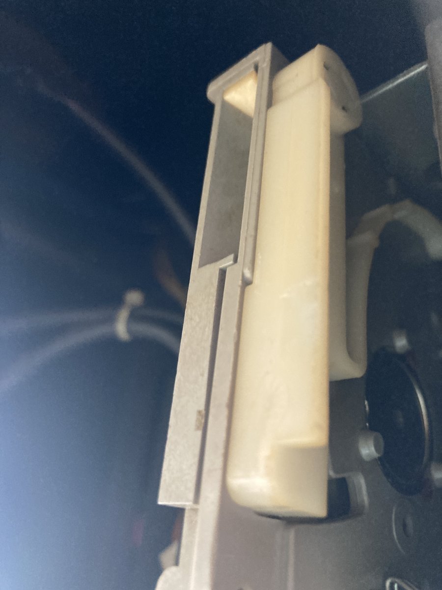

It hits directly the eject switch on the mech. Hope this helps. Down to take more photos / take measurements if needed.

@djsheep - thanks for the extra photos. I'll need a couple more and some more information. I'll shoot you a PM to continue discussion. :thumbup:

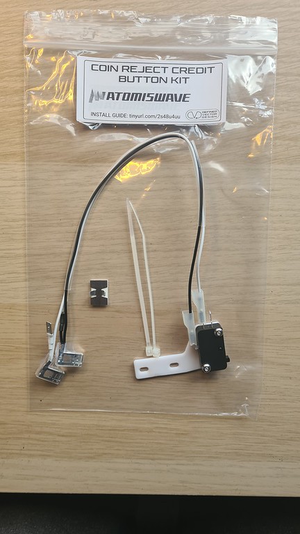

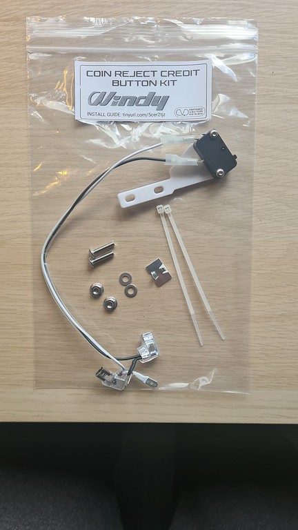

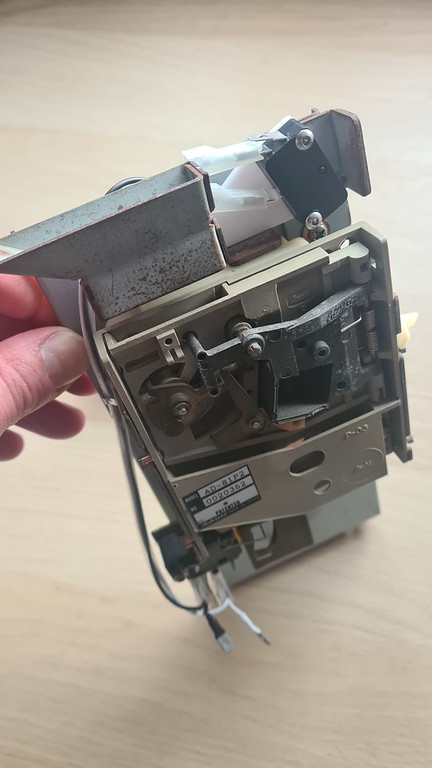

I've got all the parts in to make the first batch and I have some more on order. I've updated the OP with some additional pictures/info and I'll paste it again here for anyone reading the last posts:
Vewlix example below. See further down the post for other cabinets
All of the kits have adjustment built in so you can fit the microswitch in the optimum position. It should be fitted so that the microswitch is actuated right at the end of the reject button travel.
The kit consists of a 3D printed mount, a fitted microswitch, wiring loom including piggy back connectors, a self adhesive aluminum cable clip and a couple of cable ties for additional cable management. If any additional nuts/bolts etc are required then these are also included.
The kits are easy to fit but there is a URL printed on the label that will take to a fitting guide for each version (currently WIP)
Check the spoilers below for pictures of the kits:
Taito
*Egret 2/3
*Vewlix
Sega
*Aero City
*Blast City
*Astro City/Astro City 2/New Astro City
*PRas3
^WIP
Atomiswave
*AWSD
Konami
*Windy / II

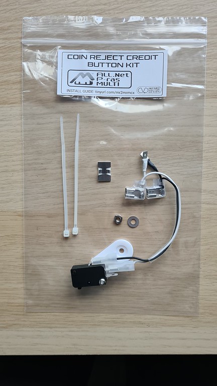

PRas3 added:
I should be in a position to start shipping some of these this week. For a start I'm going to send them out to some of the UK guys to install/test as it will be much easier to rectify anything domestically should I need too. There's also been a ['cyber incident'] at Royal Mail over the last few weeks which stopped international shipping completely. It sounds like some international services are now running but not all. Sending some of the UK ones out first should hopefully give time for all the options to be available again and clear what I imagine is a big backlog of parcels.
