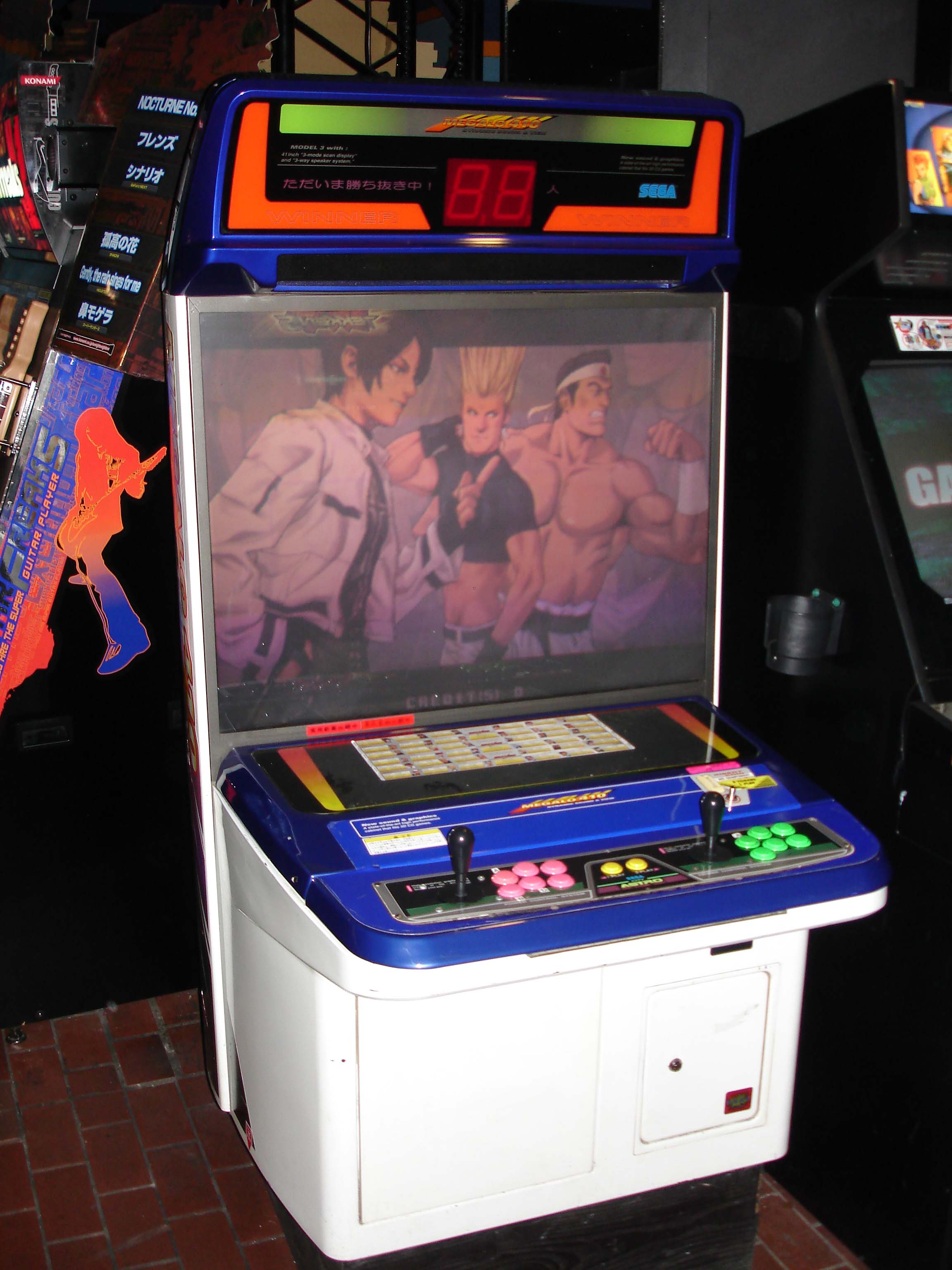

I finally got Virtual On Oratorio Tangram up and running on my USA OMG Twin unit. Looking through the service options i noticed that it supports the "billboard" win counter on Versus City and Blast City cabinets... I'd be interested in maybe building my own bilboard/win counter into my Twin unit setup but I'm finding it extremely difficult to find information about this..
If you're unfamiliar this is what they look like, there's a "Winner" lamp as well as a 2-digit counter to show how may wins the player has.
Versus City Version:
New Versus City version:
Blast City Version:
Megalo 410 version:

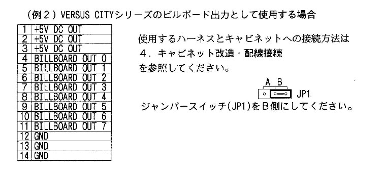

doing more digging into this it seems that the Sega JVS to JAMMA I/O board supports "vs billboard" output:
http://wiki.arcadeotaku.com/images/9/97/SEGA_cabinet_JVS_conversion_manual_.pdf
according to that on page 5 when JP1 is set to position B the kick-harness connector is used for billboard output instead.

So last night I hooked up my Sega JVS to JAMMA I/O and ran Virtua Tennis 2. I have a DSO Nano Oscilloscope so I went around probing the output pins and while I didn't get too much concrete information I did learn a few things.
The pin out is attached below (pay attension to the pin numbering, it's numbered as if the JAMMA connector is pointing AWAY from you which is counter intuitive IMO).
I should note that I'm using a Rev B JVS to JAMMA I/O, everywhere else I've read about this has stated that only the Rev A supports output, but that's BS because I'm definitely getting data out when I activate the billboard test.
In any case the output test allows me to output to "1P side" or "2P side" leading to the idea that a single PCB can support two separate billboards. I discovered that output pin 6 is low 100% of the time when outputting to 1P side and has some activity but stays high about 80% of the time when outputting to 2P side. This leads a lot of credence to the selector/data pins theory. pin 7 or pin 1 MAY be the digit selector the activity on those pins is fairly uniform and predicable, though it doesn't seem to change states as quickly as one might assume is necessary to select the digit.
Activity on all of the pins is really slow. they switch between high and low and you can usually count in seconds the amount of time before they change states. so I believe the pins only output data when they need to change the state of the display.
At this point I've got output working and confirmed it's slow enough to read with a Arduino so the next step is building something that can dump these outputs into something I see so I can try to make sense all the pins within the context of each other (since my scope only has 1 channel).

note: I'm not sure about bits to pins wiring, most likely it is reversed like in inputs, i.e. most significant bit(s) is lowest numbered pin(s)
I can take logs from NAOMI Virtua Tennis 2 tesmode, if anyone wish to try figureout bits functions.

based on what you posted and what I'm seeing from the outputs I can confirm that the left most bit is pin 0 and the right most is pin 7. Also the pins output is +5V for a binary 0 and ground for a binary 1.

this is good in that we've figured out the basic command structure. however this is bad in that we likely wont be able to extrapolate many more commands without capturing similar examples or access to the hardware where we can issue every possible command and see the output.
basically it seems as though the last 3 bits select what is being changed
x111 -> P1 Digit 2
x011 -> P1 Digit 1
x101 -> P2 Digit 2
x001 -> P2 Digit 1
x110 -> Winner Lamp (both players)
the first 5 bits determine what is being set
0000 0xxx -> clear digit
1111 1xxx -> "0"
0111 1xxx -> "1"
there doesn't seem to be a discernible pattern from which we could extrapolate additional letters, but maybe there would be if we inverted or reversed the binary string? I haven't got that far yet.
EDIT: The first 5 bits reversed AND inverted gives us this:
11111 blank
01010 A
01001 9
01000 8
00111 7
00110 6
00101 5
00100 4
00011 3
00010 2
00001 1
00000 0
we could potentially extrapolate up the alphabet but it's still impossible to say if that's correct without being able to test on a real billboard PCB.
the problem is that there is not enough space within 5-bits to extrapolate the entire alphabet... following the pattern of 0-A you'd get up to V which would occupy the same code as blank. this means that either not all letters are supported or the method for displaying them doesn't follow the above pattern.
If i had access to a real PCB I would simply run through all 256 potential output combinations and saw what came out the other side.
