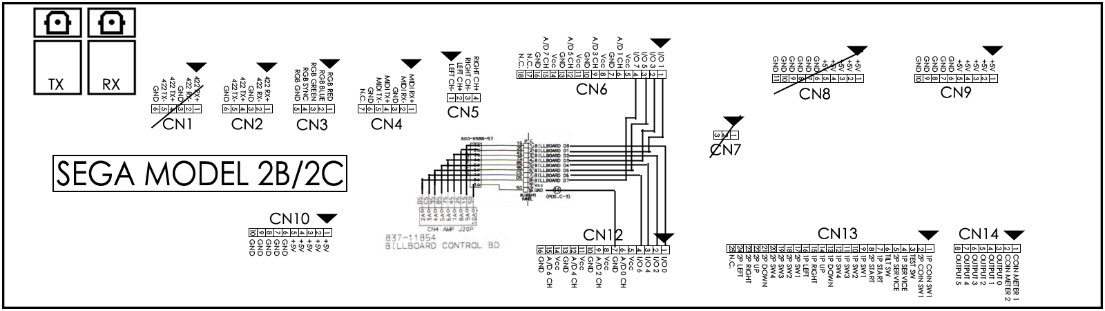

So I'm at the point where I wish to connect my billboard unit to my Model2b board. I have taken your vectored Model2b/c filterboard and shoved the parts of the Versus City schematic that show the Billboard's CN4 connection, all 9 wires. I am assuming the the Billboard's D#s correspond with the I/O#s on the filterboard, if I read your blog post correctly. Then GND can connect to either GND on CN6 or CN12.
Alright, so everything's connected as it should be according to the diagram I drew up. And it... sort of... works?
I am unsure if because my EPROM set of Fighting Vipers is a US and not JP or EXPORT (even though I've changed settings to those yielding no difference), but the billboard system isn't working quite right. Sometimes it's (P1) " . ." (P2) " . .", other times it's (P1) "0.0." (P2) "0.0.".... the Output Test in the service menu doesn't help either. Sometimes, and only sometimes, the P1 7-SEG self test will work, but the P2 7-SEG self test will just display "0. ."

I've never run on Fighting Vipers but the animation you're seeing on P1 looks correct for a lot of the test modes I've seen. This to me means that your wiring from the Model 3 to your billboard control PCB is probably correct and the wiring from the billboard control PCB to the P1 display is correct.
I'd start by checking the wiring to the P2 display. and if that is correct, maybe even swap the displays to confirm it's not the display itself.
it's also possible that Fighting Vipers test mode doesn't work right, a good way to test this would be to enable the player bit on the input connector, this sets which side is P1 and P2 and should cause the outputs to swap... that's a good way to confirm where the problem is.

yeah, don't do that. swapping the filter board connectors is just going to scramble the data going into billboard PCB so you can expect garbage output.

Based on what you've posted here and the video you posted earlier it sounds like your billboard PCB is 100% working and you have a configuration issue either with the dips or the input (or both).
you might want to also confirm that the dip switches on your board are good and actually holding the value that you've set. I've replaced TONS of old sega dip-switches on my own billboard pcb and on other old Sega PCBs as the original ones they used were trash.
