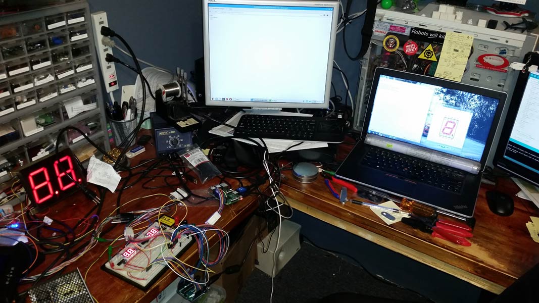

Here's a pic of my setup:
15V Meanwell PSU in the lower left the arduino hanging below the desk and outputting to it's billboard on the bread board above, the arduino is hooked up to my laptop which has a serial monitor up that dumps out comments as the code runs so I can keep track of how it's processing the commands.
The Pi3 is on the desk to the right of the bread board and is running the keyboard and monitor in the center of the screen, I can punch in commands or command sequences on the keyboard and the Pi outputs it the same way a game PCB outputs billboard commands.
the big mess of wires is because the pi output, as well as the arduino input and the real billboard input are all tied together on the breadboard.

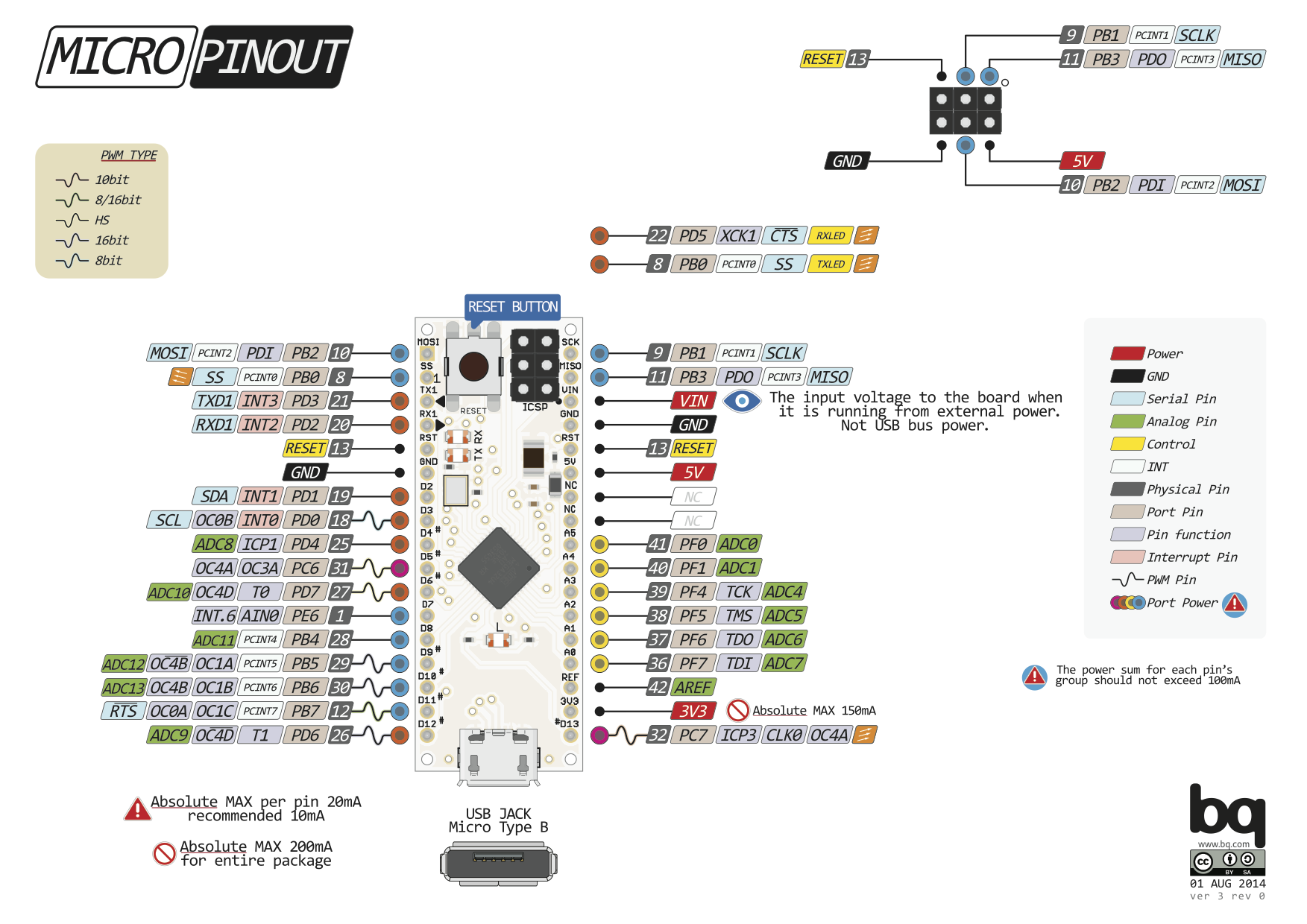

looking at pinouts I might actually consider the Arduino Micro:
the pins are all over the place but it looks like I might have access to all of port B, and it still has enough pins left over to control the 7 segment displays, winner lamps (8 outputs total) and have a few jumper/dip switch inputs.

After some further investigation it looks like the Arduino Micro actually uses a slightly better chip than the Uno (ATmega32U4 vs ATmega328P). the major difference is that the 32U4 in the micro has native USB support and no native serial support while the 238P has native serial support but no native USB support. if you're buying the Atmel chips alone the then 32U4 is more expensive, but the Micro is cheaper than the Uno because it requires an additional FTDI chip for the USB interface.
This also means I wont be wasting 2 IO pins for USB debugging. Seems like a winner all the way round.

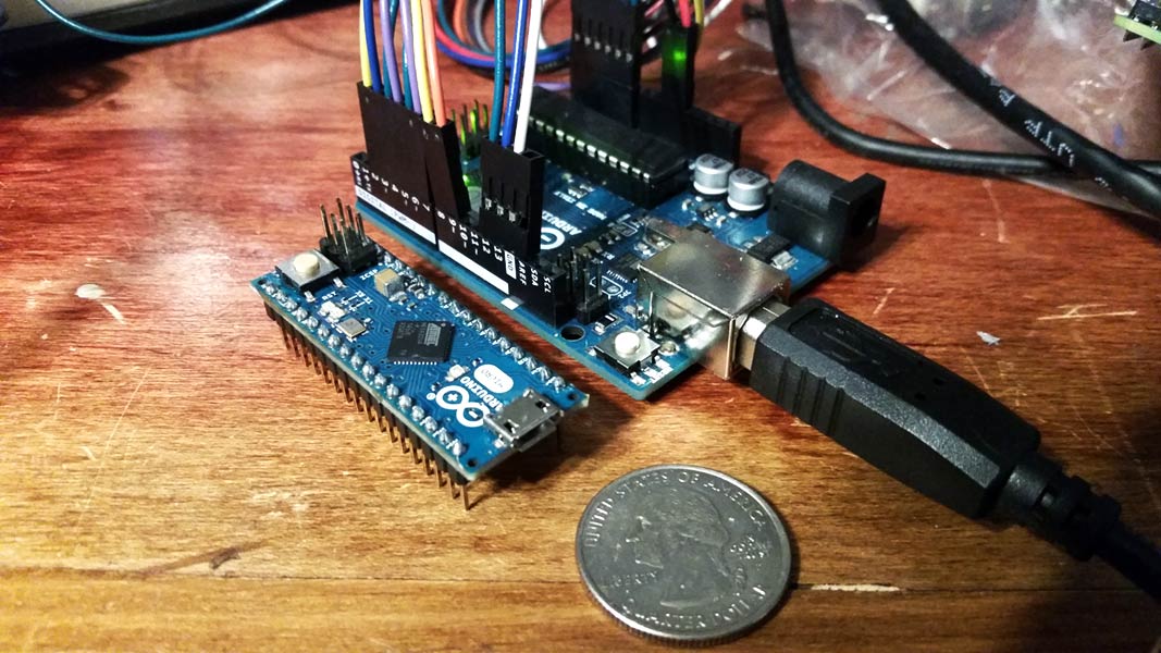

Got the Micro in today... so far I like it!
way more compact. my Uno code compiles for it without any modification and there seems to be more memory space on the micro too!
I haven't tried running the program on it yet as I'll have to re-do all my wiring but so far so good :)
I'm thinking from here forward I'll be buying these instead of the Uno.
