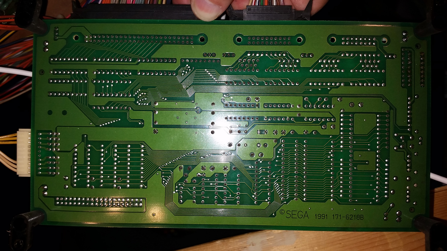

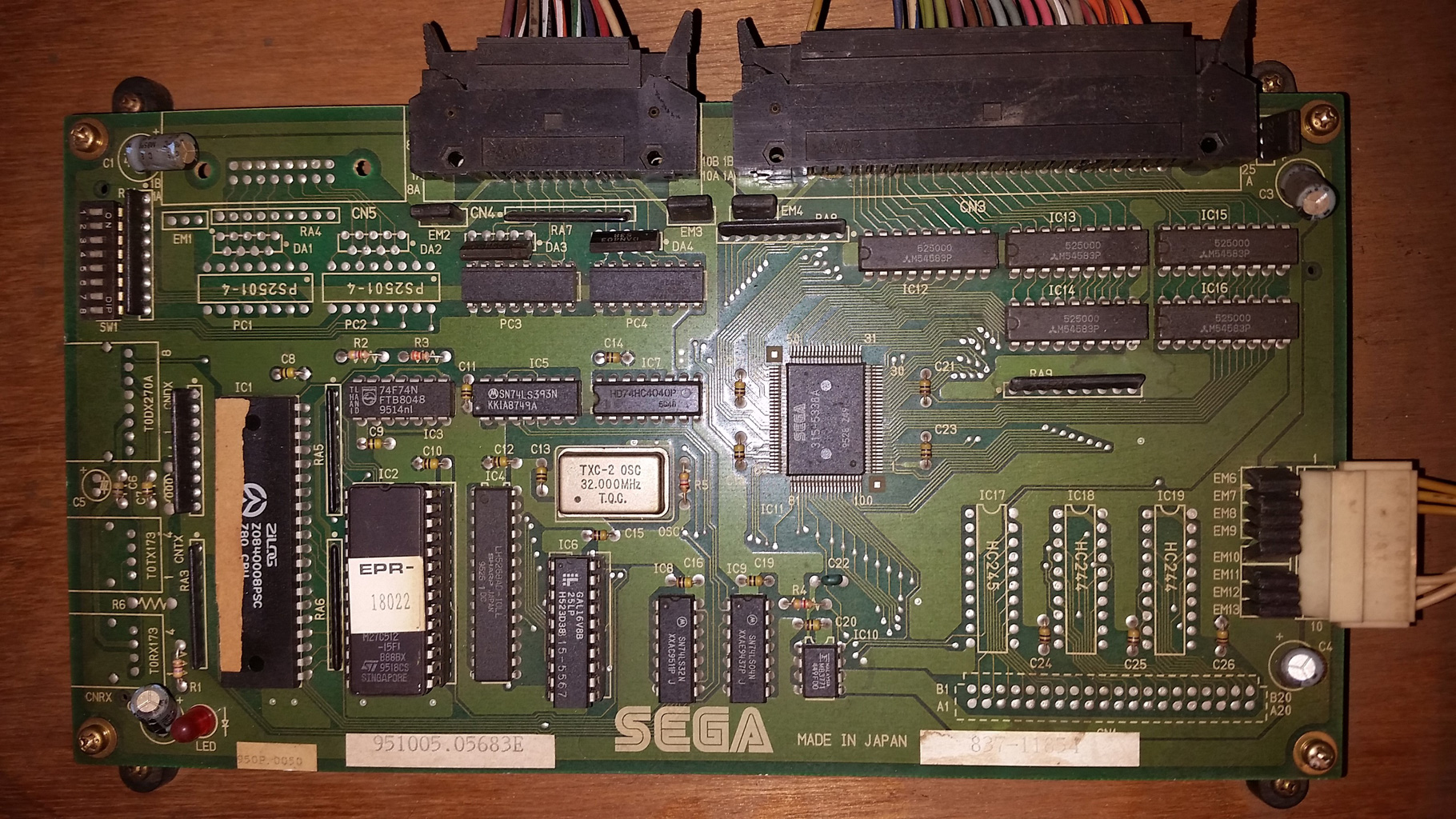

I got the PCBs in!
For anyone that is interested here are some good photos of the front and back of the PCB:
for those components that are difficult to read:
DA3= DAN403 | 538
DA4= DAN403 | 538
PC3= NEC Japan | PS2501-4 | ND529
PC4= NEC Japan | PS2501-4 | ND529
IC7= HD74HC4040P | 5C46
There is a dump of that eprom earlier in this thread. the Sega Custom looks to be an I/O chip that is also used on the ST-V
as for the GAL. I wouldn't mind loaning it to someone who is able to dump it.

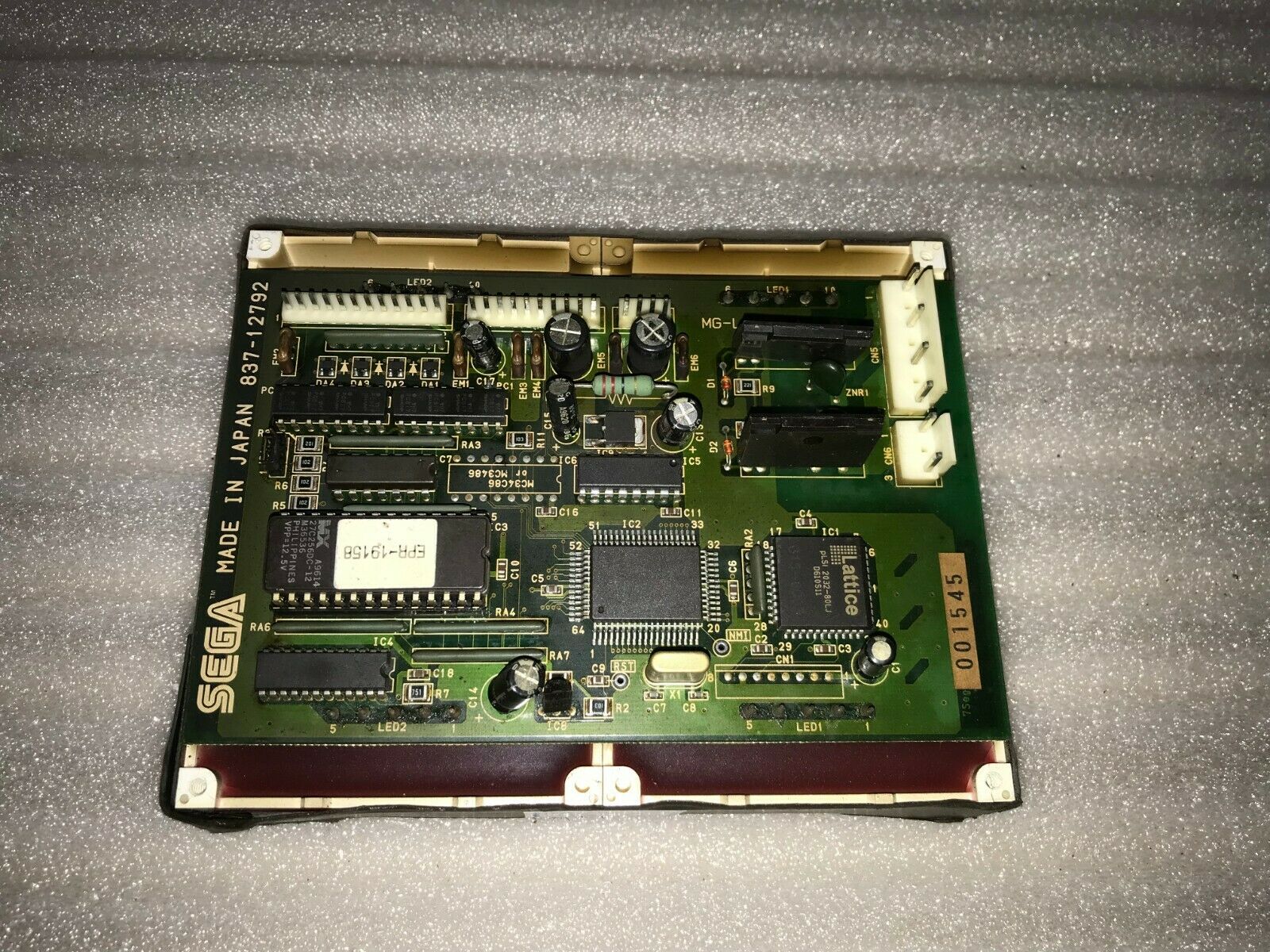

For reference here is what the NVC Billboard display backs should look like:
P1 side:
P2 side:
Notice that the P1 side is nearly identical to Blast City's module, except it has an extra output connector. This connector goes over to the P2 side, which is a stripped down version of the module that can only be controlled by the P1 side display.
