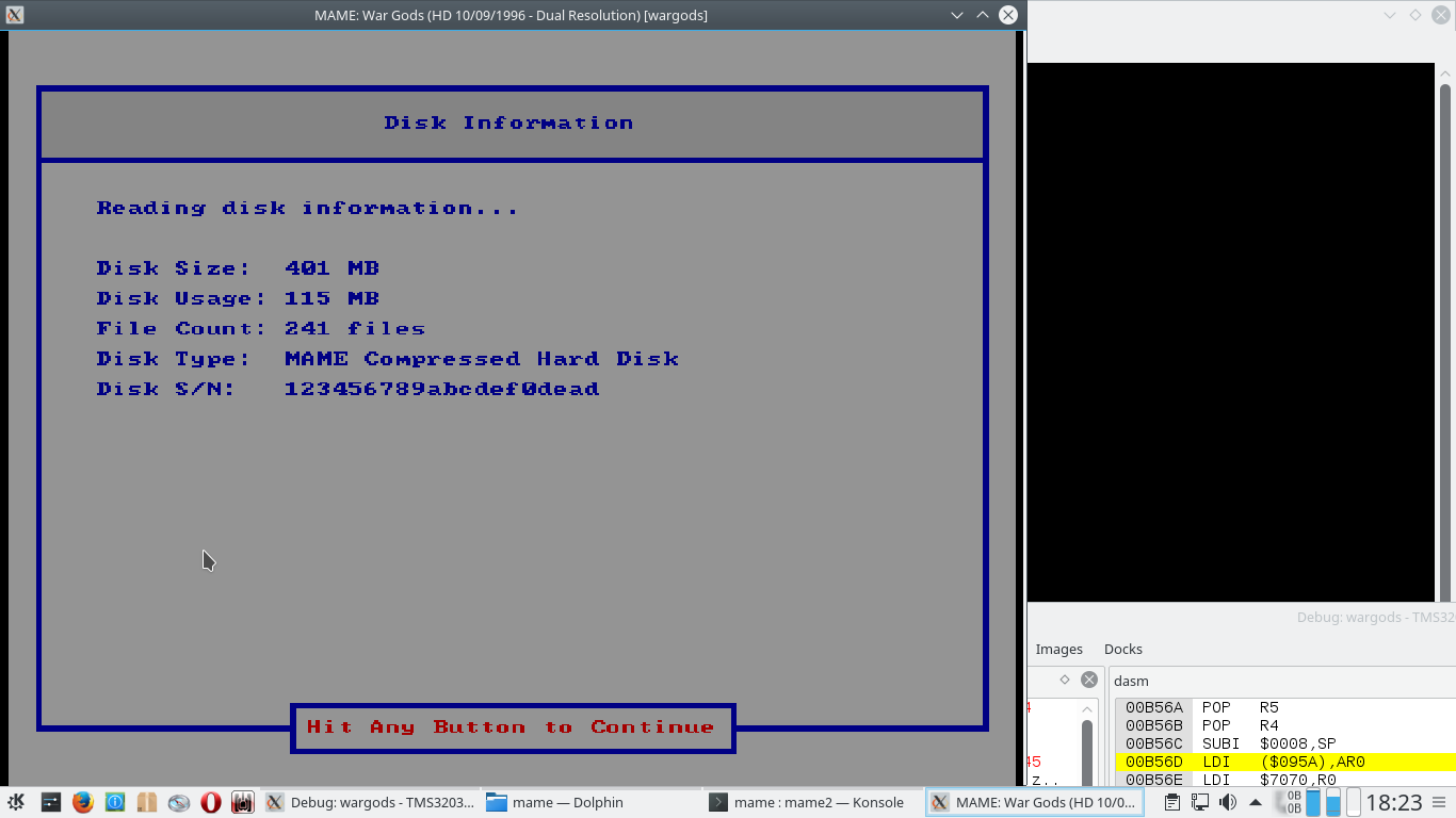

stj
May 4, 2017
870
278
England
so i took a look,
it's not checking the make or size of the drive, only part of the serial number.
now here is a problem.
i need to make it fail, but i just cant see where mame is providing the serial from.
i'm sure it's not in the chd, but i dont see it in the driver!

It's in the extended CHD info i guess. So not the data itself, but in the data added when the disk was dumped by MAME.
When Wargods queries the drive, that data is fed back.
I guess the easiest way at this point is write the CHD to a different disk, then re-image it?
Also other tricks to make it fail, read some data from ROM which you know is wrong, instead of data from the disk :)
ROM Area holds most required items.

not so fast, mame identifies the serial number as 00000000000000000000

Modify the address :)
From the other topic, the leading zeroes are the key here. Usually you can edit the data as it is read into ram. Pseudo-code since i didn't look at it:
load data into d0
put d0 at A5+1000 (0x501000)
debugger to set breakpoint here
Select this region in mame/maincpu (one of these is editable by hand.
edit the zeroes to 01020304050 whatever :)
g
watch it fail.
Do you have the addy where it does the read/check?

check is in the 3100 area,
i had a breakpoint at 3114 that i think was just before the drive stuff.

well, i changed the serial and it still works.
so maybe the bootrom in mame is not protected!
