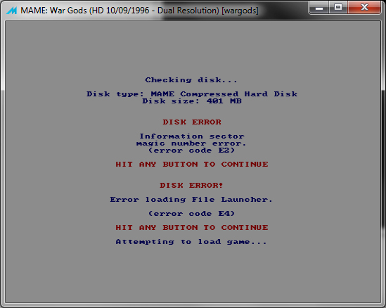

I had taken a look at War Gods in the past given my success patching other Midway games. It was being discussed on 'The Dumping Union' mailing list, and the original poster provided details the War Gods actually checks the drive parameters, not by serial or ataid.
Here is what I found looking into it at the time:
Doesn't look like it will be a simple patch
Get this error when loading an empty chd formatted to expected geometry:
Clearly it looks for information off the disk before booting. If I create a new CHD with geometry similar to a CF drive, it is able then load the information sector, and boot sector and indicates it is loading the game
But after it starts loading, this is when the checks start to kick in. I tried patching the differences between successful and failed boot, tweaking registers and pc to match a successful boot.... but no dice. Not exactly sure what the code is doing as Im not familiar with this instruction set

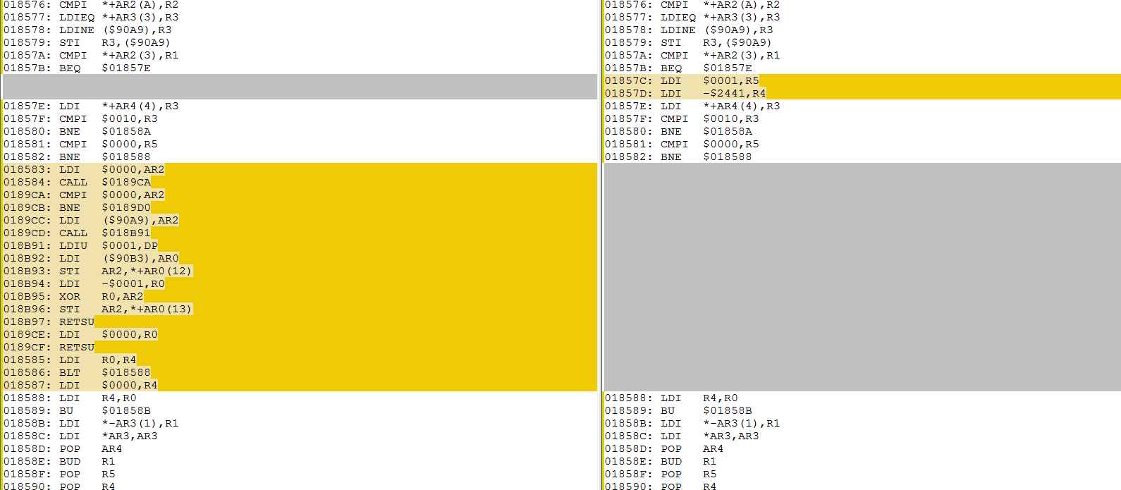

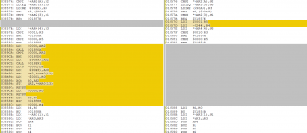

Here is where the first differences occur in execution, (original chd vs modified chd)
Perhaps someone else can take a shot? I attached the success/fail trace logs, so you can see where the fail jumps into oblivion

@brizzo Did you try to patch as follows yet?
1857B BNE $01857C
18582 BNE $018583
189CB is a candidate to BNE as well, but i am not sure what the code is doing at this point.
CMP * = compare stuff
BNE is Branch when Not Equal to $address
BEQ is Branch when Equal to $address
I am assuming the screenshot on the left is the proper, working one.
The right side does a compare, and then branches since the compare function fails.
I hope it is not loading the text at this point (to display failed check text), but i cannot tell.
From the code it would seem it compares the 3rd element in "AR4" but i have no idea what's in there, or what it is compared against. R1 is holding a value at this point, but i cannot see what is loaded into it.
I would need to look at the code running in mame, maybe later tonight.. i have Photoplay hdd's to make/dump :)
I played around with trying to bypass the check for about 30 min over a year ago, so don't recall exactly what I tried -- but I seem to recall there was many different checks if ended up following.
Typically I use the MAME debugger and just set conditional breakpoints that change variables (registers, pc, etc), instead of actual op code patching.
But it is also much easier to analyse using disassembler like IDA to review code execution path and get a bigger picture of what this condition check/branch is part of.
