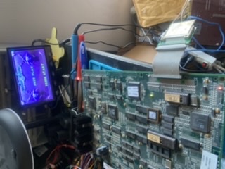

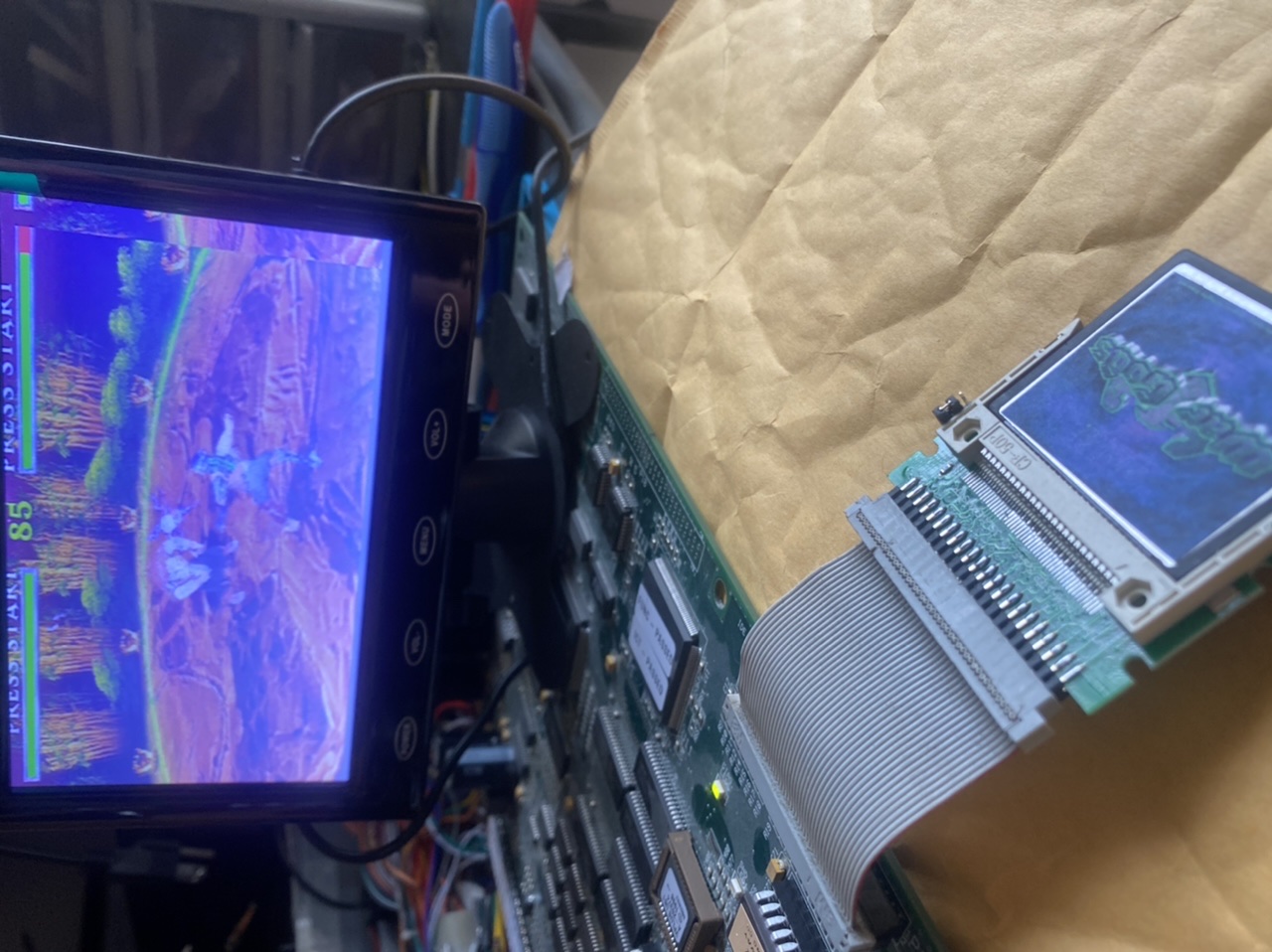

Welp all the thinking on this got me back in the office , I now have a drop in working CF drive for wargods
If anyone wants to buy 1 I’ll start taking names
Price will be 108.00 shipped US. The cards and adapters aren’t as cheap as I wanted , but cheap isn’t always the way to go.
Does not come with ribbon cable card and adapter only, you will need ribbon cable.
