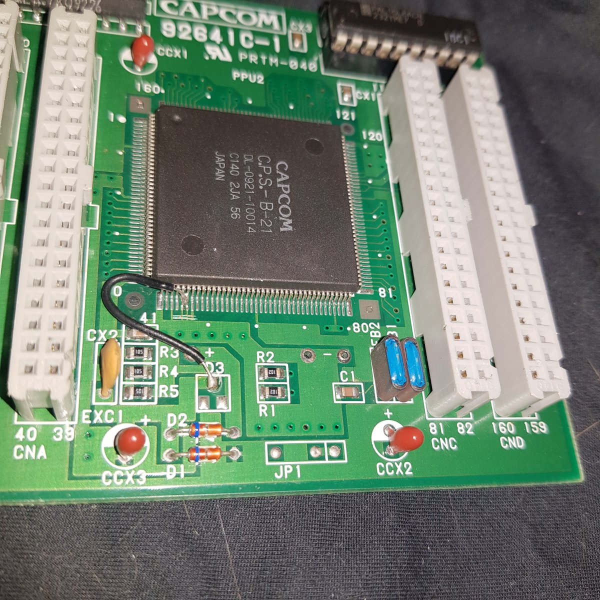

I have a 92641C-1 board that has the trace cut across to pin 47. As I understand it, a fix that can be done is to bridge 45 and 46 to 47 to give them a ground connection again. Is pin 48 also ground? If not, where would I connect these 3 pins to so ground is connected again.

I have a modified 92641-C -- will this work as-is with the decrypted set, or do I need to follow the "In order to modify a C Board that has been patched to work without battery, you need to do the following" instructions?
If it's been modified (has a patch wire) then the mod needs to be reversed before it can be used with the Multi.
