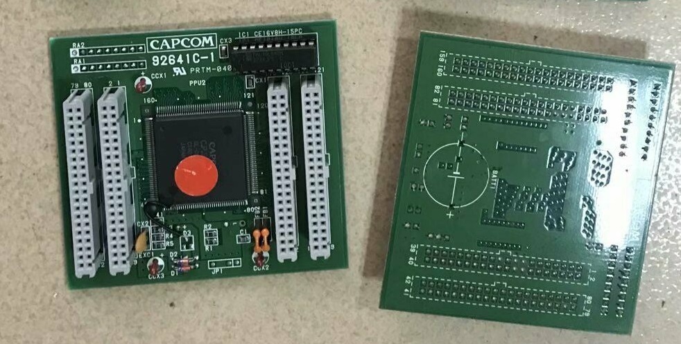

I thought key injection was required for the multi?Thanks for info!
Those are good but will not allow for key injection, so purists, stay away! For the rest of the audience, they will work with the multi.
wouldn't you just need to remove the wire mod?Those are good but will not allow for key injection
You yes, users with little soldering knowledge,would prefer to avoid that.wouldn't you just need to remove the wire mod?Those are good but will not allow for key injection
I am, but I believe that the kit will be release using regular B-21 first.Your still making a fpga solution right? I'm not even keeping my eyes peeled for c boards because I thought I'd be fine.
I suspect it will be more like the CPS2 multi, where we got it without the key writing functionality to start, and then it was a firmware update to include that functionality later.Yikes, if it's anything like the Sega multi I'd be waiting up to a year or more for version 2. Better start looking into the b21
the wire is part of the de-suicide mode.I have a couple of this is it good? What's the wire?
it doesn't have one, and it's not needed as the multi's B-board will have the Kick connector.where is the KH connector?
NOIf I bought the c board for WW. Would it be compatible for the multi?
Q-Sound has nothing to do with the C-Board. but FWIW all Q-Sound CPS1 games use a B-21 Chip from the factory.Bonus. Would it be Q sound compatible with the proper c board as well?
so is it good? Can I remove the wire? Last thing can I update the multi with the fpga to replace the B21?the wire is part of the de-suicide mode.I have a couple of this is it good? What's the wire?
I would not have posted them if they weren't good for use with the multi.so is it good?
if you want to un-do the de-suicide mod you will need to repair 2 traces and repair 2 cut pins on the B-21 chip in addition to removing the wire. it would require some skill to do.Can I remove the wire?
I don't have an answer to that question.can I update the multi with the fpga to replace the B21?
Can we hope a firmware update for original/protected ROMs like on CPS2?twistedsymphony said:In their current form they will not do key-re-writing, which means you will not be able to use original/protected ROMs. They will only work with patched ROMs.
if it's necessary I know one guy can do it for me. Is it?twistedsymphony said:if you want to un-do the de-suicide mod you will need to repair 2 traces and repair 2 cut pins on the B-21 chip in addition to removing the wire. it would require some skill to do.
If I good understanding I must have one for the multi, if it's working I dont see the problem....Do not panic buy CPS-1 things like it's toilet paper during a Pandemic. You might end up with too many B21's and not enough bums to wipe.
we don't know the answer to that question yet.Can we hope a firmware update for original/protected ROMs like on CPS2?
I don't know, you tell me. it's based on your personal preference.if it's necessary I know one guy can do it for me. Is it?
You've answered your own question and justified its purchase then...If I good understanding I must have one for the multi, if it's working I dont see the problem....
