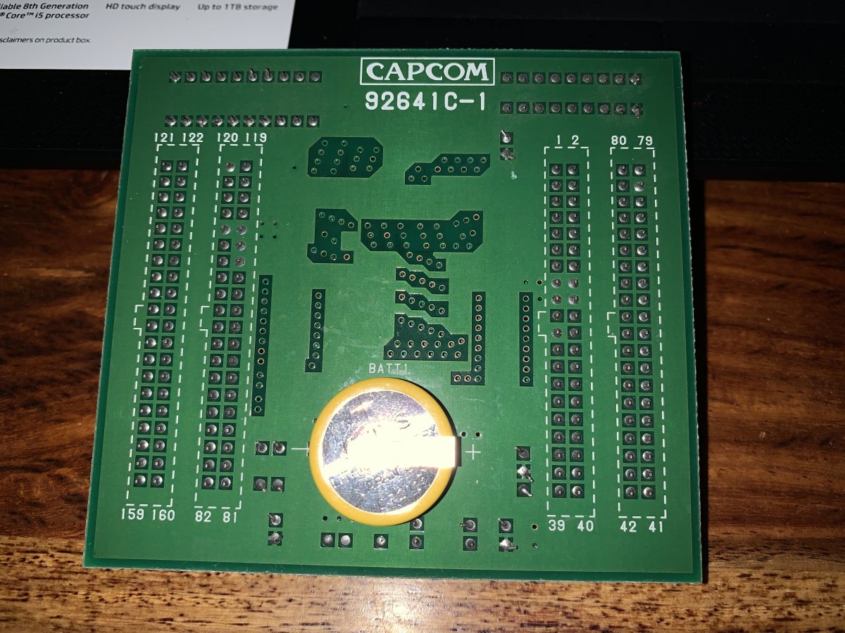

So just remove the battery only?
Yes and you are ready to go!

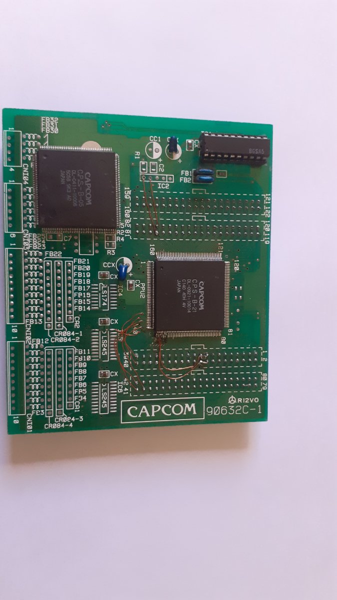

A B-05 and a B-21 on the same C board? And it’s factory?! What is this thing from?
I'm pretty sure the B-05 was the original chip and it's just sitting there in the photo for comparison.
SF2: WW used that C-board and the B-05 but the kick header isn't populated which is weird.
the only other game I know of that used B-05 is 1941 but usually it's on a more compact C-Board PCB.
That board was for Street Fighter2 WW. I removed the kick harness header and related hardware because I needed the PAL socked for the "IOC1" PAL which B-21 requires. Instead of using the original "IOC1" PAL I used the "BGSA5" from the very same CPS2 A board I gutted the B-21 from.
The kick harness enable signal is generated by the "C632" PAL which was what was originally on that PAL socket.
