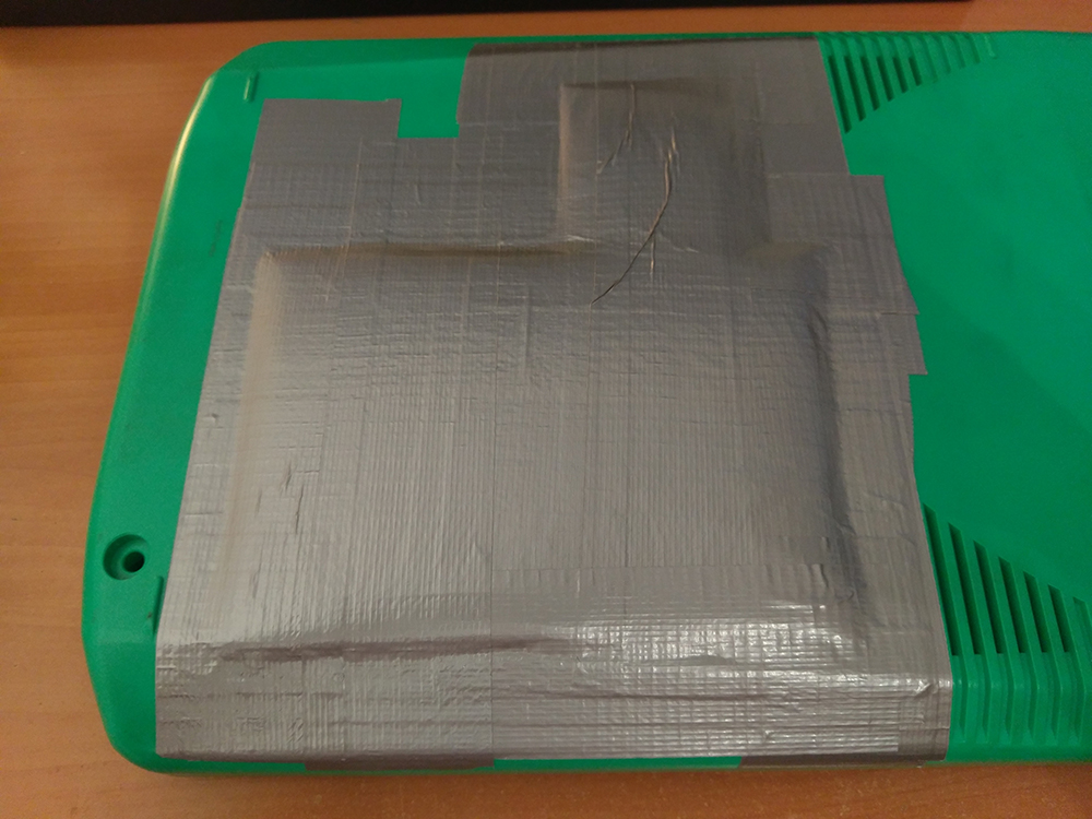

Attached pics below. also a word of caution: attempt at your own risk!
I do this shell cleaning (not pcb) with every new cps2 board arrival once. I put 2~3 paper towel layers on both the game and serial label and tape both over thoroughly. But make sure the paper towel covers both covers enough so no tape sticks to them. Doing this right the labels won't get wet and even when water manages to get trough it will get soaked up by the paper towel layers. Also using cheap duct tape actually does wonders. It sticks and isolates against water enough and removal is quite easy since the whole cleaning only takes minutes. Give the case a good scrub depending on the dirt. I usually do one or two runs with neutral dish soap without any fancy smell. Doing so does not leave any resedue and random flavored smells unlike some soaps would do. I do the first run with just a (obviously unused) paint brush and a second one with a bit rougher brush or sponge if needed. Really depents on the accumulated dirt. I do both runs with just a little water mostly avoiding the taped area and finish everything off with a quick but thorough water rinse. its good to have a good preassure on the water stream to get everything off quickly. After that i dry the taped area first with a towel and peel the tape off to check the labels. I clean the taped over area with a paper towel and IPA. The label itself will not get damaged doing this but you need to be careful as long as the towel is not soaked with IPA but just a little.
Did this with about 20+ shells now. worked for me.
