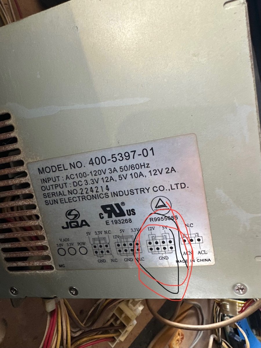

What will eventually replace the SUN PSU for NAOMI NetDimm users?

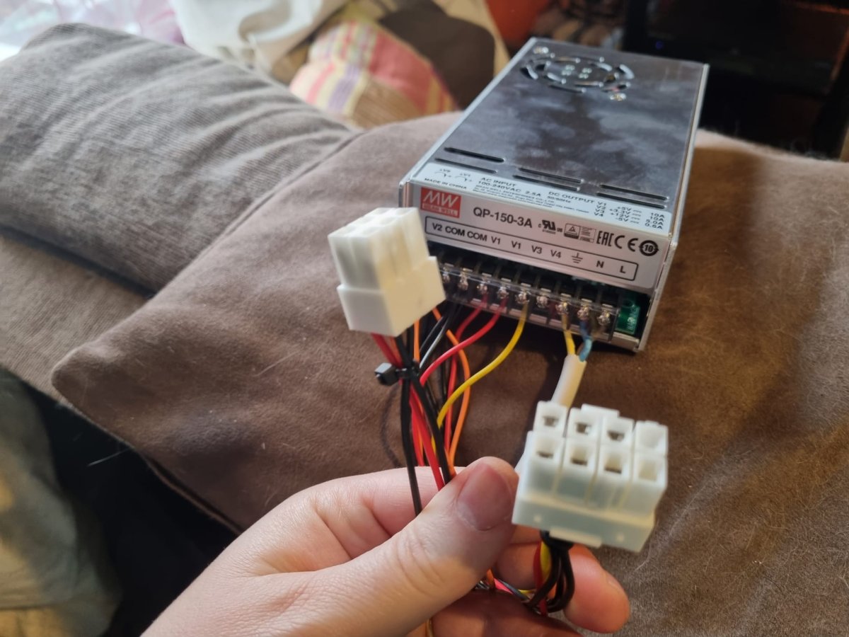

just opened up my qp-150 and am having difficulty adjusting it. admittedly i am a noob.
best i can do seems to be 5v at 5.45 which results in 3v being 3.25 (without load)
i assume this will drop when connected, but does this sound about right?
otherwise when exactly at 5v without load, i get 3.3v at 3.04
It has separate adjustments for +5V (V1) and +3.3V (V2).
Also, don't try to make adjustments without a load connected. Mean Wells do not work correctly without a load.
Gotcha, just didn't want to connect it and have it read high. I can't seem to adjust the +3.3v separately, it will only increase when I increase the 5v. Turning the pot for 3.3v doesn't seem to anything but lower or increase value by 0.01.
That's because you don't have a load on the +3.3V rail.
X/ ahaha
thanks nem, i will give it a go underload and see how i go. appreciate you taking the time to point that out to me, like i said i am a noob :thumbsup:
This goes for basically all arcade / switch mode power supplies. There is a minimum required load for most supplies like this to operate as you said.

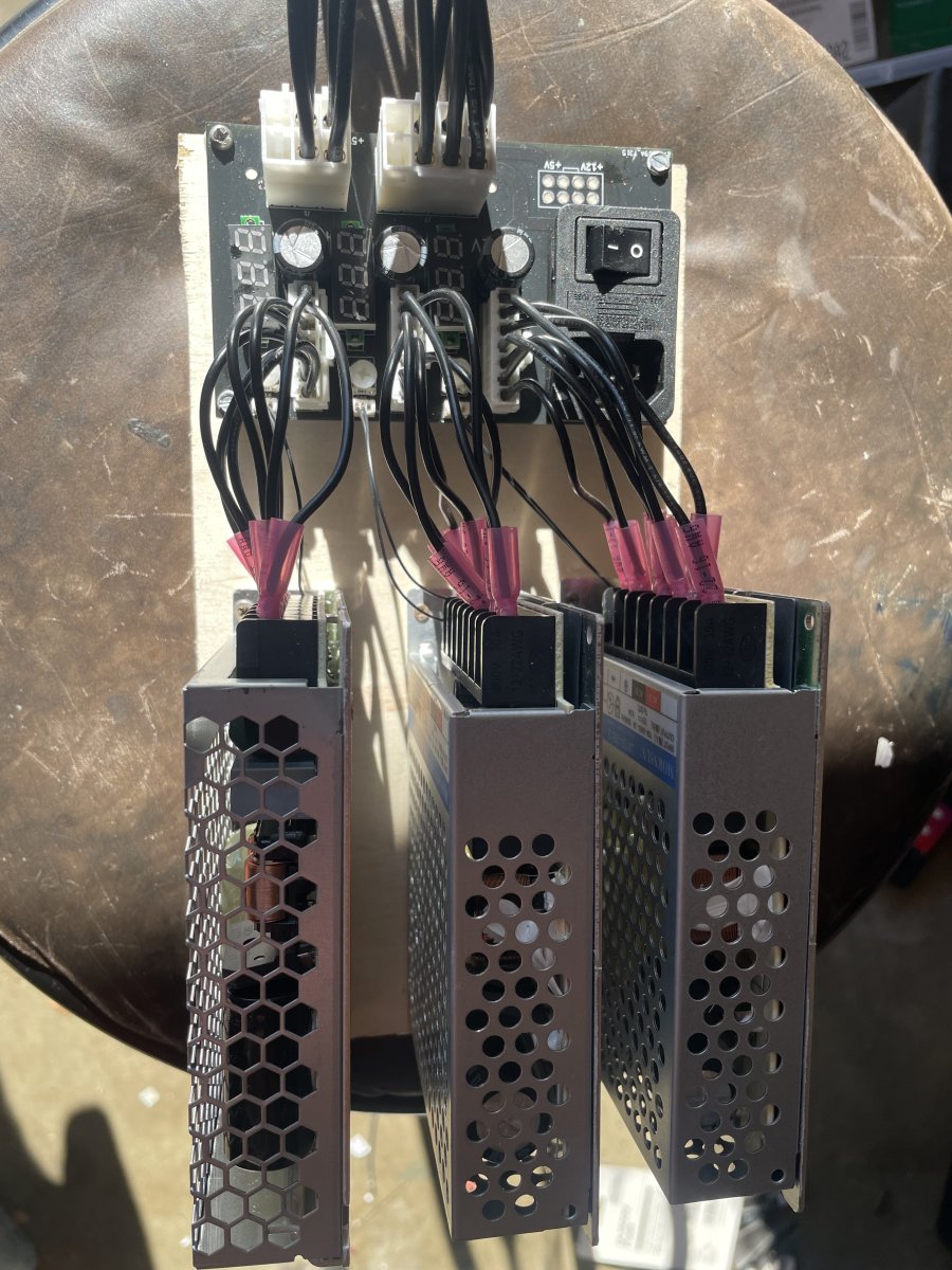

Friend made this. Has all 3 voltages on a different PSU which makes it great for troubleshooting power problems. Also has a place to populate for the gdrom drive power, but I never use that. Costs about $75 to make
