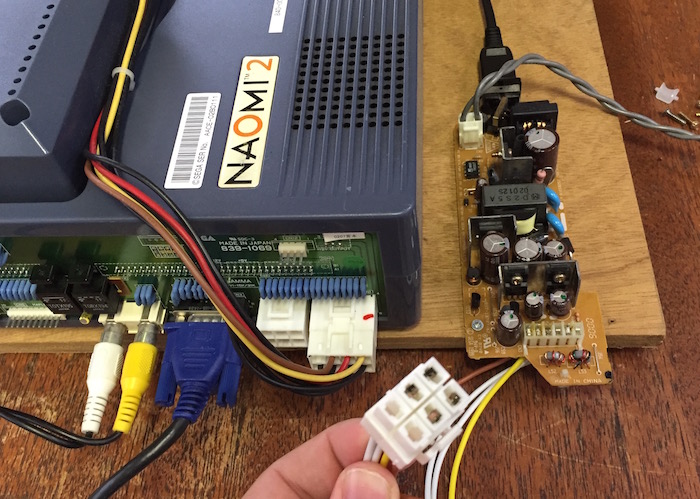

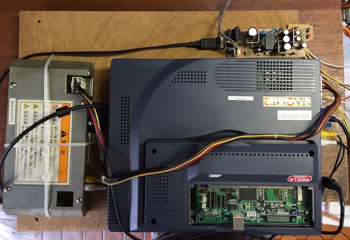

I saw I got a mention. I've been using Dreamcast PSUs for over 10 years now. They're cheap, plentiful, easy to wire up, and ultra-reliable:
can you please show me how to use my spare dreamcast psu with naomi2 ? which adapters do i need please?
Hi @rancor can you break down the wiring details and necessary parts to make this work with Naomi? I have a spare DC Power supply that I would love to utilize here.

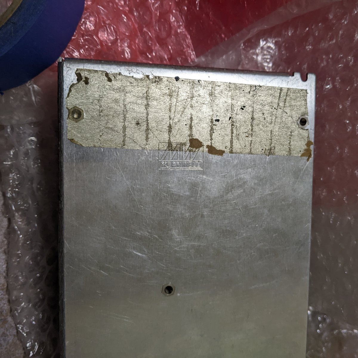

I think the point of the question was to determine the manufacturer of the PSU that Sanwa is selling under their name
Not from Mean Well but @dewmansnk makes a great interface PCB for the Mean Well QP-150-3A making it a drop in replacement for JVS cabinets.
that looks like an interesting solution but that pinout looks like it's Vewlix/AWSD specific not generic JVS, unless there is another board variant I'm not seeing?
Was gonna suggest the same, the QP-150-3A is a nice supply that should cover all your needs in a cab.
Correct. It is built for Sanwa though, you won't find one with a Mean Well badge on it.
As a matter of fact...
...one of mine has Mean Well's logo etched onto the bottom of the case. I have two other ones that don't have any Mean Well markings. This is actually how I came to realize these are just rebadged Mean Well power supplies.
