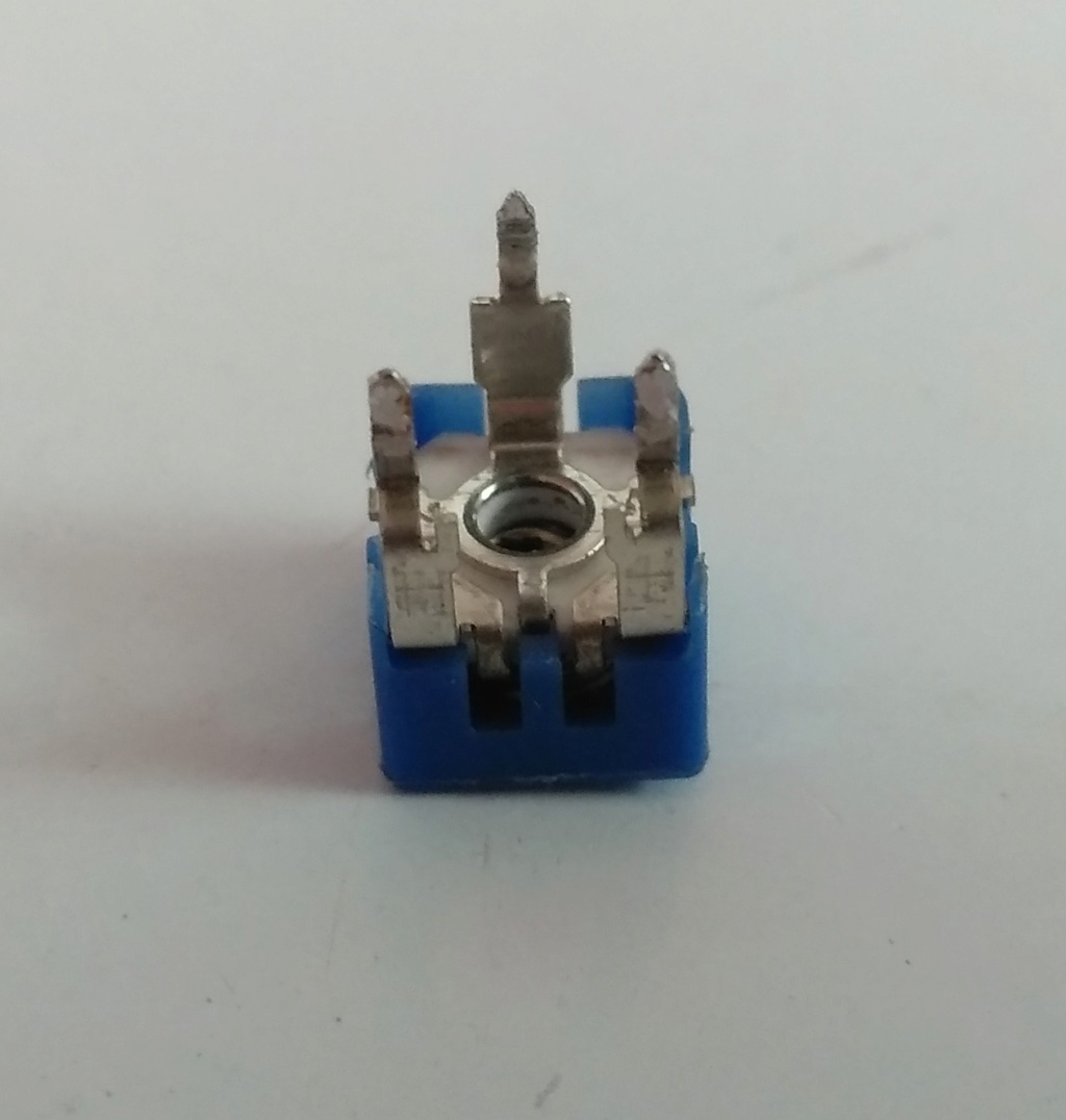

nonosto Champion Joined Jun 5, 2018 Messages 2,019 Reaction score 563 Location FRANCE Feb 23, 2020 #1 Hello this pot on my P9929 chassis for TOSHIBA PFD29CQ51 is breaking. someone know the exact ref please? I know is the HV.ADJ - High Voltage Adjust. In the picture this is the number 1. THX
nonosto Champion Joined Jun 5, 2018 Messages 2,019 Reaction score 563 Location FRANCE Feb 23, 2020 #2 Other picture can help.
nem Legendary Joined May 29, 2016 Messages 6,780 Reaction score 7,156 Location Finland Feb 23, 2020 #3 47k ohm trimmer. Double check with a multimeter. Measure resistance between the outer legs.
nonosto Champion Joined Jun 5, 2018 Messages 2,019 Reaction score 563 Location FRANCE Feb 23, 2020 #4 Thanks
nonosto Champion Joined Jun 5, 2018 Messages 2,019 Reaction score 563 Location FRANCE Feb 24, 2020 #5 I take it: https://www.ecomposant.com/trimmer/...e-variable-rm-65-197pot051-3701177916398.html
nem Legendary Joined May 29, 2016 Messages 6,780 Reaction score 7,156 Location Finland Feb 24, 2020 #6 Looks correct, yes.
