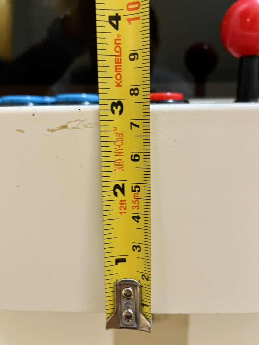

This is an original. Not sure if the reproductions are different.

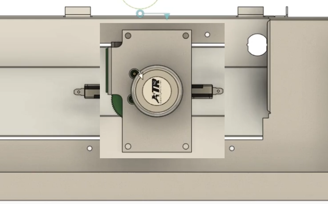

i tested it in my 3d design
it is not about the pcb only
mini cute panel is not PUT and play style you know
you have to slide it which is not easy even with regular joysticks
You will see at the video, which only one way to fit inside ( im not saying %100 , i have to test it at the real world first )
if i move the switch little bit up, maybe it can fit inside
View: https://www.youtube.com/watch?v=u0FV2tISSxM
I will also order two spinners if they fit in Capcom Mini Cute control panel!
@hursit Can you try it in this layout as @twistedsymphony suggested, I think it will fit just fine in this position, even if you move it a little further to the right.
this wont work ( not sure %100 , i will check )
because you have to slide the control panel little bit front first then you will pull back
i will test this one
