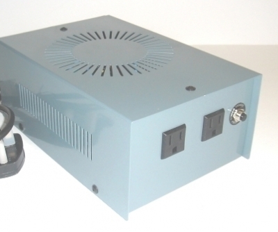

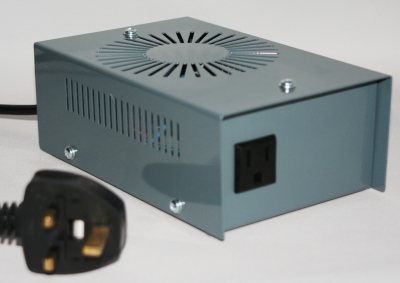

I just received my second cabinet. So now i have a New Astro City and a New Net City now. I have to upgrade/replace my actual converter.
Is it better to buy 2 converter of 500VA : like THIS
or
Just one of 1000VA like THIS
Thanks for your help

Both are perfectly valid options. I'm not sure why you think one option would somehow better than the other. Do you want one power brick or two?

@nem : it s great, thanks for your confirmation. At the end i'll take only one (the 1000VA)
