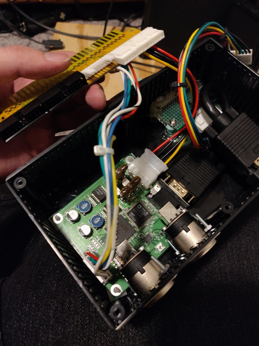

@kuze I'm looking at this image and your headers are on the top of the PB Jamma, but the wires seem to go to the bottom. What's going on here? Just wanna make sure I'm not missing something.
Good eyes! The video and power cables I had (what came with the UVC and a molex power adapter to connect to it) were too thick to crimp inside the molex housing I had on hand, so I ended up just soldering those wires underneath the PB JAMMA. :whistling:
I could have gotten away with smaller wire, but would have had to make alternate wiring for the UVC so I winged it.
The 20-pin connectors/housings for controls and the CPS1 style kick harness didn't have such a problem and can be easily detached for maintenance of course.

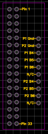

You guys know I love me some PB.JAMMA action! Getting around to designing some daughterboards to unlock the power of the board. Speaking of which, been studying up on how to create my own libraries. Here is a little progress with your request @ekorz:
2.5m spacing throughout! Let me know if I need to invert the CPS1 header.

Question/request for @Lemony Vengeance, is it possible to retrieve the following spacing measurements on the PB.JAMMA? Actually, dimensions for the entire board would help entirely for producing expansion/daughter boards for such projects. But looking for these specifically for now:
  • Spacing between the holes from the CPS1 header and the Video header
    • I think it is the same spacing between the video header->audio header->12vdc header?
  • Spacing between the CPS1 header and the 2p 2x10 header
  • Spacing between the 2p 2x10 header and the 1p 2x10 header
  • Spacking between the 2p 2x10 header and the Home button 4-pin header
@acblunden2 link isn’t working... anyway I’m building the cps1 connector myself so I could do it either way. I’d assume leave it “standard” though, this would just be a cps2 to cps1 converter that you could build yourself so no reason to make it more complicated.
Yeap, no reason to make it more complicated than that.
Possibly, it can be used secondarily to wire buttons 4/5 from the JAMMA harness and button 6 from a Sega I/O to a CPS2 kick harness connector. But don’t think anything special has to be done with the PCB for that, provided its all common ground.
Nice, looks good! Just needs the appropriate traces yeah? I think I need to order a cps1 connector now...

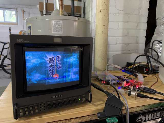

The SDOJ screenshot in the first post looks great, that's at 480p right?
