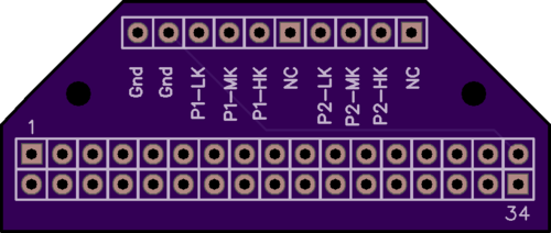

...wanna bang this one out for me with your newfound pcb-layout skillz? 2.54mm for the cps2 kick, but 2.50mm for the jst?

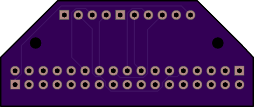

Alrighty. A little rough around the edges (litterally), but this should work just fine. 2.50mm spacing throughout which is what is used for the JST NH connection (CPS1) and Hirose DF1B series. Added two screw hole mounts. Anyone wanna guinnea pig it?
@acblunden2 I just installed some DuPont right angle connectors and hooked up your cps2->cps1 connector. It works! Nice going, and thanks for the design. It’s very compact so it’ll give me some room in this project case when I get to shoving everything in there.
how was the hole spacing? Did you have to get a screw driver to do any squeezing?
