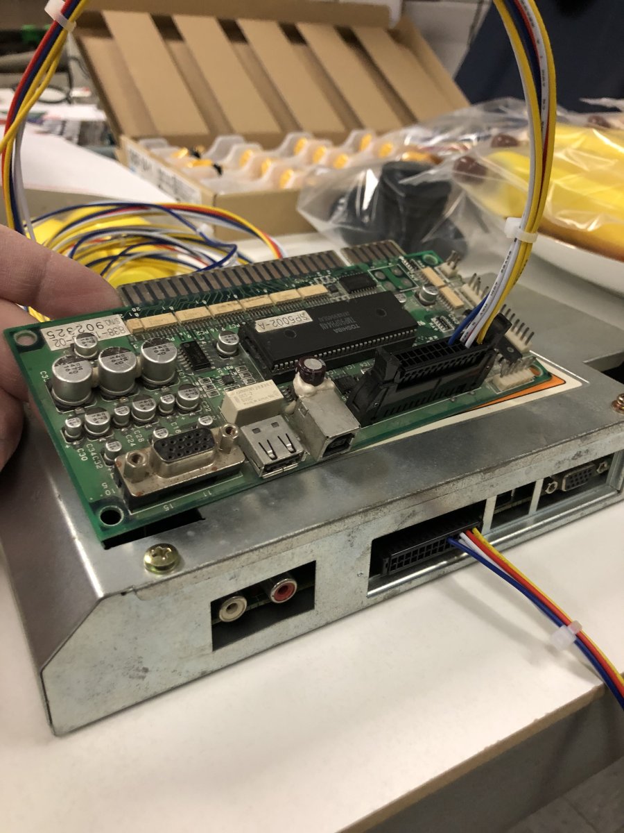

Monkey Ball JVS Harness plugged into a Sega I/O (top) and Capcom I/O (bottom)

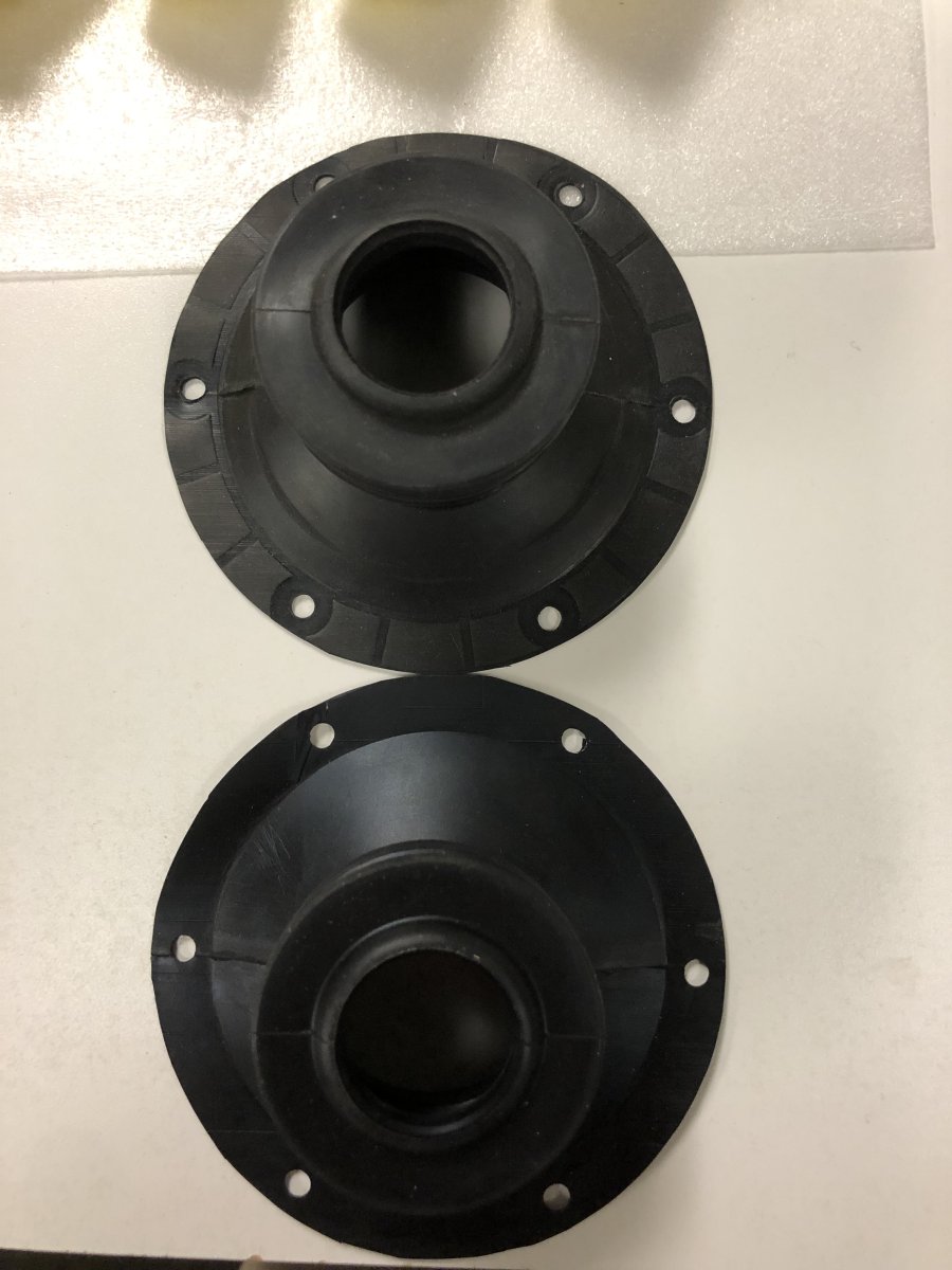

Monkey Ball Gasket comparison:
Used next to New
