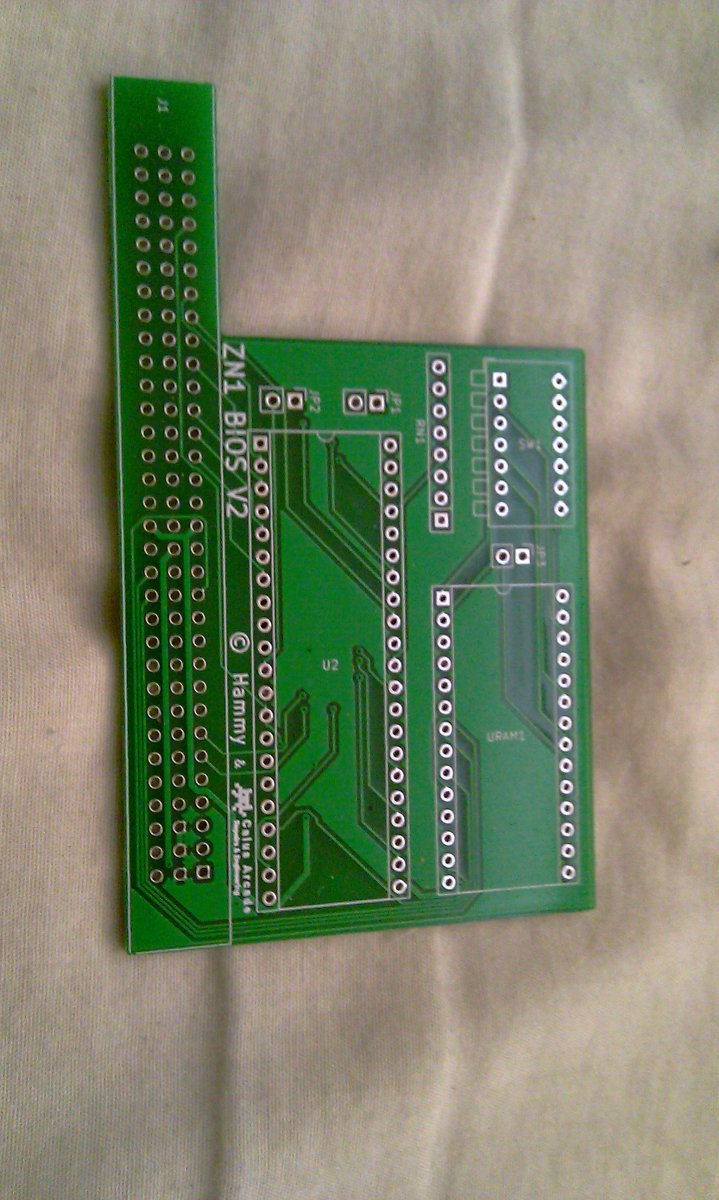

ZN1 Bios <V2> board arrives!
I have said before:
ZN1 with IC 151 and 152 fitted (if missing can be upgraded...)
Is the desired setup. ZN2 should boot on ZN1 but i can't work out what stops the action.

Bios board V2 won't be long, hopefully gets the setup down to 3 wires.
It's come a long way since the 1st 120 (or more) wires psychic force video!
I expect the bios <and bios board> to have many more rev's.
The next hurdle is adding 2 racks (instead of the 8 needed) getting this working with the bank lap loader and giving the next bump in rom space.
After this the final design will begin.
Bios V2 ... :D
256 at the moment, we may go for 1m , chip size bump to 27c322 to fit the acclaim, atlus and atari decrypted bios (along with the tecmo, capcom, raizing and taito from before).
Thanks again to @caius for spinning up the board and helping with this madness!
V1 is still fine, the testers don't need to worry about re-doing the boards, the V1 has it's own pro's over the V2 such as smaller size, no 3.3v to go wrong etc.
