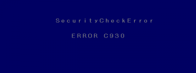

Turns out that one also has "timer protection" and the bootleg will crash after exactly 10 mins, hopefully it's a regular 1f801040 read easy to find and not reading leftover crap like the capcom protections :)
Edit: As suspected a 1f801040 c930 read error.
Now fixed and boss hack done :)
