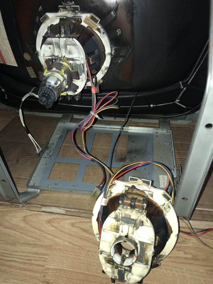

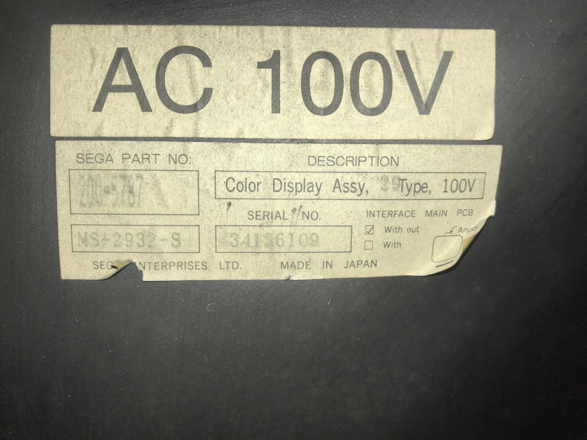

Looking at your spreasheet I can see your readings on a MS-2932 yoke paired with Blast tube (A68KSM696X).
However, I recently adquired a spare A68KJU096X tube paired with the same 31Khz only MS-2932-S chassis:
Some european Naomi universal cabinets use this monitor setup.
Taking a look at the yoke, it is externally similar as a spare MS9-29 yoke I already have:
Then, to ensure if it is the same yoke, my readings of each one are:
ChassisLhLvRhRv
MS-29320.200 mH14.7 mH0.9 Ohm7 Ohm
MS9-290.320 mH14.3 mH1 Ohm6.9 Ohm
Readings are almost the same, except for Lh.
Indeed, looking at the list posted by @'Digital System Design' in Page 2, readings of inductance matches with mines:

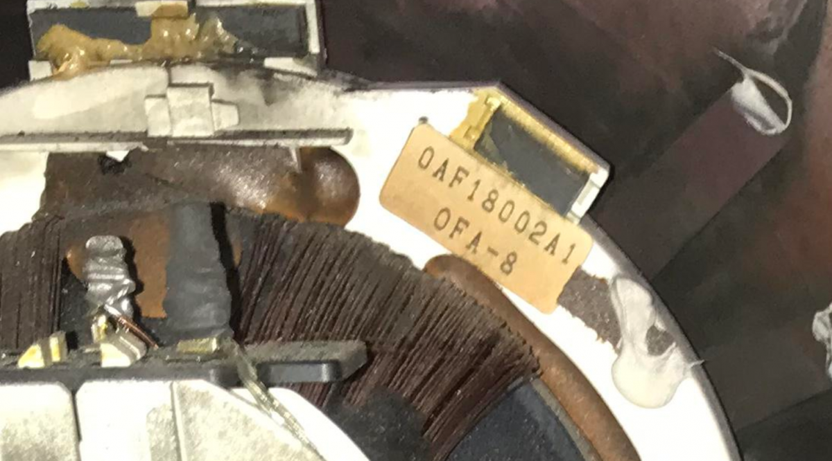

Toshiba curved SF A68KJU96X0AF18002A10.20514.66
Label of the yoke also matches with DY designation in that list:
My question: Is that 0,100 mH difference in horizontal inductance enough to have problems if I use a MS9-29 chassis on it?
or, Do I need to make a yoke swap to ensure it will work propertly with MS9-29?
Yes, you will have problems. Yes, you will have to swap yokes.
