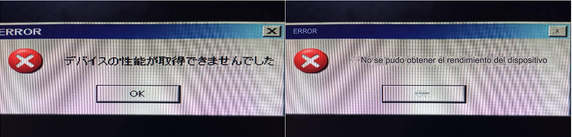

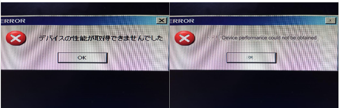

Thanks for the advice after doing the process @rtw I see the error several times:
The com2 error no longer appears but now it appears several times and after entering several times the game starts.

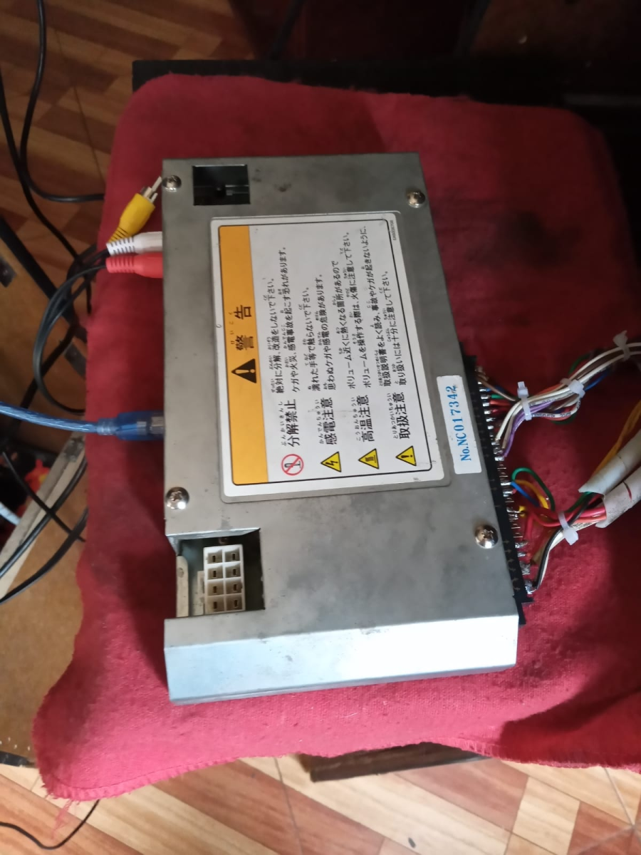

Did you set your CRT to VGA mode? Some monitors can not auto switch between resolutions, so check to see if your CRT has a dip switch. Also, the bottom VGA port will work on a standard resolution display. I've tested a Taito Type X on my Astrocity. Make sure you only plug the vga cable into the VGA port only, to make it boot up in standard resolution. At least that's what I noticed from my experience.
Hello, thanks for your contribution
I already did what you told me but when I connect it directly to the VGA I don't get an image either on the CRT or on the monitor to get an image I have to connect it to the DVI with a pad then it starts if it gives me an image on the VGA

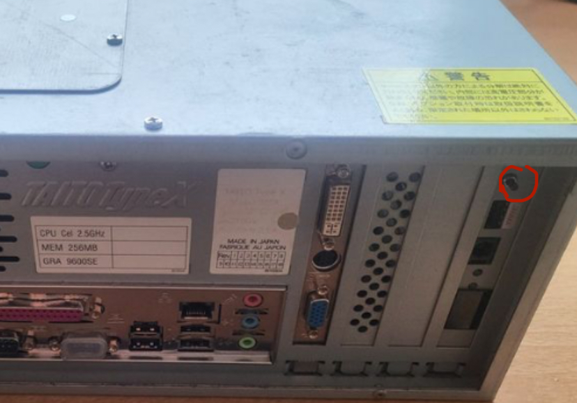

Question after starting a game, how do I return to the main Multi menu?
Update I no longer see errors but now select Kof 98 it starts with errors but it starts the game directly
by pushish the black button from backside of TTX1 unit you will reset the system and you will return in the Multi menu screen ☝🏻 or classical , power off the unit and power on ✌🏻

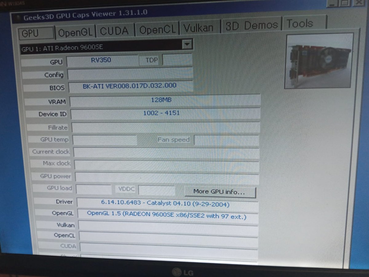

Hi, I watched your video and I am a bit confused. It looks like something is wrong with your graphics card ?
Can you try to start the game "gpu_test" so we can see what kind of graphics adapter you have ?

I added my video configuration but enabled ttxshell_4.7.2 since it did not open with ttxshell_4.8.4
@snake390 thank you for the GPU information, you have the correct GPU.

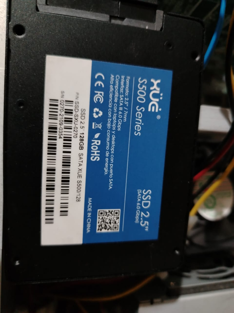

What kind of SATA disk are you using ?

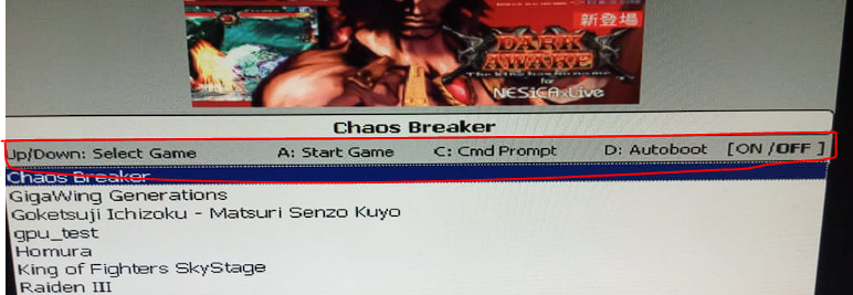

What happens is that when I go to ttxshell 4.8.4, sometimes the menu opens but it only runs kof 98, even if I choose any other game to show you the image of the gpu, I have to go back to ttxshell_4.7.2
I have a 2.5 128 Xue s500 series SSD
Both of those should work with the TTXMulti.
Please try the SEGA one to rule out any issues with the Capcom.
